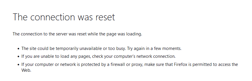

5 minutes ago, Kameleon83 said:
Hello, could you please explain more?
This is what I see when I open the web gui
Try opening in Incognito mode or clear cache etc. set the DNS/DYNDNS and UNRAID_IP variables correctly.
If that dont work try deleting the container and removing the image and reinstall fresh.
Hope that helps.
Cheers!
Hope that helps.
Cheers!
That didn't worl k either. I've tried uninstalling it and reinstalling it. Incognito doesn't work (tried on another computer as well my phone). Tried changing the ports. I ended up setting up a new unraid server and the Docker Web-Gui works fine on that. Is there a config directory that it has?

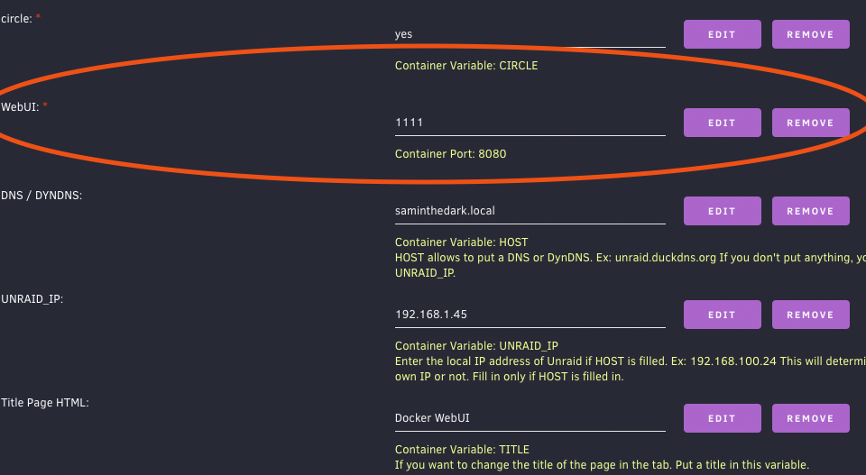

hello i wanted give the container its own ip so i can give it an DNS entry in my Network.
Problem is as soon as i do that the port is changet from 1111 to 8080.
Not that it matters mutch scince i want it to move to port 80 how ever i did not found a way.
i also have no idea about docker i am quit new in that regard.
is ter anyway to modifiy your  container or move the port to port 80

Hello,
You normally have a parameter that allows you to change this.
He wants to know if the container port can be changed from 8080 to instead be 80 so that if it's on it's own IP address he doesn't need to append :8080 to the IP address in order to access it.  IE: it listens on 80 instead of 8080  Is there a config file or something that dictates the internal listening port

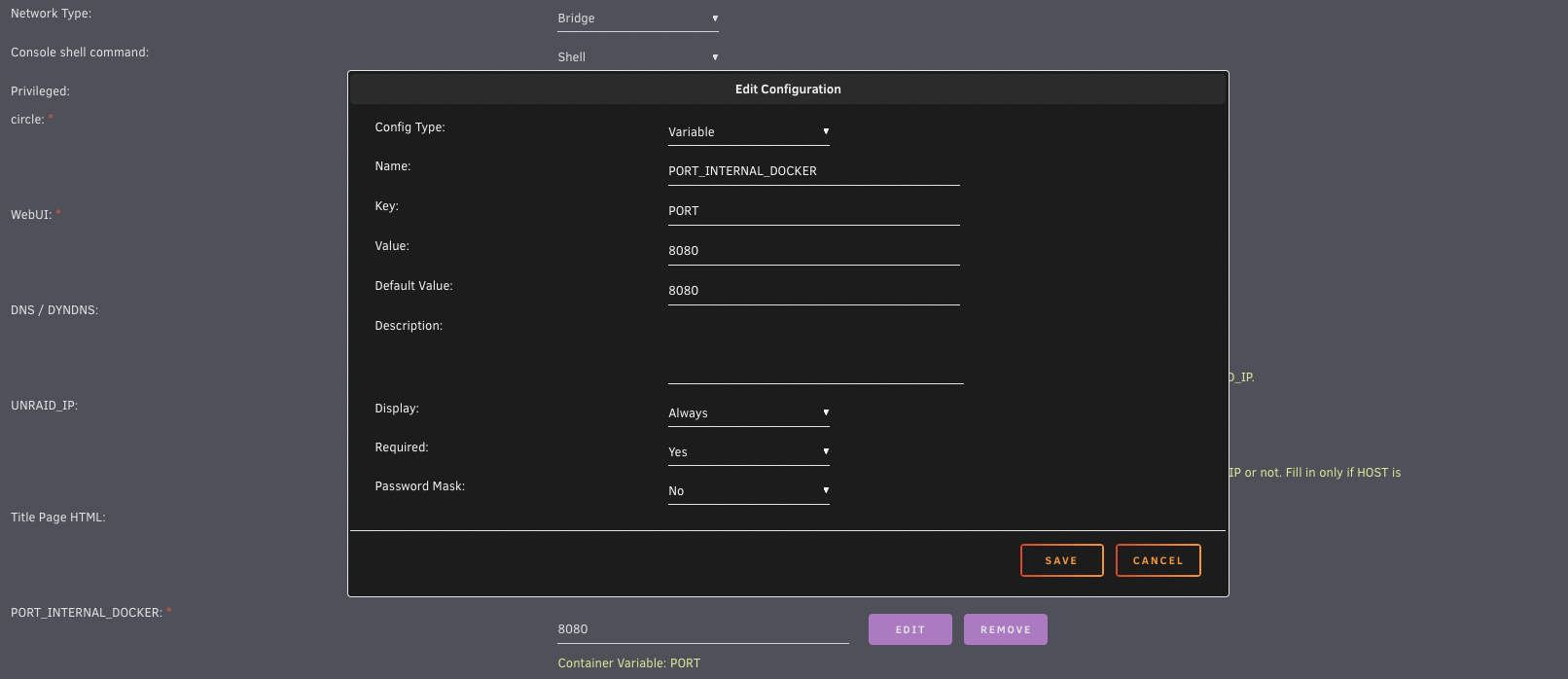

I have added a PORT Variable that allows you to change the port of the application.
Tell me if this works and is it ok?
okay i set it up i only hat to change the port in webUI
