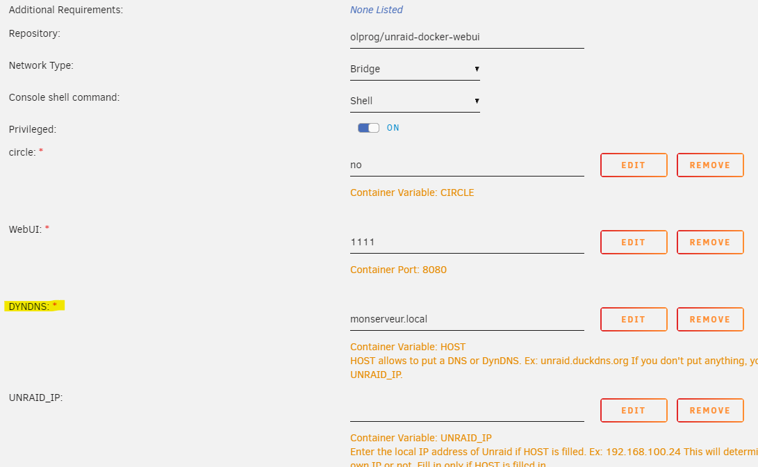

It was working for awhile and now I can't access the web gui. I've uninstalled it and reinstalled it, and put the config files in another folder which didn't help. Tried changing the ports and that didn't help either. Says connection refused on multiple computers. Any idea how to troubleshoot?
This is a rather abstract problem. I am sending you an example of a configuration in pictures.
Do you mind pasting the full data path?
Neverminded I already had mine listed. Yep that's pretty much exactly how mine looks, except it has a different IP. I wish I could give you more information but I'm not sure what I can give. Maybe it's because I used docker build for a few containers?

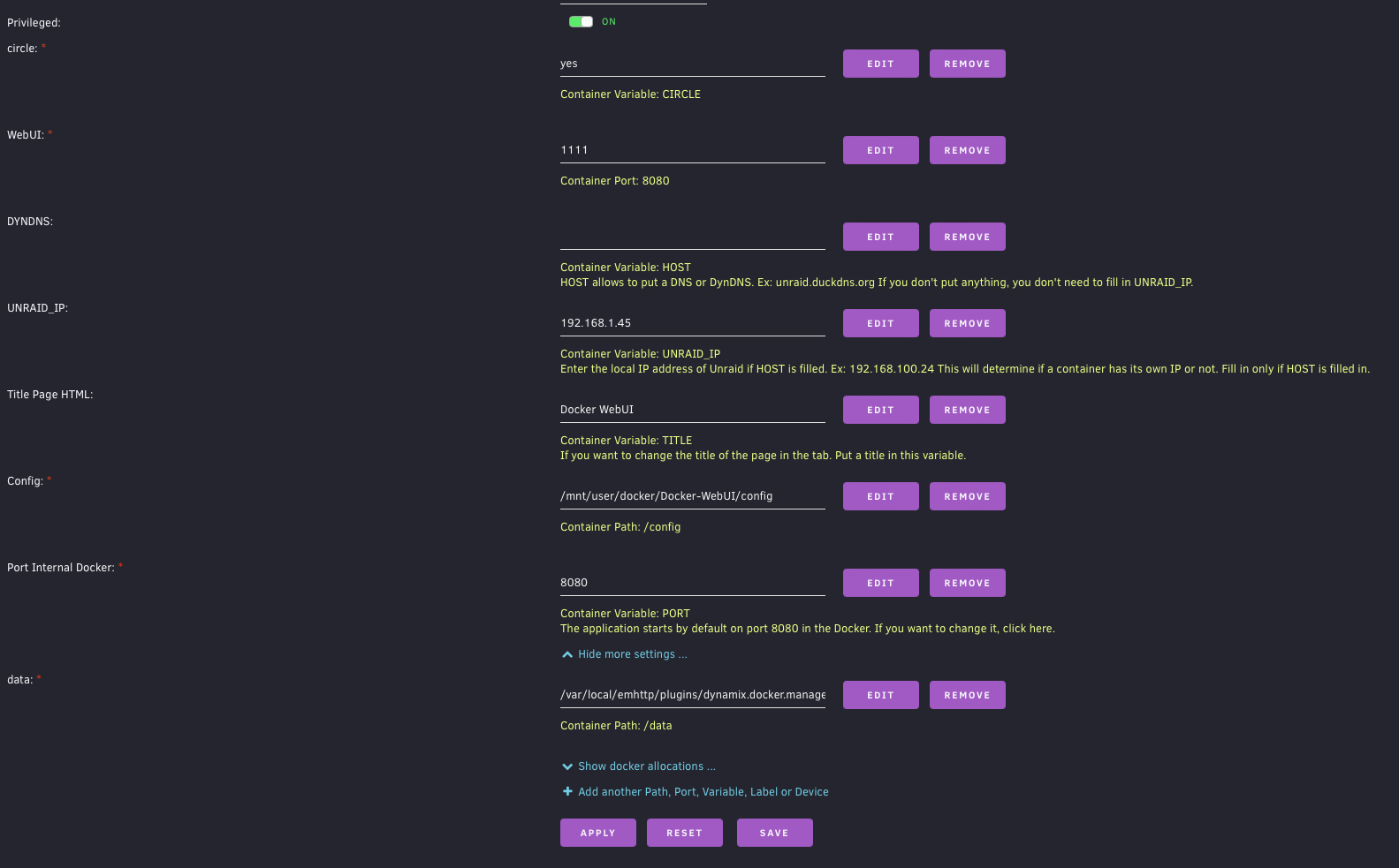

Strangely the DYNDNS variable seems mandatory on my setup (fresh new): :(
This is a mistake on my part. I have just corrected it.
I had to delete and reinstall the container and it works now. Thank you🙏
