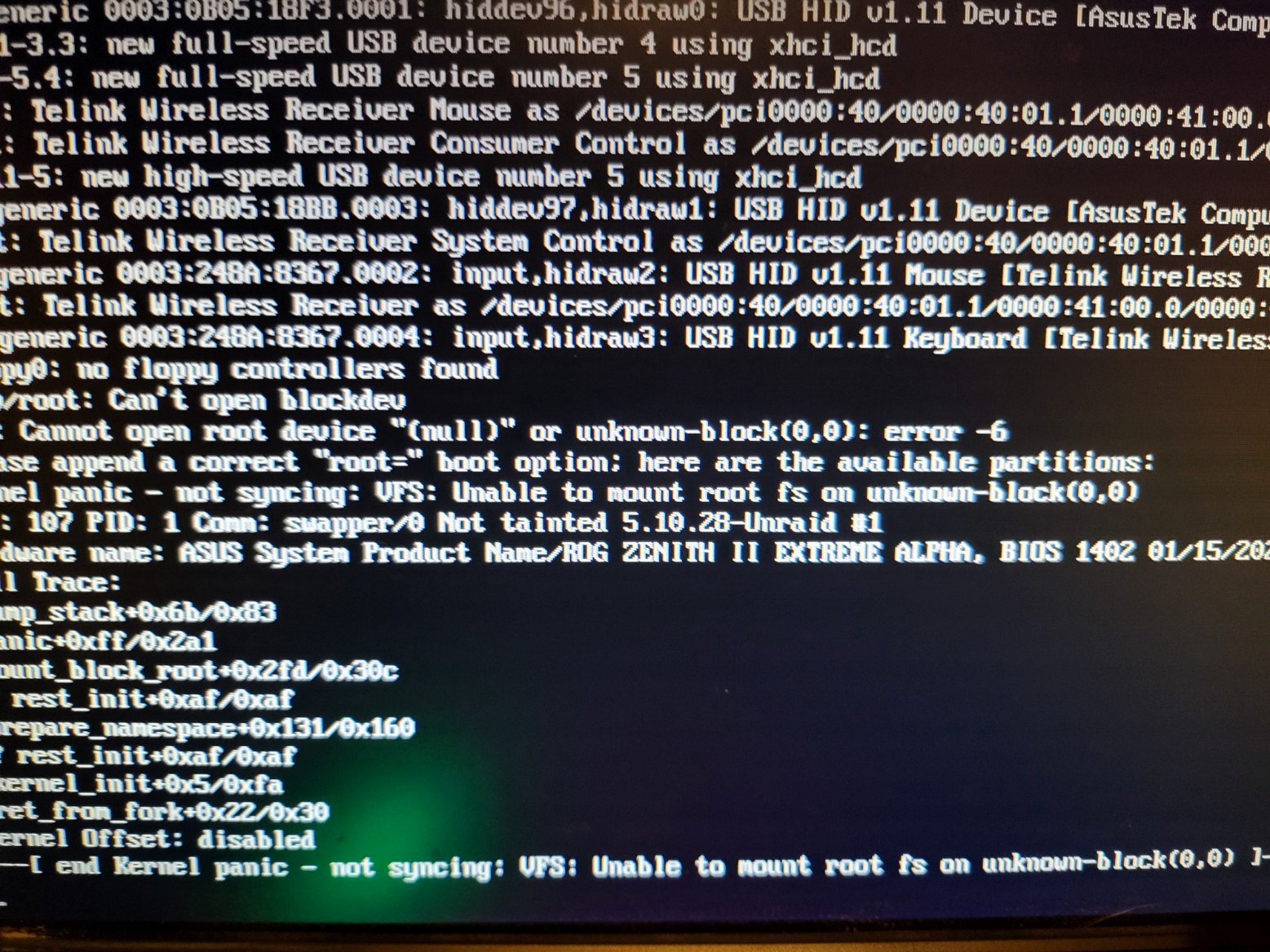

on a different front, It crashed again. So what happends after a crash is I reboot, get a kernel panic, reboot again and it boots up:20210908_084801.thumb.jpg.5c11478a2979d232482b072506a4f74a.jpg
this happens consistently.

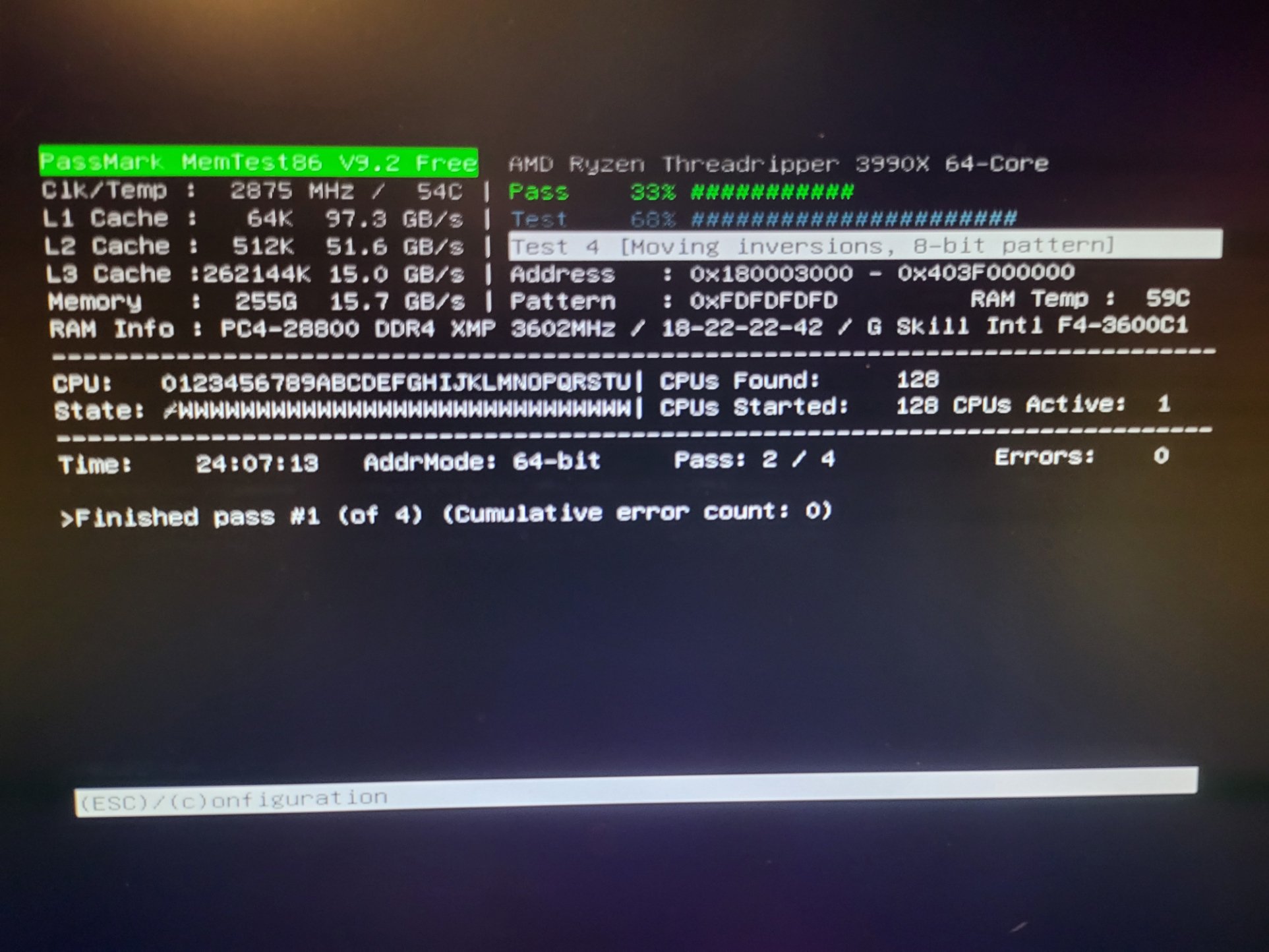

I was still having issues, and am rerunning memtest:20210922_171730.thumb.jpg.b498b4a869aa3fcfa4dcc46874f5e889.jpg
it takes about 24 hours for 1 pass, is it good to go, or do I need to let all the passes complete?
