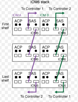

And forgot to mention, I believe connecting one IOM to another is an invalid configuration, the out port is for daisy chainning to another shelf, e.g.:
Yeah, there are many different ways you can configure them. I looked at the photos/configs when I initially got the unit and didn't see anything referencing connecting the two IOM modules on the same shelf together.
