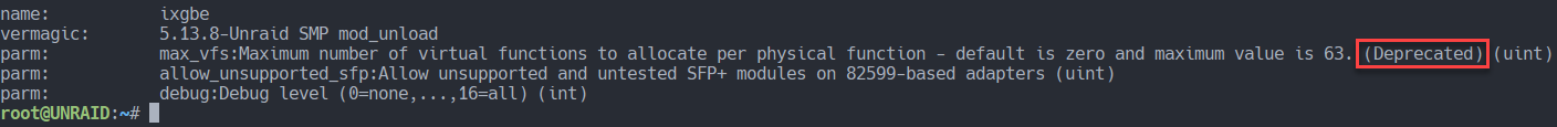

Activation via module parameters (config/modprobe.d) is an option, but all interfaces are of the same type and SR-IOV would be activated for all of them (which in my case means the creation of 256 VFs).
Furthermore, Intel has marked the module parameter as deprecated and will remove it in the long term.
