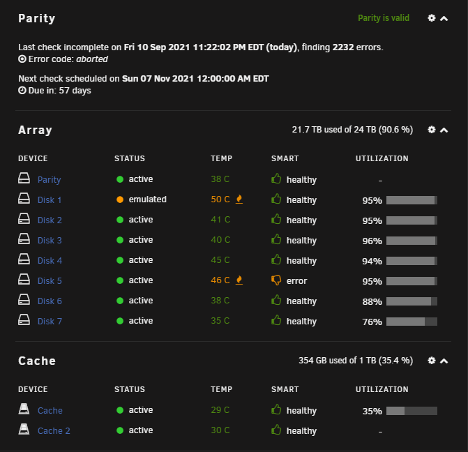

Hello, I'm currently in the process of performing a data rebuild for a new replacement drive (DISK 1). During the rebuild process, I noticed some concerning warning messages complaining about disk sectors appear for a different drive in my array (DISK5).

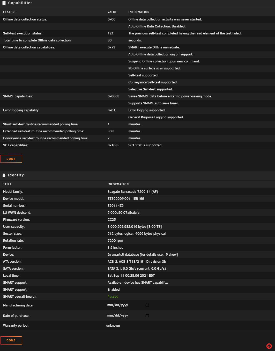

This prompted me to click on the drive in question and I noticed the last smart test for this drive resulted in errors. I became concerned and paused the data rebuild. I looked over the smart report (attached below *information is a little over my head*) and I saw at the very beginning it indicates "SMART overall-health self-assessment test result: PASSED".
I'm now confused because I'm not sure if the drive is failing and needs to be replaced or if it is safe for me to continue rebuilding. The dashboard seems to indicate the disk is not healthy and these are some of the following attributes I noticed (Not sure what they mean):

Dashboard Screen Shot:
More Failing Drive Information (DISK5):
This is basically useless, the important part is the SMART test, which failed, so the disk is failing and needs to be replaced.

Ok so given this current mess what are my best options? Is it safe for me to continue the rebuild for disk1, let that finish, replace failing disk5, and then perform a rebuild again?
I know DISK5 is failing but does that mean the data is corrupt, not sure if it is safe to continue rebuilding or not.
You can let the rebuild finish, there will be some/a lot of corrupt data on the rebuilt disk, but there are not many options, you can then rebuild disk5 but will also result in corrupt data, you can instead use ddrescue on disk5, there will also be corrupt data but at least you can find out which files are affected and need replacing, you can also try that on the old disk1, if not completely dead.
