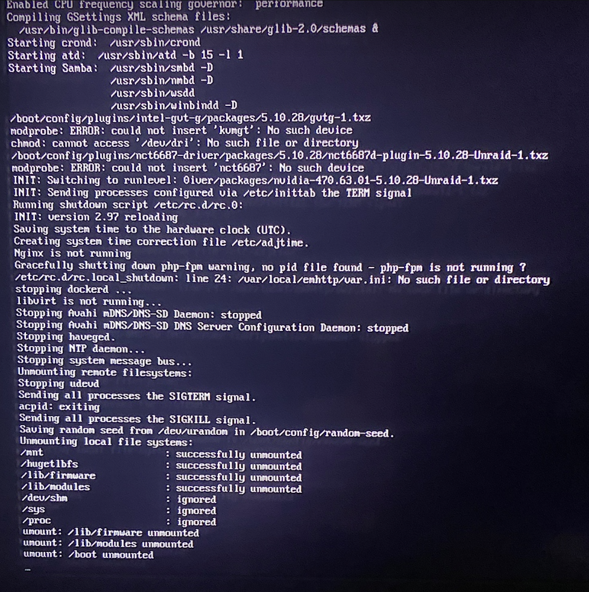

[SOLVED] need Help - normal Start not possible - automatic shutdown
Unfortunately, the system only starts in SAFE MODE. What could I do? Here is the boot screen of the NORMAL START, where the computer automatically shuts down.

Try uninstalling the dynamix.s3.sleep plugin.
thanks for the tip.
Unfortunately, this is not the solution to the problem. The computer shuts down again immediately.

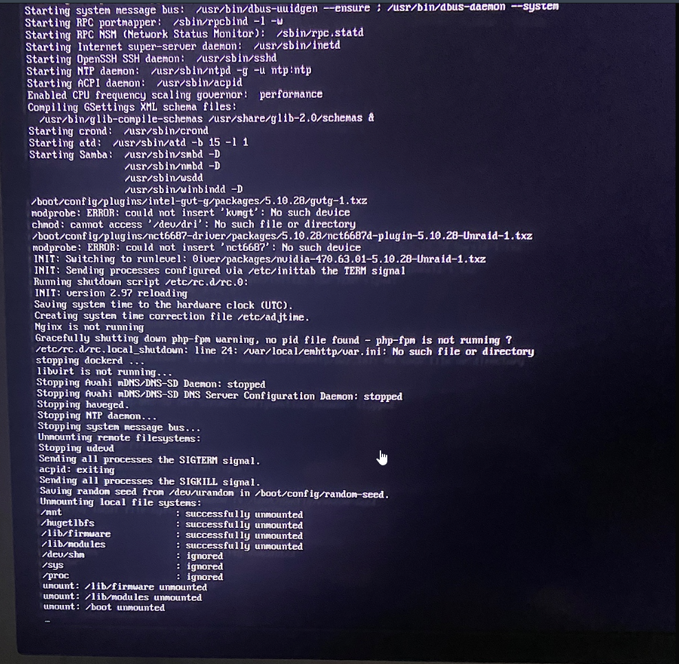

how can I uninstall plugins in SAFE MODE without (plugins)?
I had installed the S3 plugin in safe mode and uninstalled it straight away. Is that correct?
tower-diagnostics-20210911-1204.zip
Edited by Dirk Hill
Diags you posted are after booting in safe mode, not clear the plugin was uninstalled, you can just delete them from the plugins folder in the flash drive.
Thanks for the tip, since the S3 plugin had already been removed, I deleted all the plugins in the folder. Now the system has booted in normal mode again. Thank you very much!
