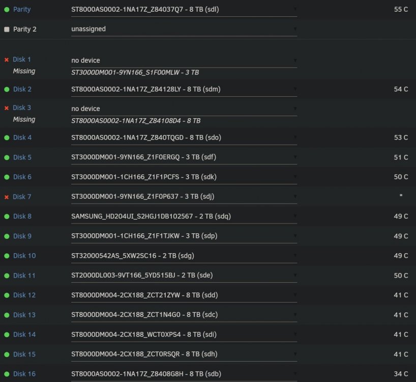

[6.8.3] Disk 7 failed, after reboot disk 1 missing so can't start server
Hello, in need of assistance please.
Attached diagnostics from time of issue before reboot and today.
Had an error pop up saying disk 7 failed.
Saved diagnostic logs and rebooted. Plan was to try a preclear of disk 7 to see if I could reintroduce it again.
Syslog is full of disk 1 errors but can't see anything for disk 7.
Disk 1 then showed missing after reboot and has been missing since so can't start the server or try rebuild either disk.

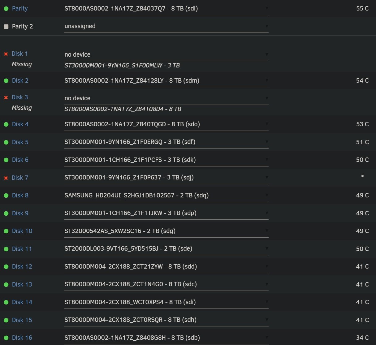

Further reboot showed disk 3 also missing but that's been showing up ok again since that one time.

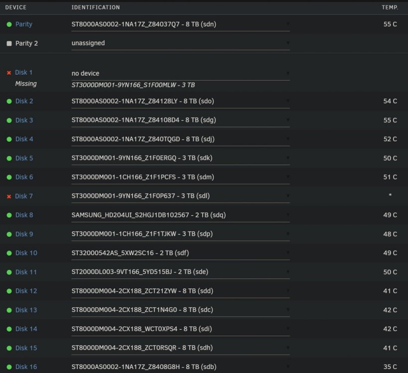

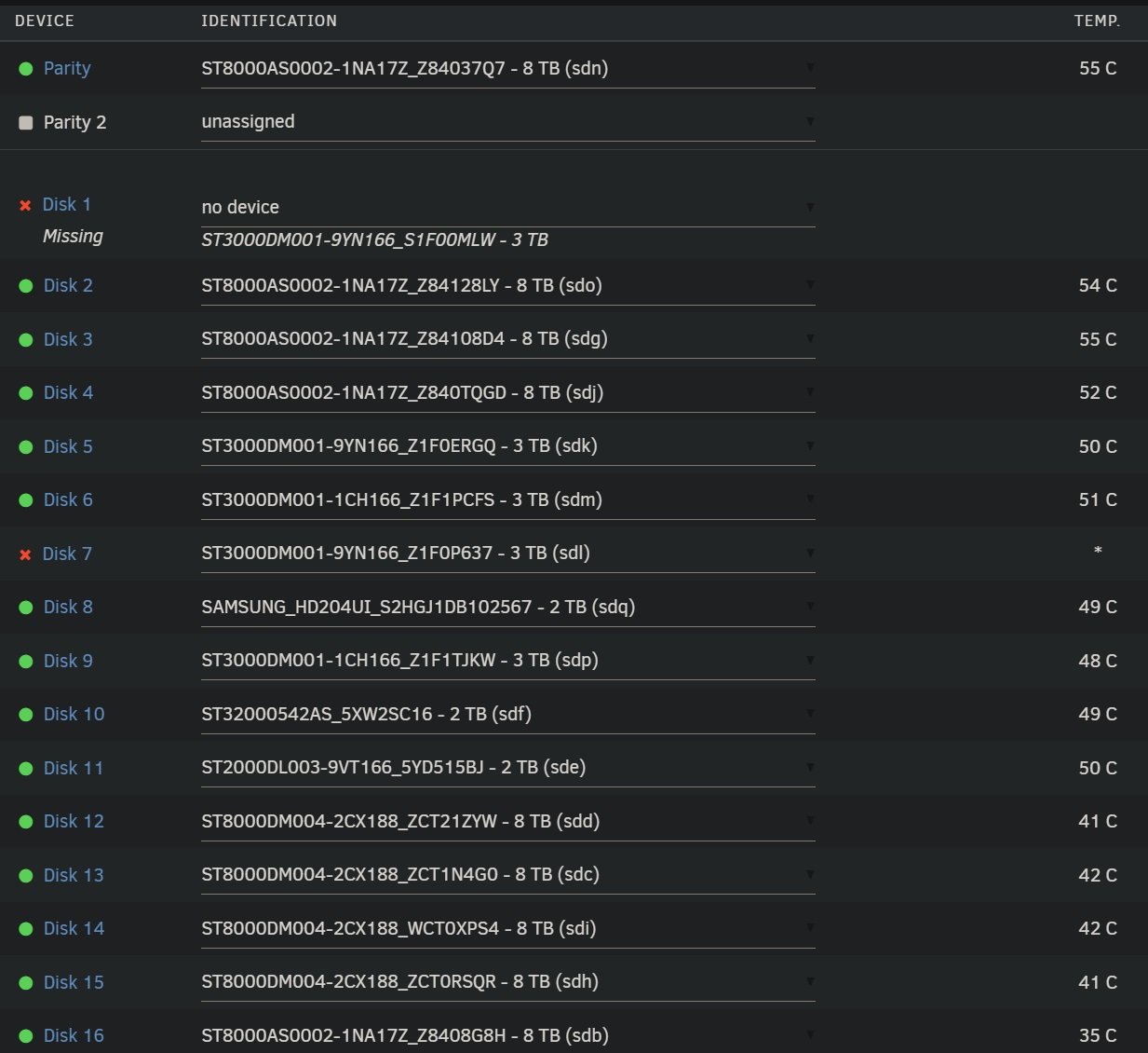

Struggling to get the server to see disk 1. Clicking 'no device' doesn't show any disks in the drop down menu.
Swapped round SATA cables between disk 1 and disk 2 (both go into same 2 port SATA card) but disk 1 still shows missing.
Swapped round SATA cables between disk 1 and parity (parity goes straight into motherboard) and disk 1 still shows missing.
Replaced the 4 port SATA power splitter cable that goes into parity, disk 1, 2 & 3 and disk 1 still shows missing.
Swapped PSU SATA power cable that goes into the 4x SATA splitter with another splitter but disk 1 still missing.
Connected a PSU SATA power cable without a splitter to disk 1 and disk 1 still missing.

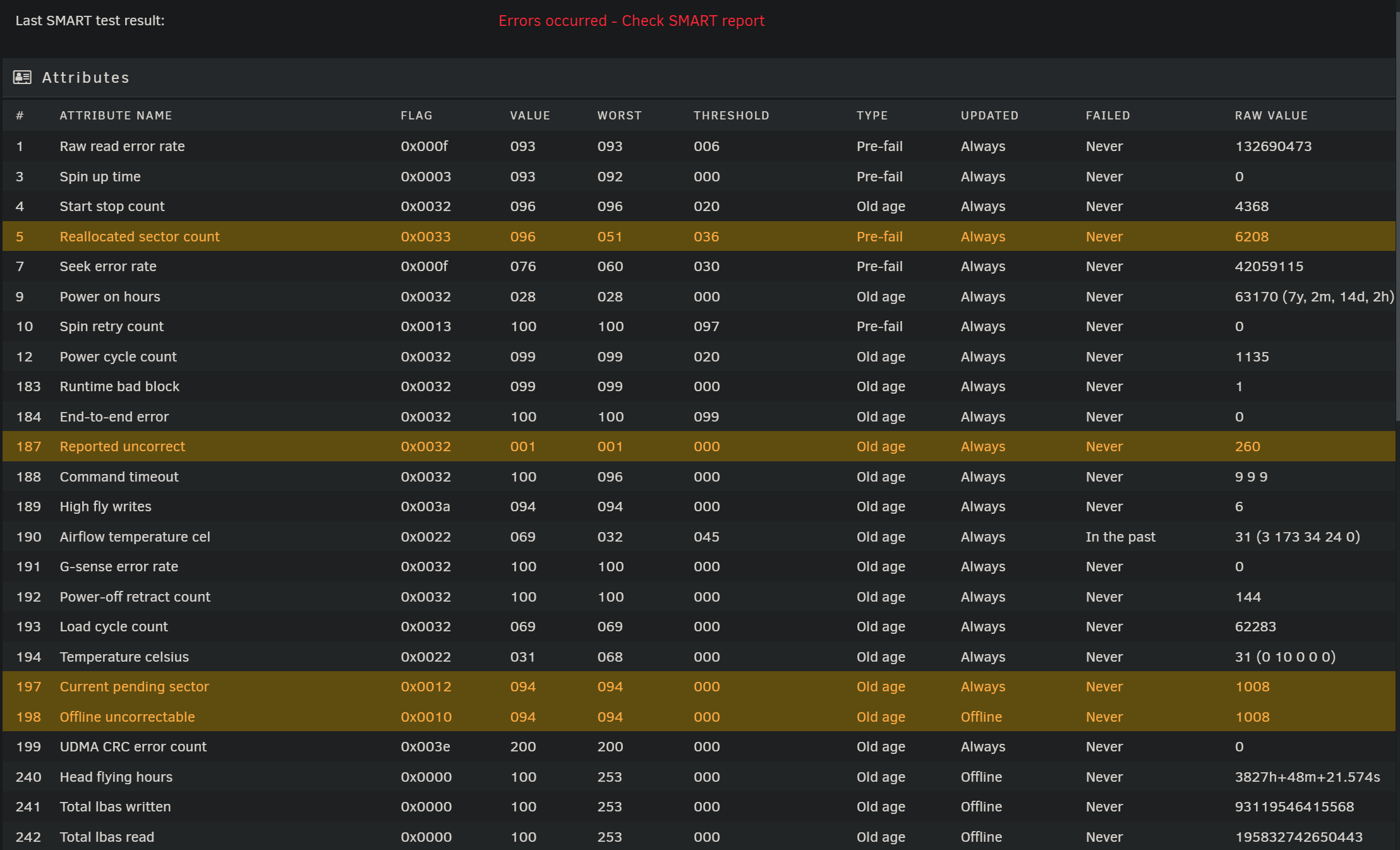

Thanks for the reply. The SMART test fails at 10%. Tried twice. Attached the output.
Short test also won't run and says "Errors occurred - Check SMART report".

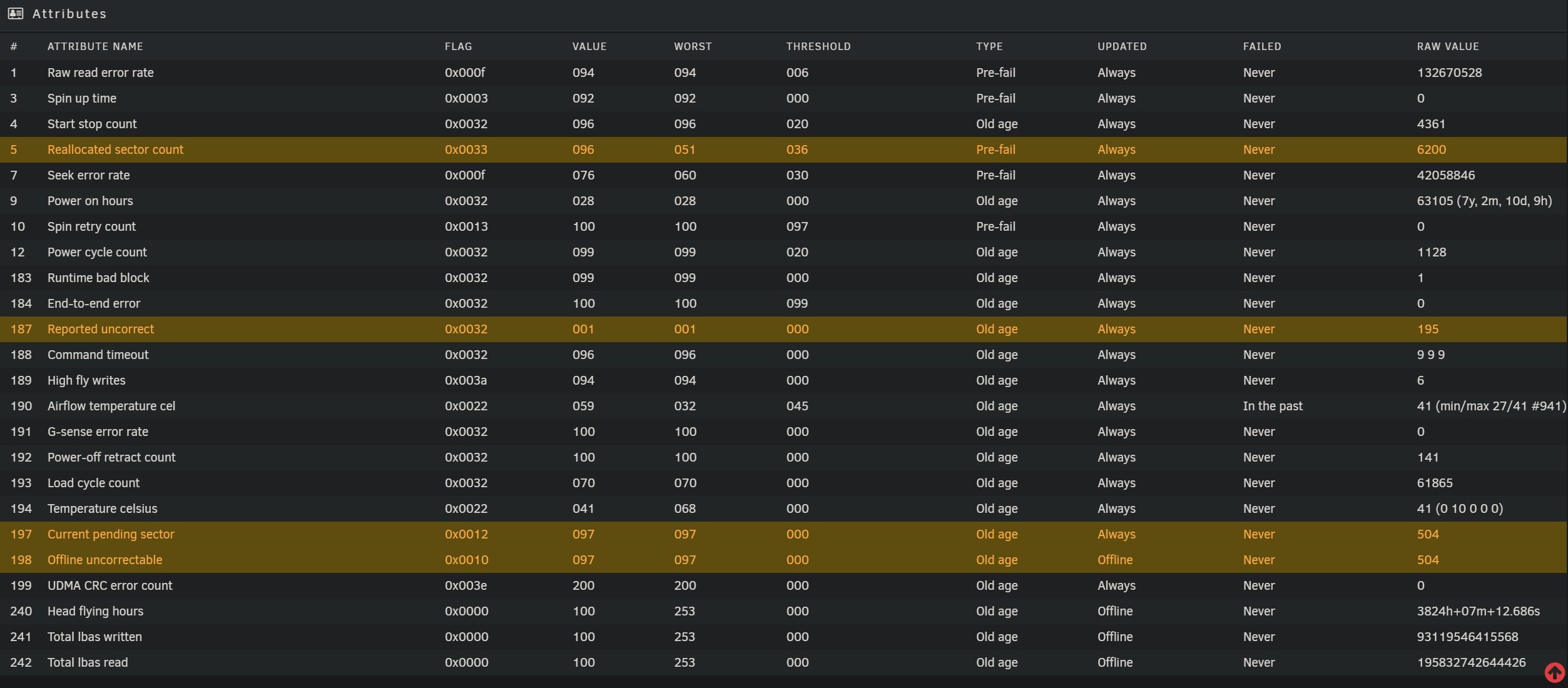

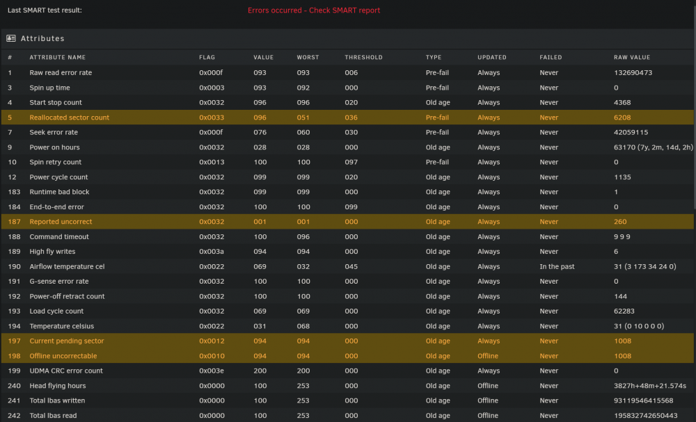

I'm going to try ddrescue on the disk 7 that was previously disabled due to errors. Current SMART report:
It doesn't show a file system and mount is grayed out. When the array is stopped it does show the disk as being available to re-add to the array but I guess that's not a good idea.

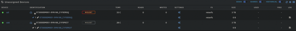

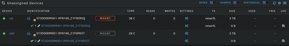

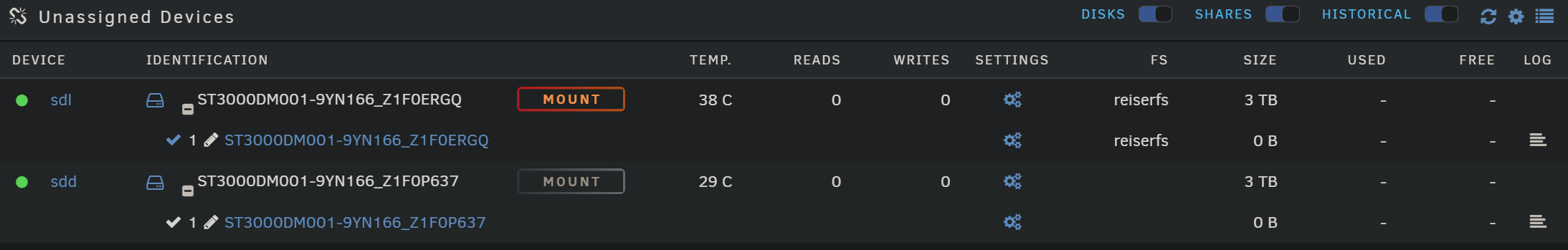

The other unassigned disk sdl is a spare previously used in the array that I rebuilt with a larger disk and still has the data on. What's the best way to try ddrescue of sdd onto sdl please?
Should I preclear sdl and add it to the array to do it that way to save having to copy the recovered data over or better to leave it unassigned without preclearing and copy any data it can recover onto the array manually after?
If leaving unmounted is this definitely the correct command:
ddrescue -f /dev/sdd /dev/sdl /boot/ddrescue.log
Thanks
Edited by mrbens
Yes.

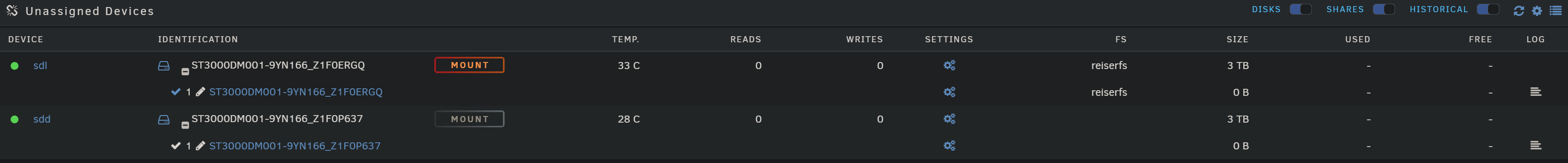

Both disks are still showing under Unassigned Devices.
With the same identifier?

Yes they both show the same device letters. ddrescue is running again and has resumed where it left off.
