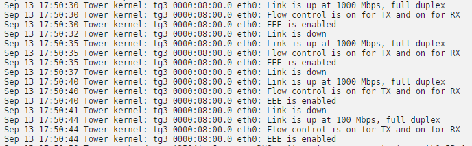

Booting into a Windows PE, or any OS other than unRaid, the ethernet will auto-negotiate 1Gbps. However, in unRaid, the ethernet negotiates 100Mbps after failing negotiating 1Gbps.
The System Log shows this:

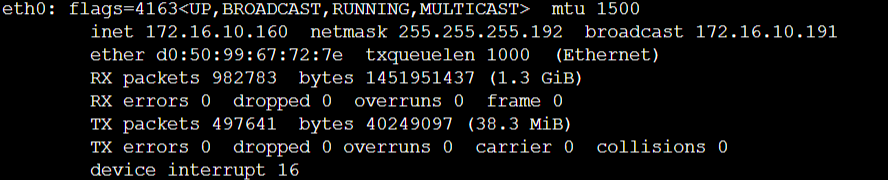

Go to console and type ifconfig and paste a screenshot of the eth0: stats. If it is 100, then you might need to use ehtool to change the settings in Unraid. Reason you get get something different in a linux environment from a windows environment may just be a setting in the linux environment in unraid.

ifconfig dump:

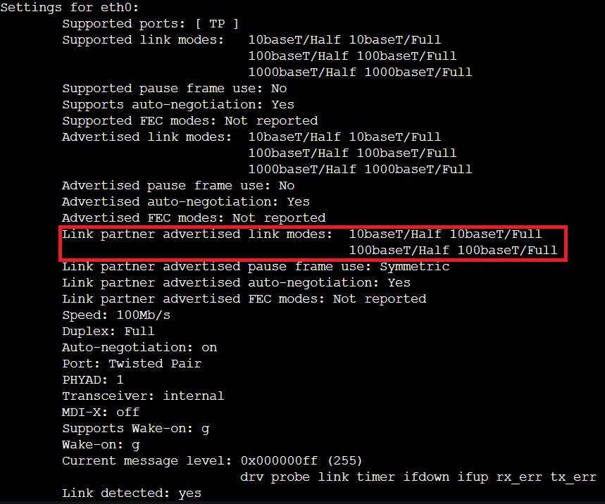

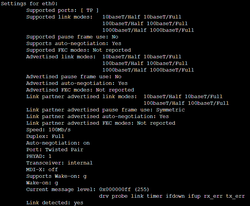

This is the dump i get from ethtool etho0
Manually setting the Link Speed to 1000 caused the link to be dropped.
So I think it's a negotiation issue between unRaid and the NIC on my motherboard, that other OSes don't run into.

Here's your problem:
The partner it is plugged into is saying it only supports 10/100 for some reason. I would double check that it is indeed a gigabit switch, and if it is - I would try a different switch in that position. I'm also working off some assumptions here. It's possible the switch is degrading all links to 10/100 because the upstream link is 10/100, though that isn't common these days.
You've already confirmed the card in the server and the cables aren't the problem - the server negotiates a 10/100/1000 link just fine when connected to a different endpoint, so the suspect is the switch, and that output confirms it. The switch is only advertising 10/100.

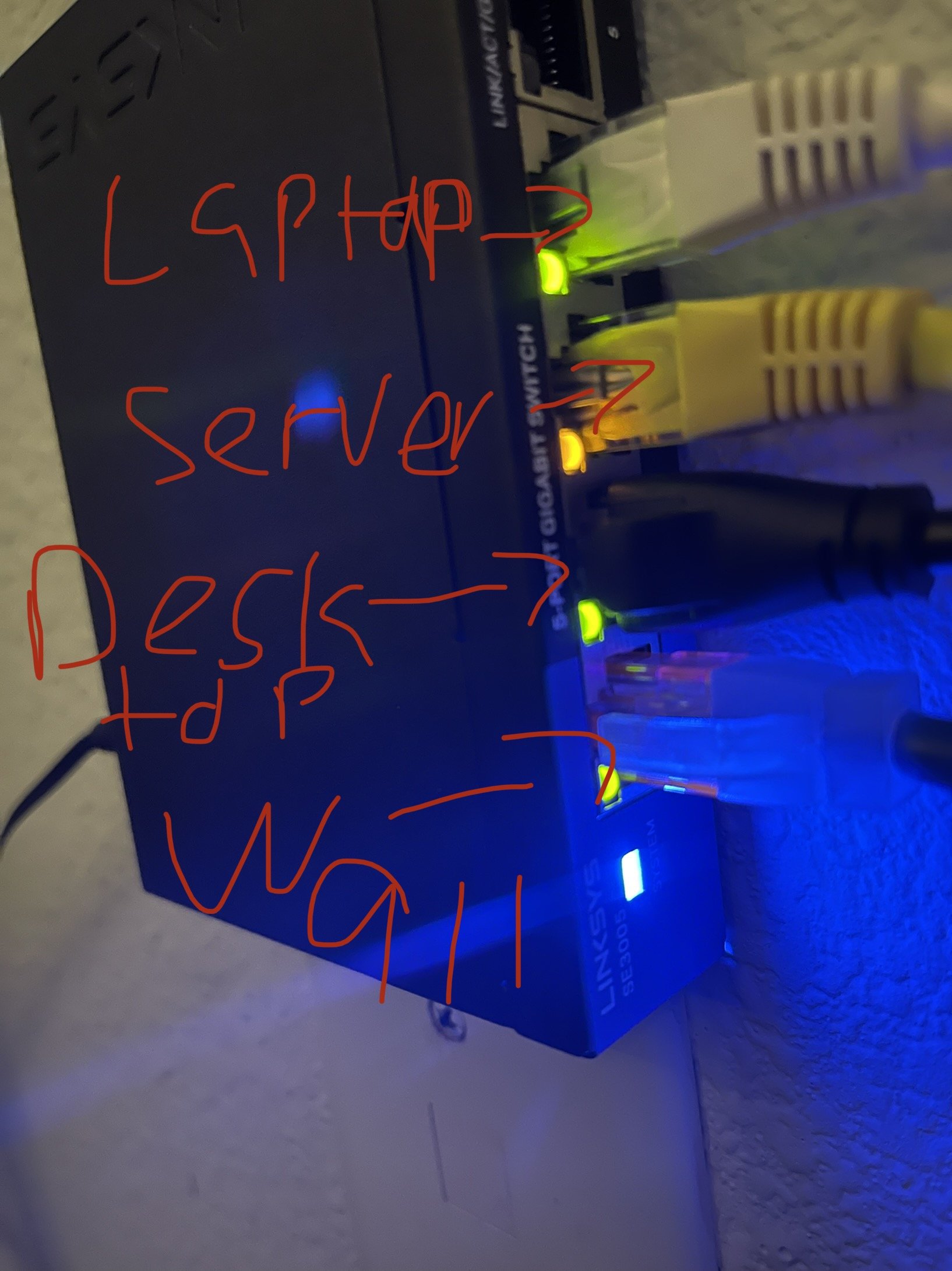

I thought that too, except the switch IS gigabit. I have my server, desktop, and laptop all plugged into the switch and all but the server get gigabit.
This also wouldn't explain the 100Mbps I get if connected directly to the wall that I KNOW is a gigabit connection. (I've tested it on multiple machines and different OSes).
This is my Switch Setup.

Oh, that would definitely indicate that the switch itself is fine.
It looks like something changed between Linux Kernel 4.14 and 4.15 that probably caused an issue with all chips in the TG3 driver:
https://askubuntu.com/questions/1163256/broadcom-bcm5764m-gigabit-ethernet-wont-connect-at-gigabit-speed
That chip is indeed covered by the TG3 driver:
https://linux-hardware.org/index.php?id=pci:14e4-16b1-17aa-3975
And that would line up with your experience of "Works in Windows, but not here."
