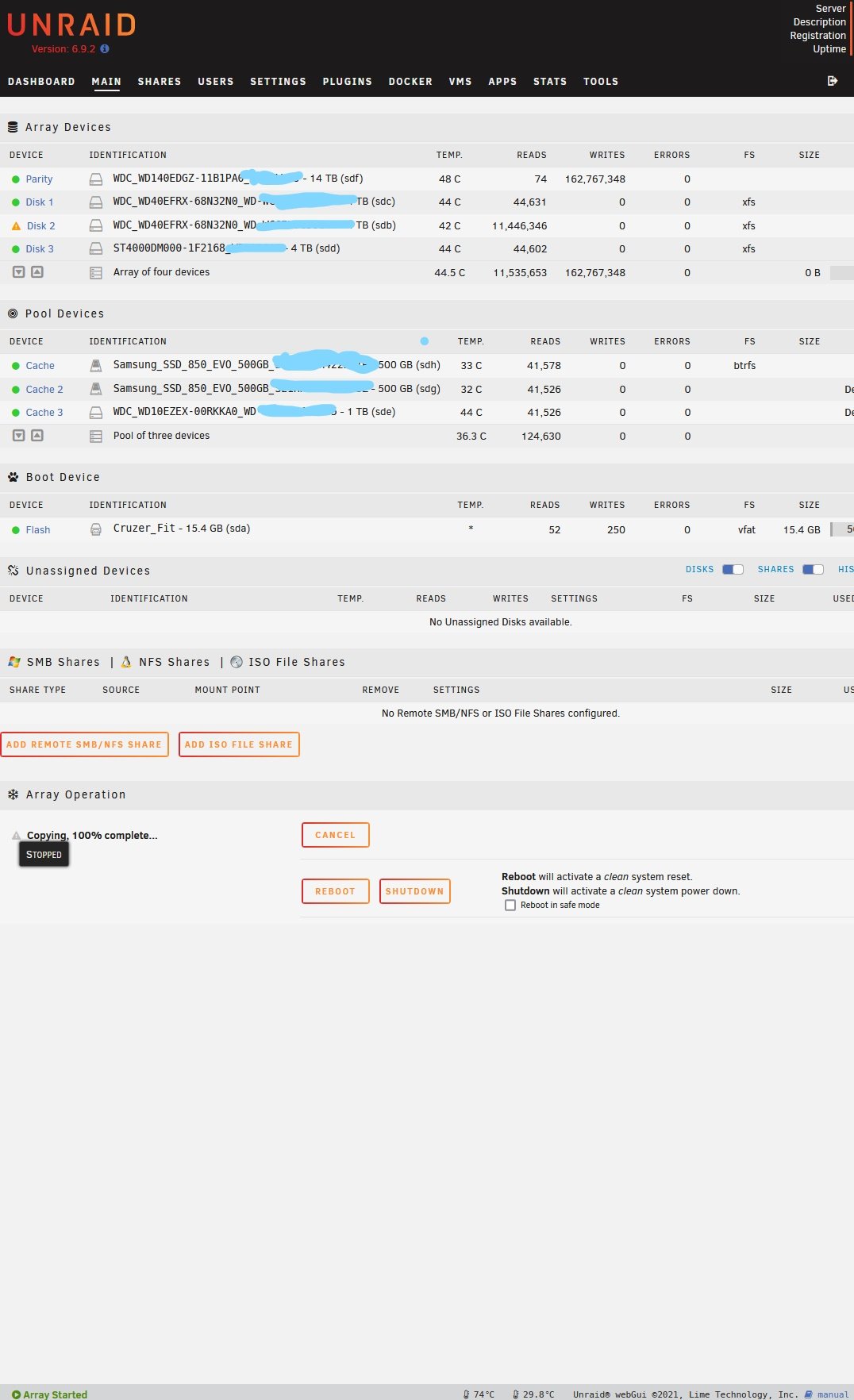

Log at 100% even after increase, post parity upgrade and disk replacement.
I upgraded my parity drive to larger drive while at the same time replacing a failed disk with my old parity drive. It looks the parity has rebuilt correctly, but the system seems to have stalled in rebuilding the failed data drive. Unraid shows the array as started, but the main dashboard and docker show it as stopped. The parity copy action is at 100% completed, but has the warning next to it saying stopped. My cpu is maxing and my log file instantly filled even after increasing it. Attached is my sys log.
Edit: Is it safe to just reboot?

Your log is spammed but it does not seem to have anything to do with your drives. (unless some stuff about drives is hidden between all the call traces)

Looks more like a networking thing.
By network thing, would that be a plugin I might be using, a router setting or a unraid config? Glad to hear it does not look like a disk issue, but it obviously presents a problem. Given the new parity drive seems to be established would it make sense to reboot the box?
Docker containers that are assigned a unique IP instead of sharing Unraid's IP can cause those kinds of call traces.
You should disable Docker in Settings until you get your array stable again.
macvlan call traces has a fix (ipvlan) in 6.10rc1

Immediately after that macvlan call traces began to fill log

I think you have no choice, but disable Docker as I mentioned before rebooting.
Rebooted, looks like I lost the copy progress. I did disable docker all together this time around. I guess move to 6.10.0-rc1 and retry the parity copy process?
