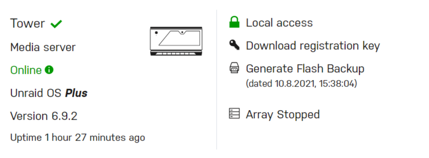

September 15, 20215 yr Hello guys! Could someone please help me? Today, my server didn't work properly. I can't access to the gui. The server was shut down by the sleep plugin last night and should start up by the wake on lan settings this morning. What I am facing now: Browser-Message: ERR_CONNECTION_REFUSED I can see the IP in the Router, but can't access it by typing into Browser I can also Ping the IP correctly Under Network, my old server name "cortex" isn't showing up Under Network there is now "TOWER" showing up but this share is empty http://tower -> ERR_CONNECTION_REFUSED tower seems not to have a new ip (at least i can't see in my router) unraids "my servers": shows server as online (screenshot) -> but can't access: https://tower.local/ -> ERR_CONNECTION_REFUSED also shows "tower" instead of "cortex" No matter how often I reboot, can't access at all Things I already tried: Legacy vs. UEFI -> doesn't change anything Boot order of the flash drive to #1 Reboot many times; reboot router More infos: LAN: two Gigabit connections with bonding enabled for the server access is active IPMI is active and working fine The USB-Drive is USB type 3 - but it worked fine since today (I also do not have a USB 2 port) SSL is active Fritzbox is my router Is there something happened to my flash-drive? Have no clue what happened overnight ... Help is very appreciated! Edited September 16, 20215 yr by Mor9oth

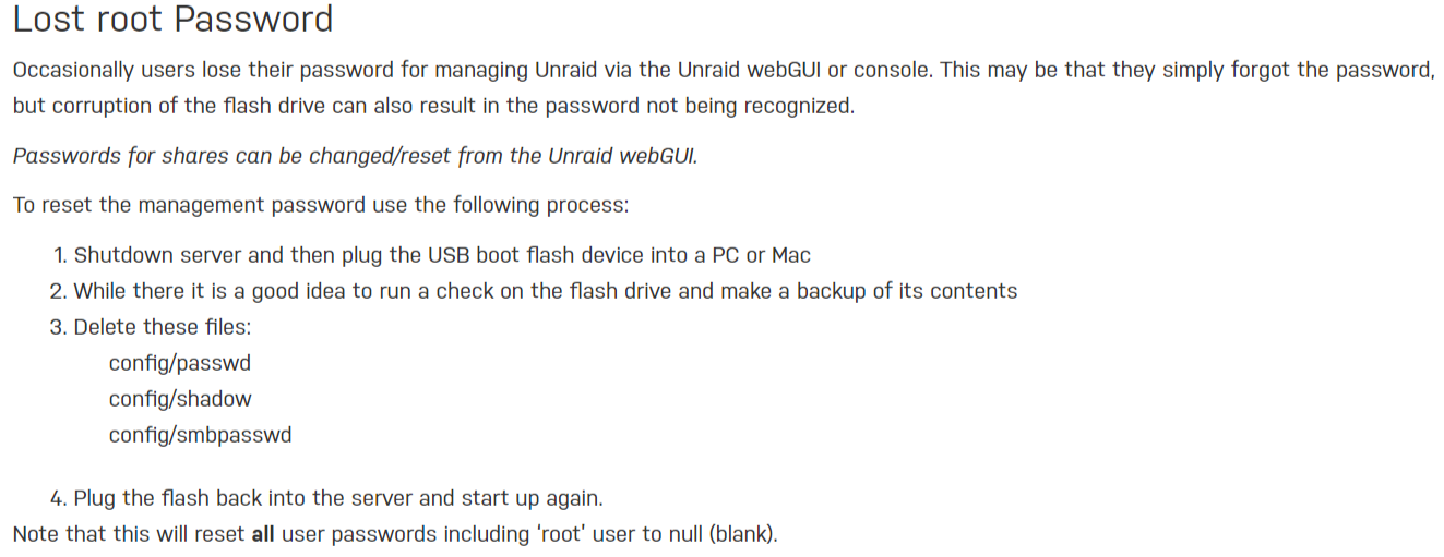

September 15, 20215 yr Author Does anyone have an Idea how to fix it? I followed the wiki for "Lost root Password" to reset the root password (Screenshot), but it isn't possible not to enter a password. Leaving it blank causes in messages like "please fill in". Entering anything still causes these warnings (see above).
September 16, 20215 yr Author 2 hours ago, trurl said: Root password mandatory starting with 6.10 What does that mean for my situation? Leaving it blank doesnt work. „password“ „Password“ or what ever I type doesnt give me access. So there is an password required. But which? I erased the passwd file and thought this would reset the root password to none (blank).
September 16, 20215 yr Author 2 hours ago, trurl said: Root password mandatory starting with 6.10 I am running 6.9.2 btw
