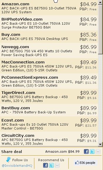

A APC Smart-Ups 750 for $100 would likely work for enough time to shutdown. You could always test it and the return it for an upgrade if it doesn't work.
I'm not seeing a "Smart-Ups 750" for $100... Google Shopping has an average price between $250-300
