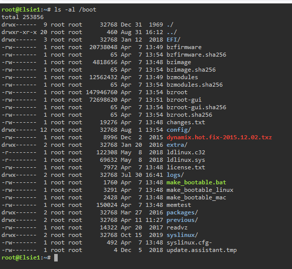

Open a terminal session and look at your flash drive.  You do this with the following command:
ls -al /boot
IF you look, you should see that the owner of everything on the boot drive is now   root   and the owner is the only one who has read/write permission.   Furthermore, root is not allowed as a SMB user.  ( root is not allow to be a samba user in Unraid.)  You can see this by looking at the following file:
cat /etc/samba/smb.conf

3 minutes ago, itimpi said:
I never have any problems accessing the contents of the flash drive over the network so there has to be some other factor at play.
Are you seeing this:
I seem to recall reading the LimeTech was restricting access to the Flash Drive for security reasons.  (This is screen shot of the file listing of the boot drive using version 6.9.2.)
Obviously when accessing over the network via a SMB share I do not see the owner/permissions but I do see all the files and have read/write access.   This is probably because being FAT32 there is not full support for linux permissions.
the big security change was to stop any file on the flash drive being allowed to have ‘execute’ permission.   The other change was that the flash drive no longer defaults to being shared on the network.
@itimpi, You are correct.  I just checked on my Flash Drive Share settings.   It is set to 'Private' and I have set the login for my Samba User to have 'Read Only' access.  Thinking about it now, I can remember thinking that have 'Read-Write' access to the Flash Drive did not seem like a good idea when looking at it from a security stand point.   Very seldom have I ever required write access to the Flash Drive via Windows Explorer.  (In fact, as I now recall, I only set up the read access because of occasionally needing to be able to look at the Flash Drive and its contents while helping out other folks on the Forum!)
