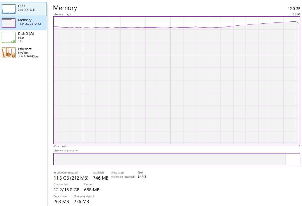

September 17, 20215 yr I installed the balloon and other virtio drivers but it seems like something may be wrong because this is what I see in the system: Almost nothing is running so it's almost as if it's inverted? Is this just normal with Windows 10 VMs or did I miss something? Edited September 17, 20215 yr by Econaut
September 17, 20215 yr Author Oh, interesting - they were not. That fixed it but in so doing, does that mean the VM always has 12G memory allocated to it when running (and UNRAID has 12G less memory usable? Edited September 17, 20215 yr by Econaut
September 17, 20215 yr 2 hours ago, Econaut said: the VM always has 12G memory allocated to it when running (and UNRAID has 12G less memory usable? This. KVM ballooning doesn't work the way you think it should.
September 18, 20215 yr Author 16 hours ago, JonathanM said: This. KVM ballooning doesn't work the way you think it should. Fair enough - does that mean that if I revert the settings and just ignore the guest VM memory allocation, I can leave UNRAID with more free memory or does it not work that way either?
