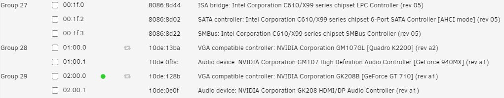

you can check within unraid what components the gpu has, for example in the screen when you attach to vfio the devices.
Image from internet
Here you can see 2 nvidia gpus, let's take into account that in iommu group 28, with 2 components: 10de:13ba, which is the video component, and 10de:0fbc, which is the audio component.
In this case the gpu has 2 components, audio and video, other gpus may have usb controllers too.
