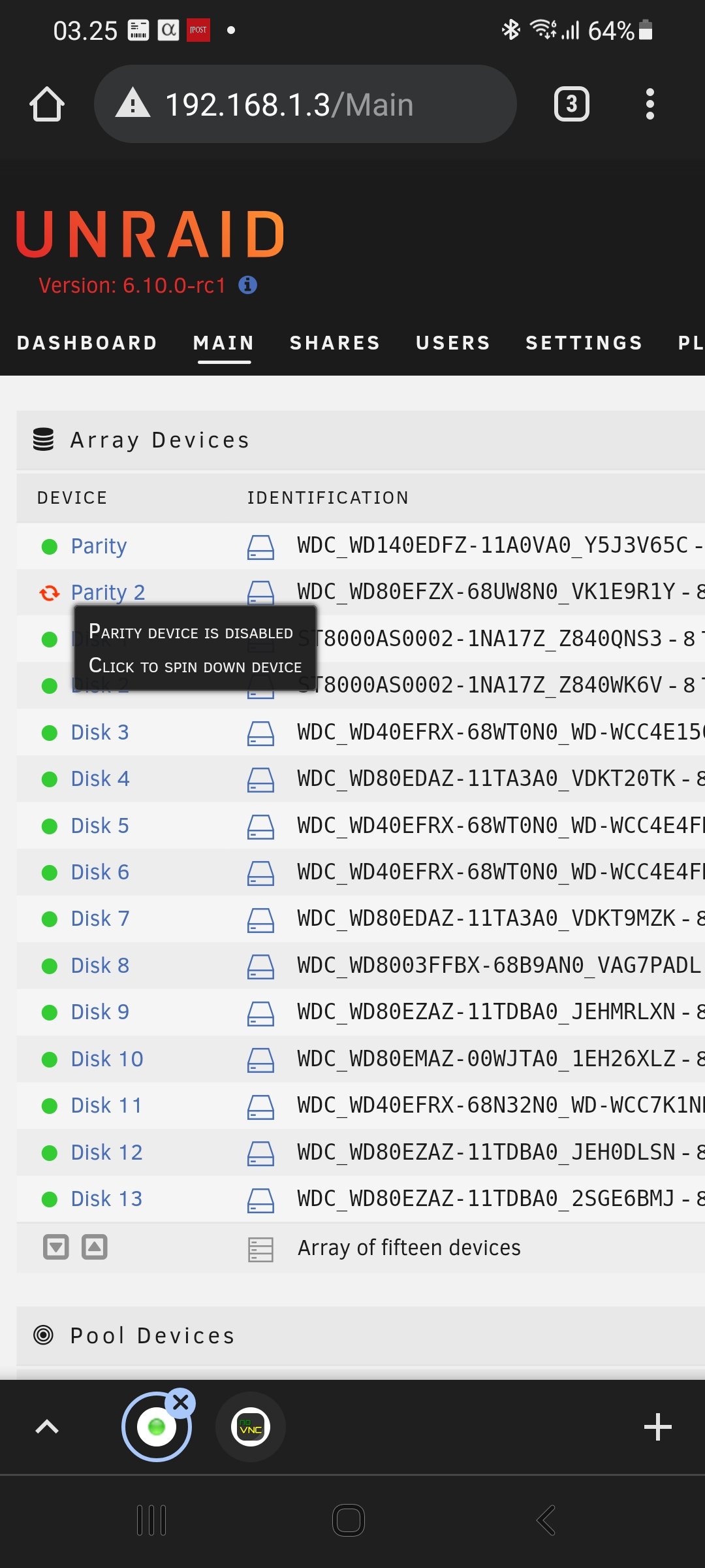

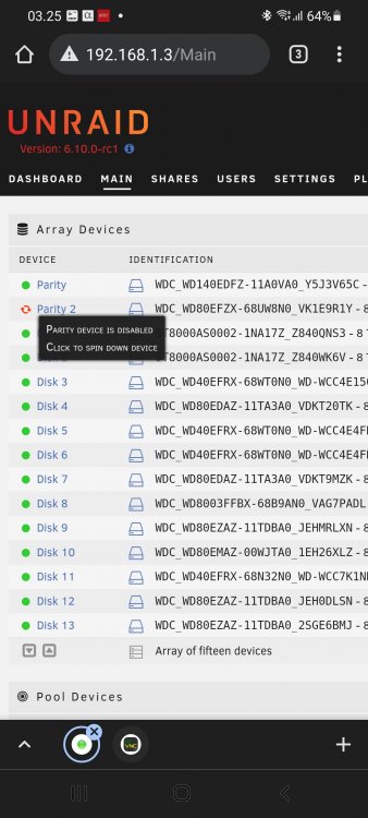

September 18, 20215 yr Hi have a disk there show too be disabled by the arry what the best way too say all good . If I unmound it and mound it I need too do a fuld sync wish I don't like. So what the way too do that right if you KNOW it ok tower-diagnostics-20210918-0957.zip Edited September 18, 20215 yr by tola5
September 18, 20215 yr Your diagnostics could show what happened. If the drive is OK, you will have to rebuild as parity2 is most probably not in sync anymore.
September 18, 20215 yr Author 2 hours ago, ChatNoir said: Your diagnostics could show what happened. If the drive is OK, you will have to rebuild as parity2 is most probably not in sync anymore. Have add a diagnostics after a reboot disk say the same
September 18, 20215 yr Community Expert You are having issues with multiple disks: Sep 18 00:53:05 Tower kernel: sd 10:0:2:0: Power-on or device reset occurred Sep 18 00:53:05 Tower kernel: sd 10:0:8:0: Power-on or device reset occurred Sep 18 00:53:08 Tower kernel: sd 10:0:2:0: Power-on or device reset occurred Sep 18 00:53:08 Tower kernel: sd 10:0:8:0: Power-on or device reset occurred Sep 18 00:53:08 Tower kernel: sd 10:0:16:0: Power-on or device reset occurred This is usually a connection/power problem.
September 18, 20215 yr Author 24 minutes ago, JorgeB said: You are having issues with multiple disks: Sep 18 00:53:05 Tower kernel: sd 10:0:2:0: Power-on or device reset occurred Sep 18 00:53:05 Tower kernel: sd 10:0:8:0: Power-on or device reset occurred Sep 18 00:53:08 Tower kernel: sd 10:0:2:0: Power-on or device reset occurred Sep 18 00:53:08 Tower kernel: sd 10:0:8:0: Power-on or device reset occurred Sep 18 00:53:08 Tower kernel: sd 10:0:16:0: Power-on or device reset occurred This is usually a connection/power problem. But when the disk use a backplate with 4 disk it sound wird it not all 4 or do I miss something
September 18, 20215 yr Community Expert Could be a backplane problem, or cable, or power, you can also update the LSI firmware.
