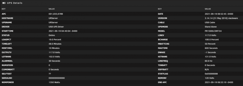

My PR1500LCDRT2U communicates fine and shuts down the VMs and the server itself properly

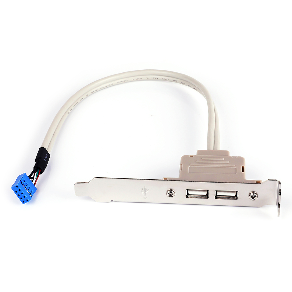

Do you have any USB 2.0 ports internally on the motherboard? If so, get one of these.
Yes I do have one USB2 header on MB. Unfortunately it's already in use to power my front of case USB ports which are USB2 only.  I guess I can try running a cable all the way around to the front of the case - janky.
