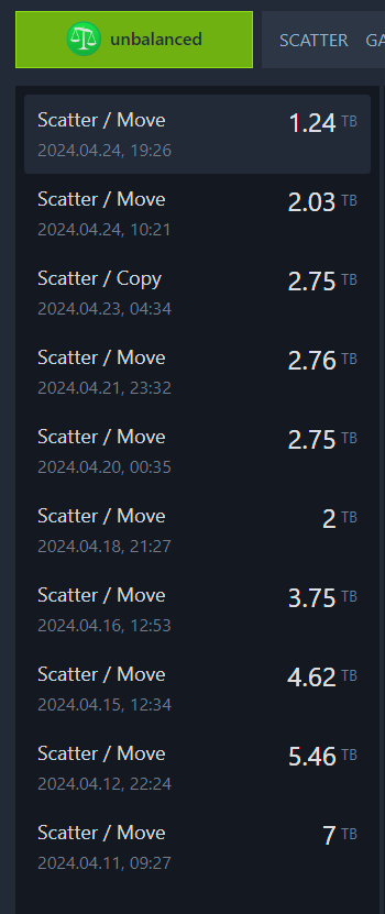

Finally all done. Left most of the docker apps running except for the ones that wrote to the disk, VM (HA) was never stopped. Used unbalanced to move.
Took forever - started with the largest disk and worked my way down. Largest disk with 7TB of data to move took ~42hrs and the smallest with 1.2TB of data took 8 hrs.
All disks are xfs now.
Nice, glad it worked out for you!
