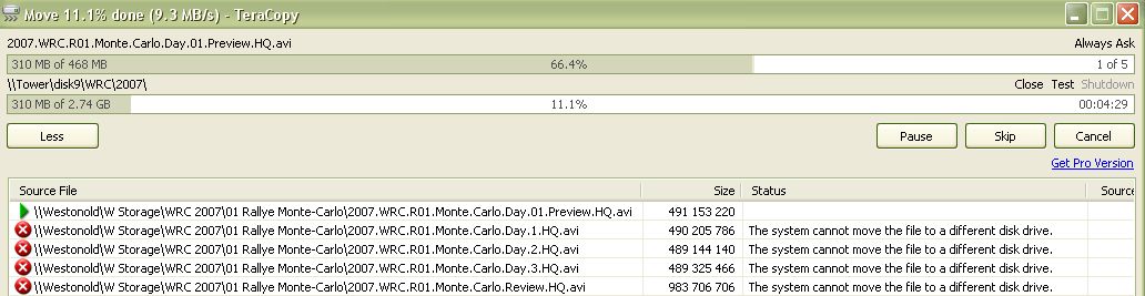

Here's a try writing directly to the same disk (#9) as the WRC share was writing to:
Same result when writing from this machine to the server. The above test went through another gigabit switch, then through the switch on the desk next to me where the link light still displays 100MB/s.
The error is odd, no? All five files transferred just fine, despite the errors in the image.
