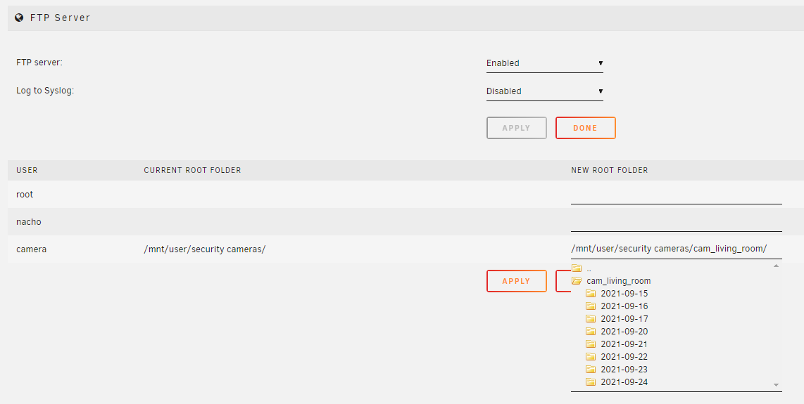

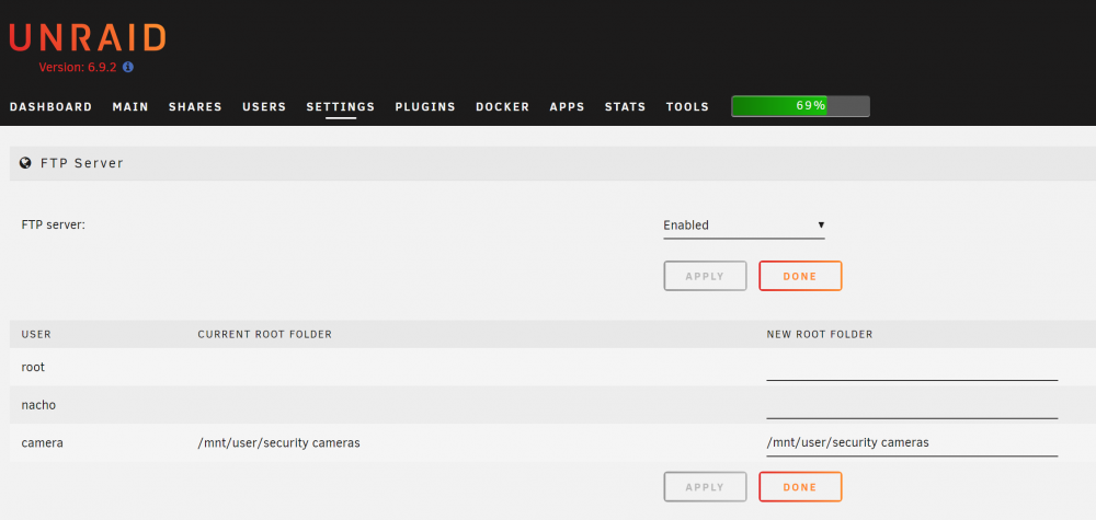

September 25, 20215 yr FWIW, I am working on an enhancement to the built in vsftpd to limit a user to just a specific folder. There is no need to use ProFTPD when vsftpd can do what we need. I'm almost done then hopefully they will accept my pull request. Stuck trying to figure out how the Done/Reset function works.
September 25, 20215 yr Community Expert 1 hour ago, IMTheNachoMan said: Stuck trying to figure out how the Done/Reset function works. This is normally done by having 2 different buttons and using JavaScript to show/hide the one that is not relevant.
September 25, 20215 yr 5 hours ago, itimpi said: This is normally done by having 2 different buttons and using JavaScript to show/hide the one that is not relevant. Yeah. The Unraid UI uses one button and changes the text. I can do it myself but I'm trying to find the code it uses so I can just use the same code. Trying to use as much existing code as possible.
September 26, 20215 yr It's all automatic, if you follow the same "format" / coding structure as any other page and use forms. ie: : <input type="submit" name="#apply" value="_(Apply)_" id='Apply'><input type="button" id="DONE" value="_(Done)_" onclick="done()"> Deviating means that you have to handle it via js
September 26, 20215 yr 1 hour ago, Squid said: It's all automatic, if you follow the same "format" / coding structure as any other page and use forms. ie: : <input type="submit" name="#apply" value="_(Apply)_" id='Apply'><input type="button" id="DONE" value="_(Done)_" onclick="done()"> Deviating means that you have to handle it via js Ha. I was doing that but I had a typo which is why it didn't work. Works now. Thanks!
September 26, 20215 yr I have the update the code (I think). I've tested it a bit but could use a 2nd set of eyes. Anyone willing to give it a test before I submit a pull request? Users are restricted to a folder of your choosing You can enable/disable logging to syslog You can select the root folder for each user
