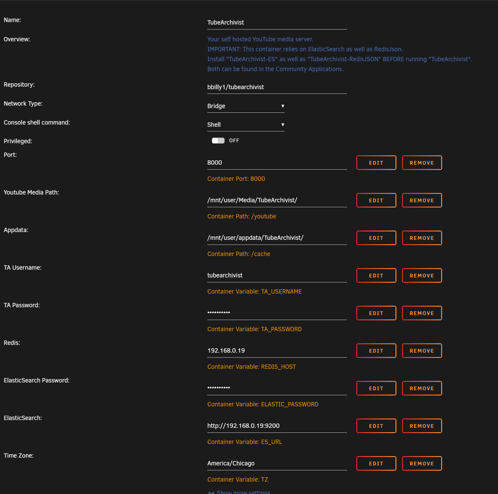

On 1/28/2022 at 11:16 AM, Crocs said:
Your Redis variable is set up wrong.
It's just the IP address, your variable should be '192.168.1.70'.
No 'http://' or '6379'
Let me know if that works!
Not sure about them, but changing that to remove the http:// and the port helped me get it working. Thanks!

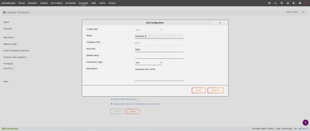

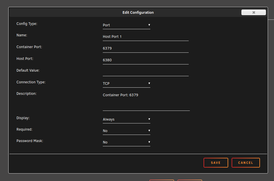

Hi - Need to be able to specify a different port for Redis - Is this possible please?

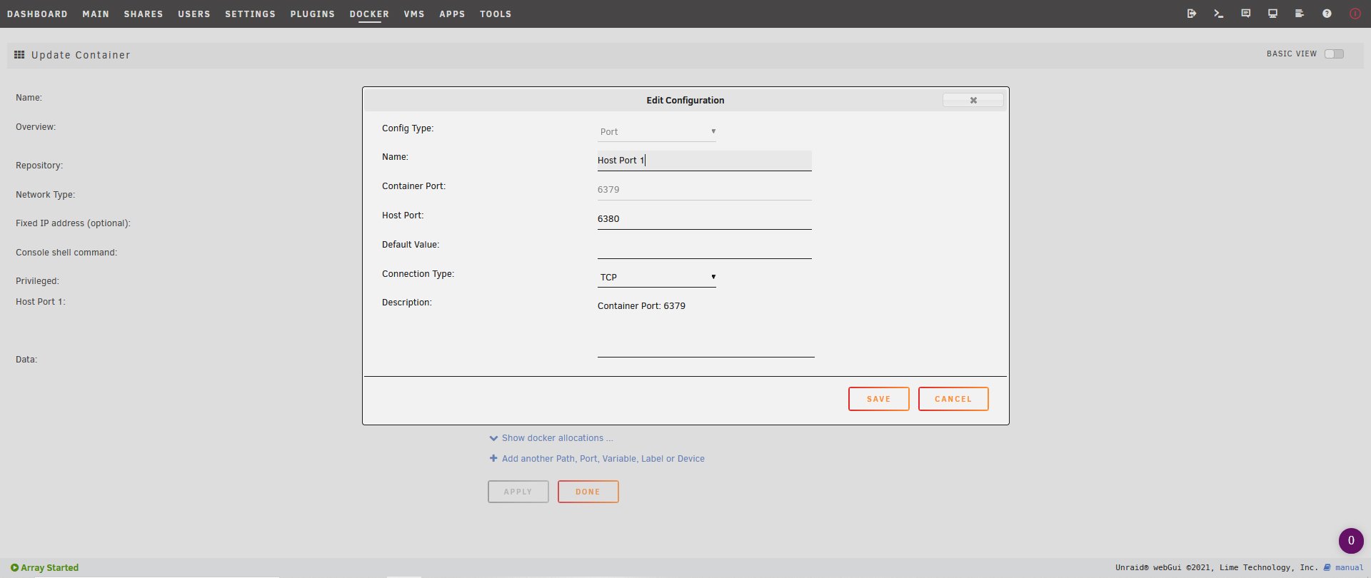

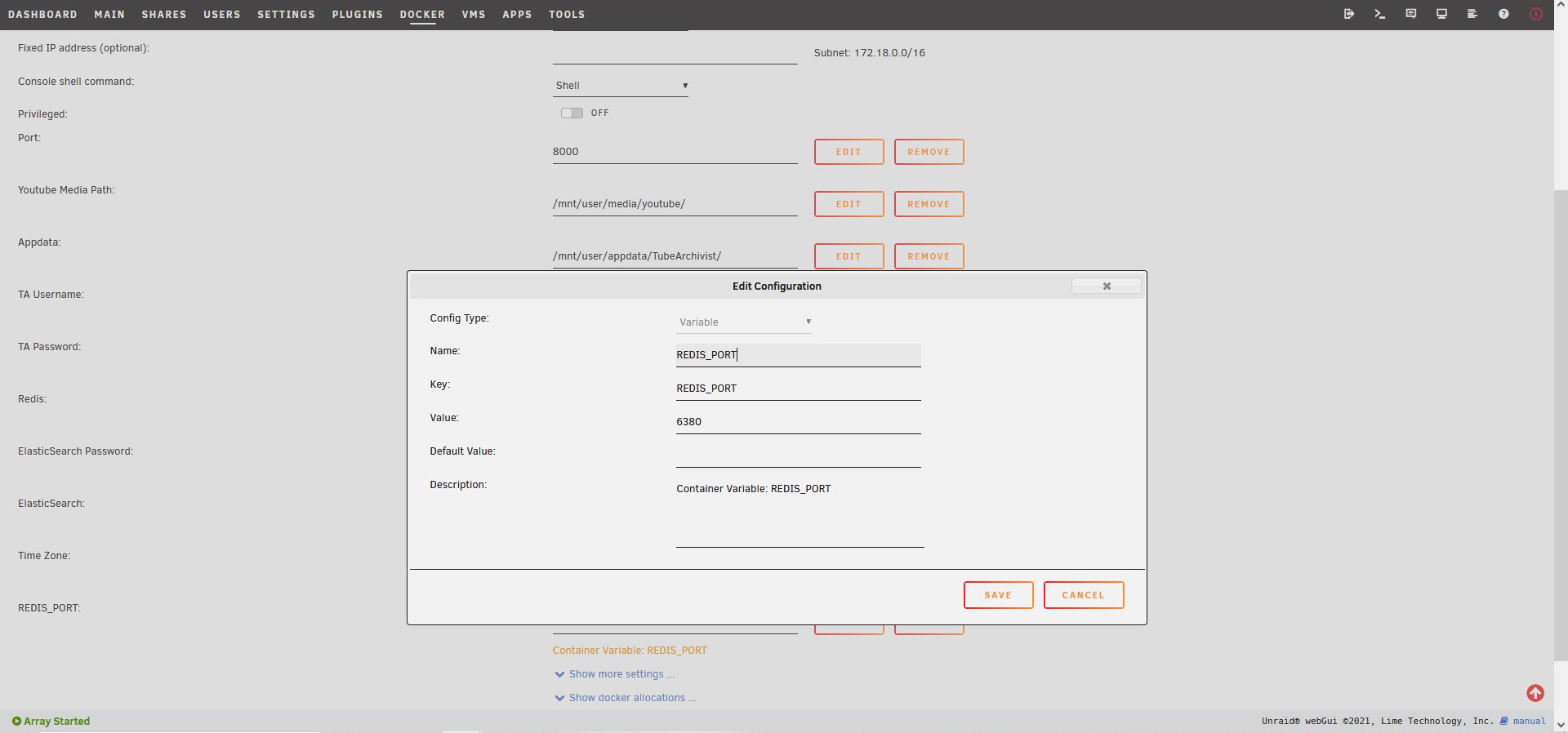

On 3/7/2022 at 5:19 PM, Crocs said:
I tried to follow this, but whenever
--port 6380
exists in the post argument the following error is returned and the container shuts down immediately.
The RDB file contains AUX module data I can't load: no matching module 'scdtype00'
This is with and without the module load argument.
@RoyalAbyss I was able to get port 6380 working for me by clicking "Add another Path, Port, Variable, Label or Device" and configuring this:

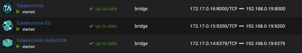

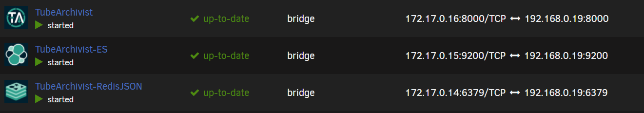

Can't seem to get to the web interface.  I have all 3 components installed (all fresh installs earlier today 3/27/22).
Starting up TubeArchivist and watching the log, here's what I see:

Any thoughts?  When I try going to http://192.168.0.19:8000 I get:
Latest version of Chrome.  No port conflicts for port 8000
Edited by JasonK
@JasonK I had the same problem and all you have to do is go to Elasticsearch-ES and modify the image to use 7.17.1 instead of 7.14.1, and then restart main TubeArchivist container. It will then take a few minutes for the migrations to run and so on, but it should work.
Edited by Mihai
Thanks!  That fixed it for me :)

7 hours ago, Liqwid_Kirk said:
How do you change the permissions for the appdata? Also, do I add the UID and GID permissions to the ES container itself?
Can you share a screenshot of you ES and TA container setups?
I did change the password for elasticsearch, but I made it the same in the TA container
Edited by Liqwid_Kirk

On 9/25/2021 at 2:14 PM, muppie said:
I’ve filled out the redis IP and elasticsearch IP in the template and I’ve tried to review the screenshots again and to me they look the same. Attaching it here:
I cannot spot any errors. If I add port to the redis IP it is duplicated in the logs (as IP:6379:6379) so I removed it.
You need to add a new variable. I had this same problem and the port change is what was causing it. I figured that out by disabling my legit redis and using the default port and it worked. so I went back in and messed with it and read the wiki more.
and I just changed the host port on the archivist redis.

I am having some issues...
It was about 5 days ago there was an update for tubearchivist that broke it... it fails to start even after waiting a few days for a new update... I have since uninstalled the docker and reinstalled it... and still fails to start... dies within a second or so... anyone else having this happen?
where in this docker or what commands should I run to collect logs... I am a bit lost when it comes to dockers
