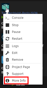

The hmmmm I was referring to is if you select the "more info" link on the Unraid container for TubeArchivist-RedisJSON.
It brings you to the DockerHub page (https://hub.docker.com/r/redislabs/rejson/). That page states that "This docker image has been deprecated, please download the redis-stack docker."
Does this pose any concerns going forward?

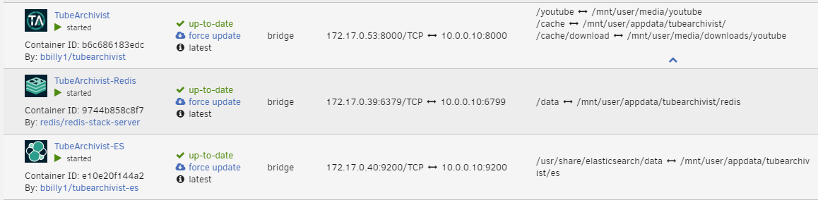

According to this we just change the redislabs/rejason to redis/redis-stack-server and it should be a drop-in replacement.
On startup I can confirm I see the following now with the change.
So to confirm this is now my current setup.

Hi.
I also got this Warning but I didn't need to add the variable. As mentioned by @CorneliousJD it was already there.
I tried to mimic the advice here... and blew up my entire setup... when I checked for updates for this docker it said there was "not available"
in my panic... I forced an update... and blew up the whole thing... it wont start and on a fresh install it dies right away...
suggestions?
suggestions?
Which container, as there are 3.
Did you replace the repo for the redisjson container?
Which of the 3 said it didn't have an update available? Forcing an update shouldn't break anything.
I did the force refresh on the main tube archive docker... that was the one that said and update was "not available" which is odd
I did change the repo on the redisjson container and that didnt help anything... thus I tried the force update on the main docker
A force update certainly shouldn't break anything - have you looked at logs - what do the logs of the main container say when it ends up stopping?
I think anyone here (myself included) will need some more info before we can really help.
Also, not that I suggest this yet, but if all else fails you could blow away the entire stack of 3 containers and start fresh and restore from a snapshot backup within TA itself?
