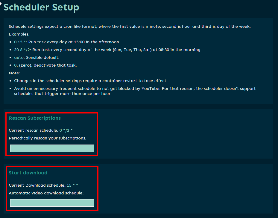

If that's not what you mean, I would take a look at the Scheduler Setup (in TA not the Docker template settings) and check what the rescan and start download frequency are set to.

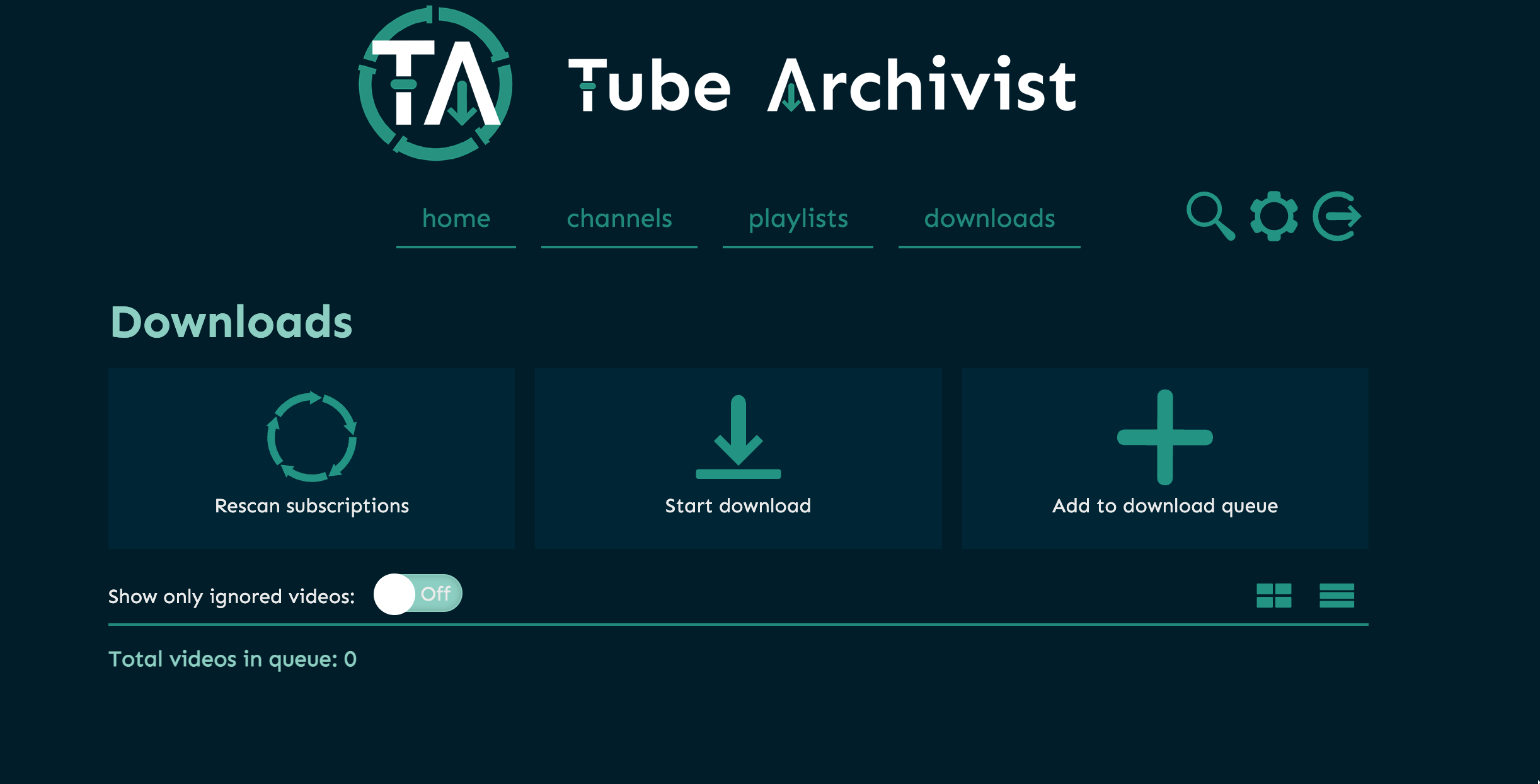

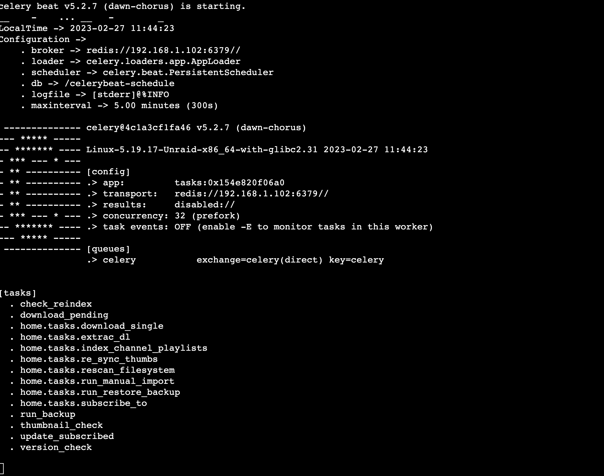

Apologize for the lack of info. Essentially after I added 2 subscriptions i have tesdrove it and went to the downloads tab and hit rescan subscriptions. I was under the impression it would be scanning the 2 channels I have added and presented me with a list of of videos it found (regardless of the scheduler).  The rescan spins for a while but it stops and never finds anything.  I might have done something wrong. I have restarted the container(s) a couple of times and made sure there was no error in the logs
Thank you
Can you make a screen recording of what you are doing?
When you subscribe to a channel, the entire channel will be queued up to download. The queue will run on the scheduler settings, but it is limited to not connecting to YT to download more than once per hour.
If you click on the Channels page, it should list all your subscribed channels. If you click on one of the channels, it should bring you to a page listing all the downloaded videos.
Are you saying that this is not happening?

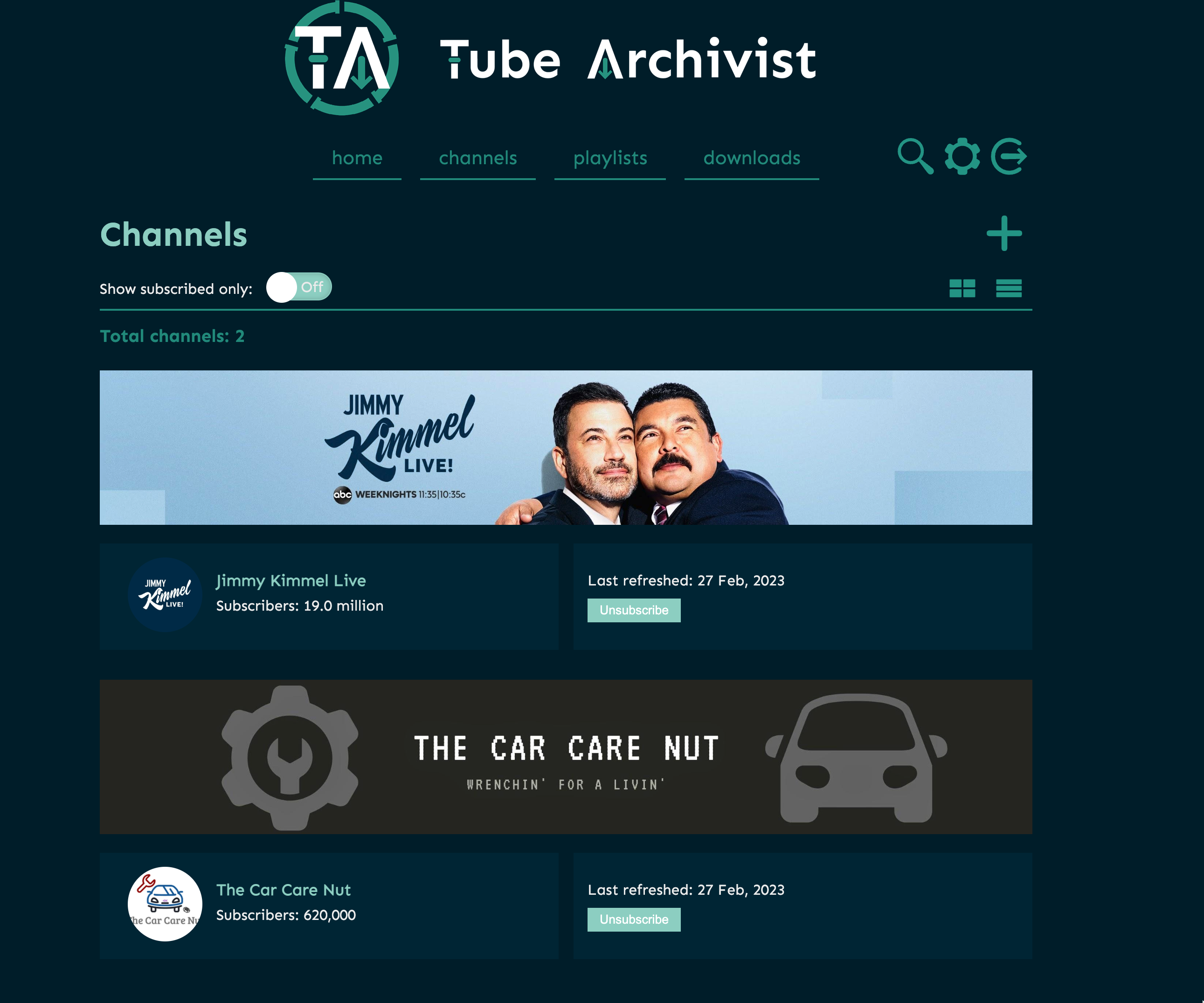

I added 2 random channels and if I click on any of them it says there are no videos but I tried with a lot of other channels.
Rescan spins and spins but never finds anything.
Let's get the immediate things out of the way first.
1. You installed TubeArchivist-ES
2. You've installed TubeArchivist-Redis (using redis/redis-stack-server:latest image)
3. You've added the 'path.repo' variable to the Redis template and pointed it to the right user share for ES snapshots
4. You've configured the right paths in the TA template such as ES, Redis and where it's going to store DL's

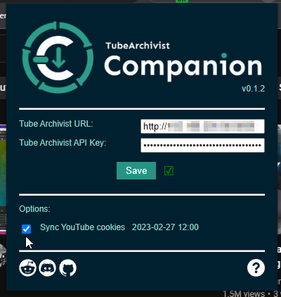

Did you install the Chrome Add-on and check off 'sync cookies'

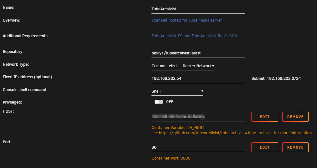

I moved TA to my Docker network with a dedicated NIC. I also moved ES and Redis to the same network each with dedicated IP's. I updated the TA config so it can connect to those services and then changed the port in TA from 8000 to 80.
But it won't take. It still shows port 8000.
I don't see any error messages in logs referring to that.
Everything was working fine prior and still does aside form the port issue.

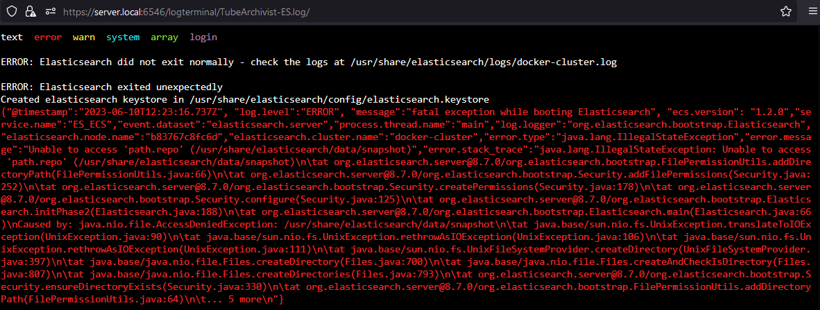

On 12/8/2022 at 10:33 PM, msherman83 said:
Hello,
Same issue as the others above on a fresh install. It seems for some reason you need to change the ./es folder to 777 to get the es container to write to it.
Access the Unraid CLI and enter:
chmod -R 777 /mnt/user/appdata/TubeArchivist/es
I noticed a large java file permissions error in the ES container logs the first few times i tried to start it. It would die right away, so you couldn't login to it.
This fixed my issue of both the TubeArchivist and TubeArchivist-ES containers from not starting. THANK YOU SO MUCH.
periodically, using the file manager plugin, select the appdata share and reset the ownership to 'nobody' and the permissions to 'read/write' for all three levels.
This is the default for Unraids built in permissions system to function. Some Docker containers either don't have explicit settings for GUID and PUID as well as UMASK support. As such, they write files with internal container permissions and it messes with Unraid on the host side.
I wish there was an automation plugin that could watch for this happenening and correect it in real-time. All my searches have led to people telling me to script it myself. There is a plugin that is specifically for this purpose, "Docker Safe New Perms" in the tools section, top row. But it is a manual process and it hits all shares across the whole server. Probably smart to do now and then as well.

On 2/21/2023 at 5:57 AM, mathomas3 said:
for anyone everyone else... there is a new ES setting that needs to be manually done... here it is
This isn't working for me, the docker just crashes. I am not sure /usr/share is an actual unraid share, maybe I need to move it to appdata?
Hmm - just tried to update the path and the CA apps is a variable, not a path. I guess I will wait to see what people say.
FIXED - had to run new permissions on es appdata folder

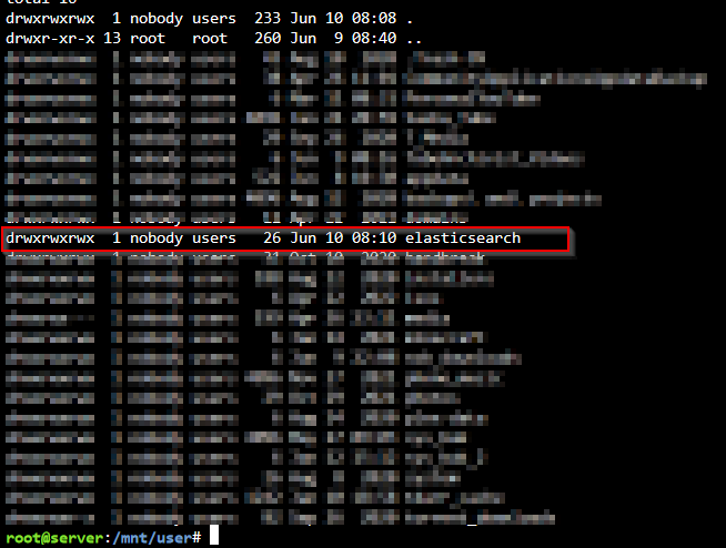

I'm stuck on path.repo permissions issues and am totally clueless as to what to do.
I've chown'd everything to nobody:users, chmod'd to 777 across the board, but it still generates a permissions issue as seen in logs.png.
What the heck am I doing wrong?

What are the GID and PID both container is running under?
