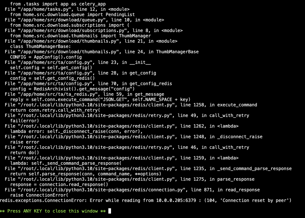

I'm trying to set up tubearchivist and thought I had everything set correctly, but it won't start. Here's the log, appreciate any guidance on getting this working.

So I setup the containers according to: https://docs.tubearchivist.com/installation/unraid/
The redis and ES container are running fine, no erros in the logs.
But everytime I try to start the TA container it just stops itself immediately. I also checked the permissions of the folders:
The TA config
I checked the ES Password multiple times and it's definitely correct. Then I changed the port to 8001 hoping that maybe there's an issue with another service running on 8000 which prevents the container to start. It's hard to identify the problem because I can't inspect the logs.

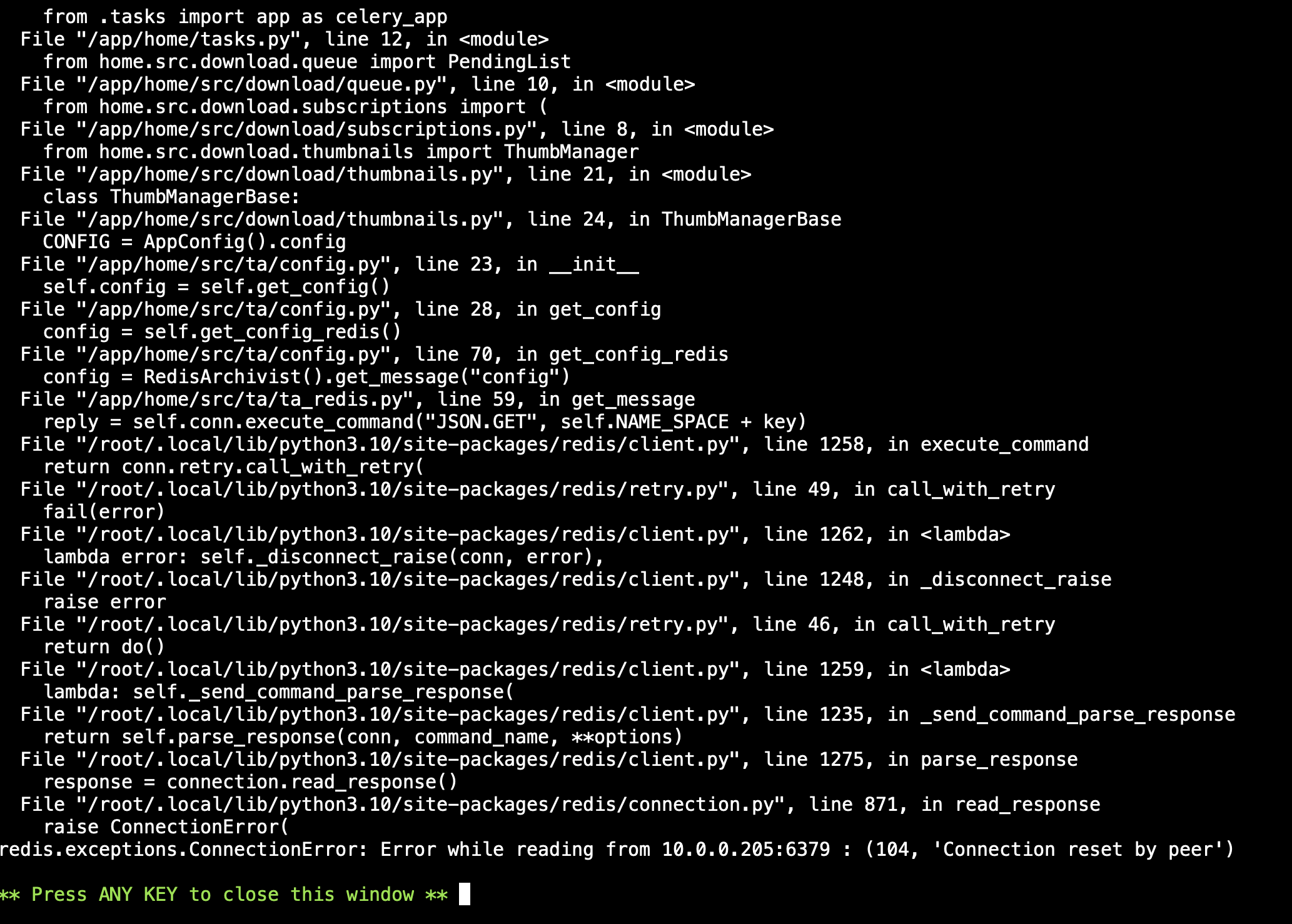

The TubeArchivist-RedisJSON docker had a update, and how it will not start. Docker log is below.
EDIT: Found the issue. I renamed the dump.rdb in the appdata > TubeArchivist > redis folder and started the docker.
TubeArchivist-RedisJSON.txt
Edited by RonneBlaze
fixed issue
Thank you! Worked like a charm.
The rename of dump.rdb also worked for me
