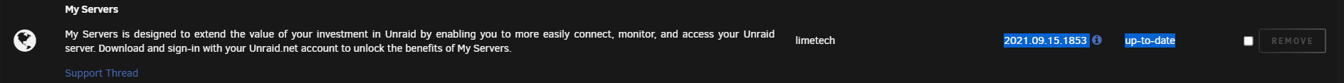

Go to the Plugins tab and check for updates. You'll want to make sure you are running the latest version of the My Servers plugin, which is currently 2021.09.15.1853.
If you are still having issues, open a webterminal and type:
  unraid-api restart
Thanks @ljm42  I had the latest version on both servers. The 'unraid-api restart' fixed it. Needed to run it twice on one of the servers, but now both are working.

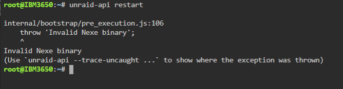

i have same error but when i attempt to run that or the debug command i get this:
Server 1 (Unraid)
Server 2 IBM3650
not sure whats up but seems like plugin on both machines corrupted overnight? they were both working fine yesterday.
Server 1 (Unraid)
Server 2 IBM3650
I have seen a Segmentation Fault happen right after an install, but never on a running system. When did you update to the latest version, or did CA Auto Update possibly do it for you prior to the issue?
A Segmentation Fault means the unraid-api binary is corrupted. That may point to hardware RAM issues, but I'm not really sure. Two systems at once is definitely strange.
Uninstalling / reinstalling the plugin will get you back up and running.

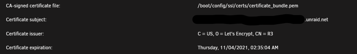

one thing i did notice and not sure if it is the difference from 6.9 and 6.10 is the following..:
this is the 6.10 unraid server ;
This is the 6.9 unraid server im noticing the difference of cert subject and ca signed.
is this due to the difference in the builds?
Thanks
Yes, 6.10 makes a number of improvements to how SSL is handled
