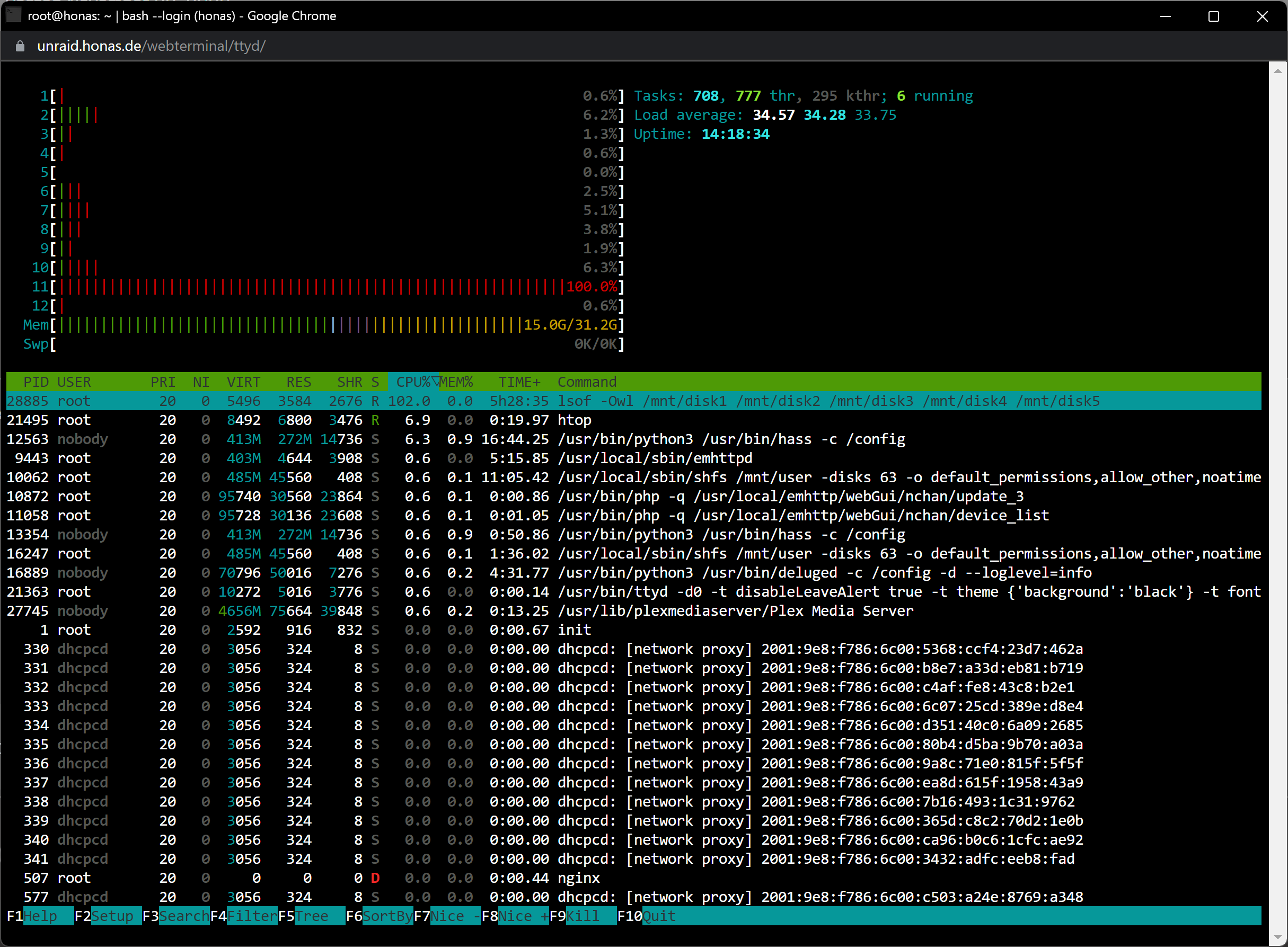

I have a windows 10 VM configured and it worked fine in the past however now when it runs the remaining CPUs on my unraid server that are not allocated to the VM got to 100%. If i manage to force stop the VM this goes back to normal. I have assumed it was an issue with the VM however I'm not sure why this would impact CPUs on the host that were not allocated to the VM if there was an issue with the VM.
 I recently had an uncontrolled shutdown. I booted up the server and left it to run its parity check overnight. The next day i saw the CPU was pegged at 100% (With the VM off) and the parity check had an estimated duration of 20 days. After stopping the parity check the CPU was still stuck at 100% a few hours after.
In both cases when the CPU is at 100% i have run htop and noticed there are multiple instances of
lsof -Owl /mnt/Disk1 /mnt/Disk2
using a lot of the CPU. Can anyone help me see what might be happening here? I suspect it's something related to my cache disk but ran smart diagnostics and there were not issues.

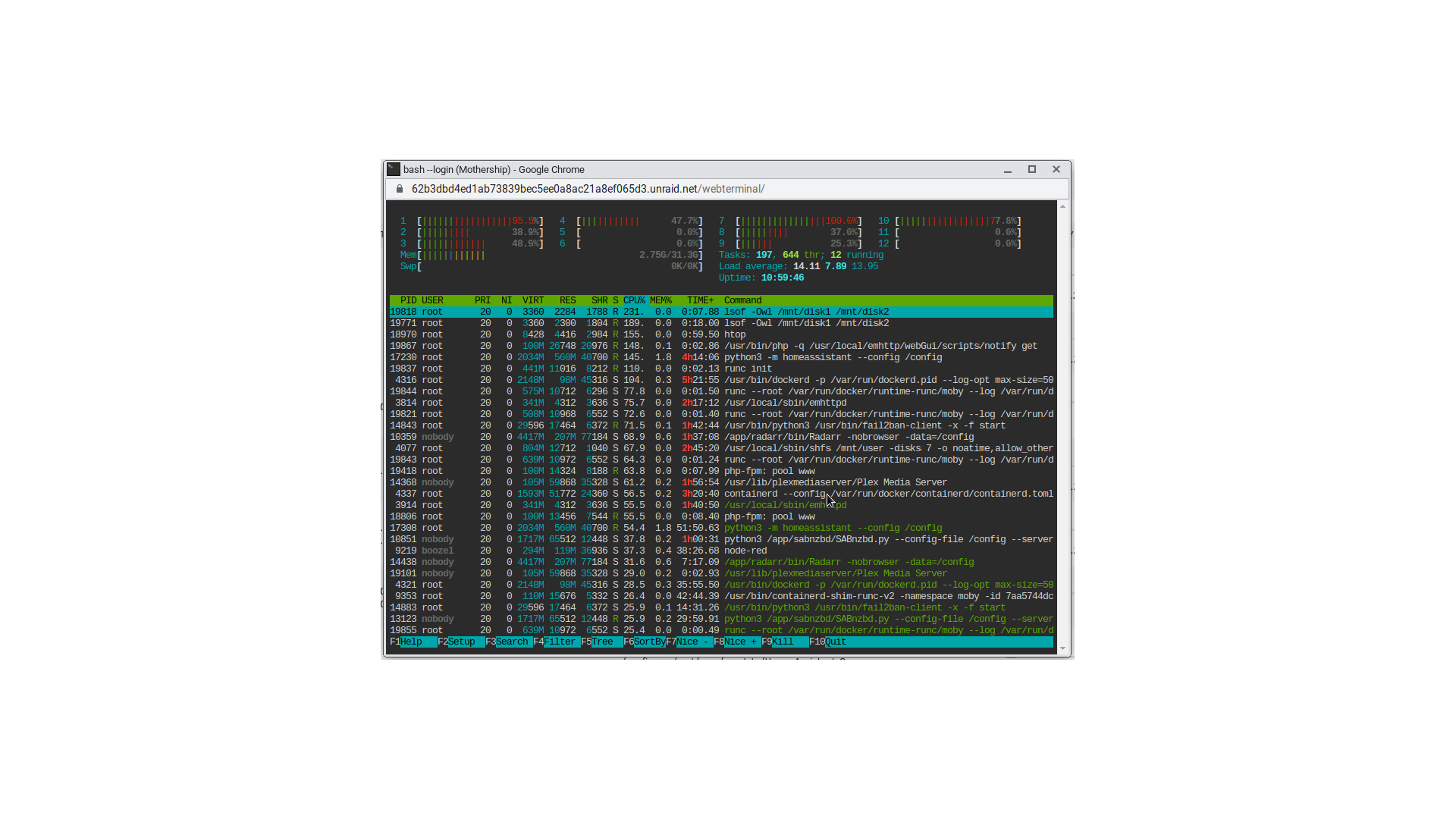

Did you figure out what "feature" causes this? I see an lsof task running every 5-10 seconds as a process spawned by update1. I have made sure I closed all WebUI interfaces (closed browser completely, made sure no processes still running) but they persist. This is the command that keeps running
sh -c LANG='en_US.UTF8' lsof -Owl /mnt/disk[0-9]* 2>/dev/null|awk '/^shfs/ && $0!~/\.AppleD(B|ouble)/ && $5=="REG"'|awk -F/ '{print $4}'
I don't have any Apple devices so whilst mine's not pegging the CPU at 100% for extended periods it's not necessary. Just runs 100% for maybe a second each time. Seems to be look for hidden files left by Macs and then prints them somewhere. Seems kind of pointless to me.
I see a sleep 2, so perhaps running every two seconds:
 ps aux | grep ls[o]f -A5 -B5
root     17957  0.0  0.1  88744 29040 ?        SL   Jul03  24:23 /usr/bin/php -q /usr/local/emhttp/webGui/nchan/wg_poller
root     17960  0.0  0.1  88744 29000 ?        SL   Jul03   6:40 /usr/bin/php -q /usr/local/emhttp/webGui/nchan/update_1
root     17963  0.0  0.1  88944 29716 ?        SL   Jul03  34:08 /usr/bin/php -q /usr/local/emhttp/webGui/nchan/update_2
root     17966  0.1  0.1  88884 29408 ?        SL   Jul03  64:21 /usr/bin/php -q /usr/local/emhttp/webGui/nchan/update_3
root     18095  0.0  0.0      0     0 ?        I    17:31   0:00 [kworker/2:0]
root     18149  0.0  0.0   3936  2984 ?        S    17:31   0:00 sh -c LANG='en_US.UTF8' lsof -Owl /mnt/disk[0-9]* 2>/dev/null|awk '/^shfs/ && $0!~/\.AppleD(B|ouble)/ && $5=="REG"'|awk -F/ '{print $4}'
root     18150 13.0  0.0   5340  3292 ?        S    17:31   0:00 lsof -Owl /mnt/disk1 /mnt/disk2 /mnt/disk3 /mnt/disk4 /mnt/disk5
root     18151  0.0  0.0   8376  2560 ?        S    17:31   0:00 awk /^shfs/ && $0!~/\.AppleD(B|ouble)/ && $5=="REG"
root     18152  0.0  0.0   8244  2496 ?        S    17:31   0:00 awk -F/ {print $4}
root     18155  0.0  0.0   2464   732 ?        S    17:31   0:00 sleep 2
root     18156  0.0  0.0   4860  2908 pts/27   R+   17:31   0:00 ps aux
root     18157  0.0  0.0   3980  2228 pts/27   S+   17:31   0:00 grep ls[o]f -A5 -B5

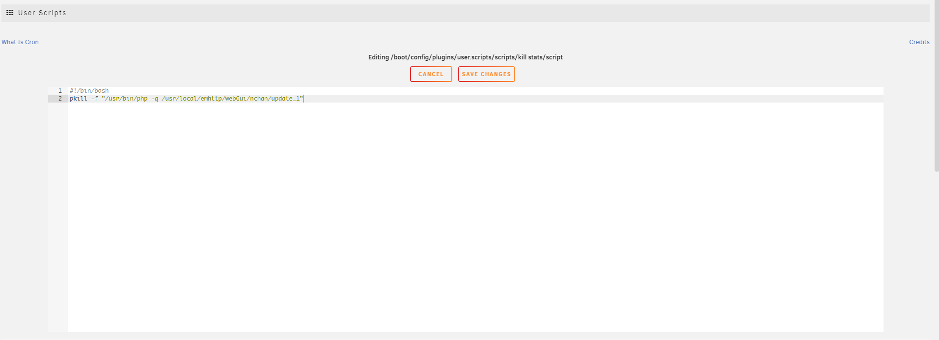

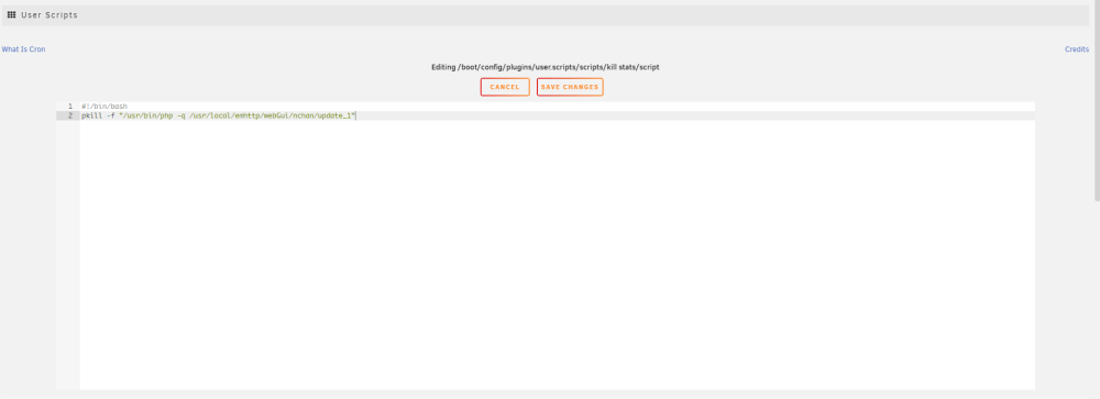

So i came out with this "user script" runing once-a-day:

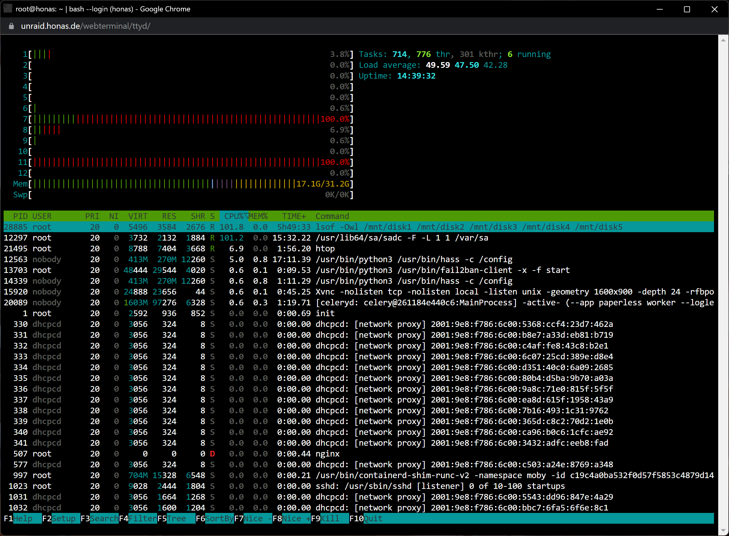

hi,
@grants169 this was the solution i searched for. this behavior started with 7.1.4 again.
did a little tweaking and just increased the sleep timer in line 131 to 60 seconds, seemed more feasible and does not "destroy" the functionality.
server before: 3 processes of lsof constantly respawning using 3 cpus completely.
server after change and /etc/rc.d/rc.nginx reload: 1 process every 60 seconds, power usage down by 50 watts.
many thanks.
