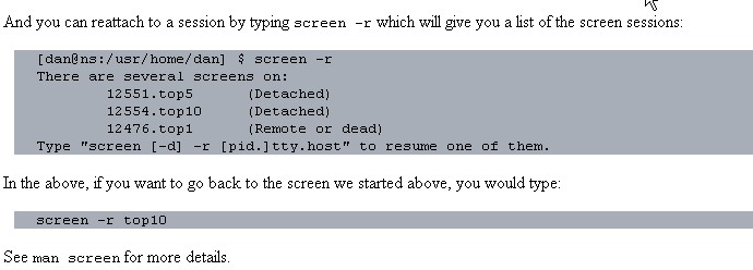

I lost my connection one time, and had to detach the screen.  I believe I closed out the telnet session, and opened a new session to reattach to screen.
CTRL-A CTRL-D will detach the screen
or follow this:
https://kb.iu.edu/data/ahrm.html
