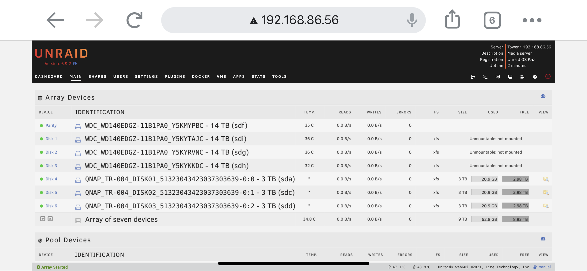

I'm ~5 days into Unraid as a recovering Windows addict, and appear to have a serious situation on my hands.  After battling my lack of linux knowledge, I was able to get my plex instance migrated to Docker and running great yesterday.  I added a few 3tb drives, and let them complete the format/mounting overnight last night.  I was having an issue getting Libvert Service to start, so this morning I rebooted my unraid box.  On reboot, all three of my main data drives went to unmountable, leaving only the newly added 3TB in the array.  Terrified I've lost all of my progress and a ton of production data.  Any help would be immensely appreciated!
I'm showing file system corruption in the logs, and something has gone wonky with the UUIDs:
Sep 28 09:30:40 Tower kernel: XFS (md1): Corruption detected. Unmount and run xfs_repair
Sep 28 09:30:40 Tower kernel: XFS (md1): log has mismatched uuid - can't recover
Sep 28 09:30:40 Tower kernel: XFS (md1): failed to find log head
Sep 28 09:30:40 Tower kernel: XFS (md1): log mount/recovery failed: error -117
Sep 28 09:30:40 Tower kernel: XFS (md1): log mount failed
Sep 28 09:30:40 Tower root: mount: /mnt/disk1: mount(2) system call failed: Structure needs cleaning.
Sep 28 09:30:40 Tower emhttpd: shcmd (5272): exit status: 32
Sep 28 09:30:40 Tower emhttpd: /mnt/disk1 mount error: not mounted
Sep 28 09:30:40 Tower emhttpd: shcmd (5273): umount /mnt/disk1
Sep 28 09:30:40 Tower root: umount: /mnt/disk1: not mounted.
Sep 28 09:30:40 Tower emhttpd: shcmd (5273): exit status: 32
Sep 28 09:30:40 Tower emhttpd: shcmd (5274): rmdir /mnt/disk1
Sep 28 09:30:40 Tower emhttpd: shcmd (5275): mkdir -p /mnt/disk2
Sep 28 09:30:40 Tower emhttpd: shcmd (5276): mount -t xfs -o noatime /dev/md2 /mnt/disk2
Sep 28 09:30:40 Tower kernel: XFS (md2): Mounting V5 Filesystem
Sep 28 09:30:40 Tower kernel: XFS (md2): Internal error !uuid_equal(&mp->m_sb.sb_uuid, &head->h_fs_uuid) at line 259 of file
Metadata corruption detected at 0x439218, xfs_agf block 0x27fffffd9/0x200
Metadata corruption detected at 0x439218, xfs_agf block 0x2ffffffd1/0x200
Metadata corruption detected at 0x439218, xfs_agf block 0xfffffff1/0x200
Metadata corruption detected at 0x439218, xfs_agf block 0x1/0x200Metadata corruption detected at 0x464290, xfs_agi block 0x2ffffffd2/0x200Metadata corruption detected at 0x464290, xfs_agi block 0x27fffffda/0x200
Metadata corruption detected at 0x439218, xfs_agf block 0x17fffffe9/0x200
bad uuid b89f9a81-1193-47c1-9df7-29bef286d1ca for agf 5
bad uuid b89f9a81-1193-47c1-9df7-29bef286d1ca for agf 6
bad uuid b89f9a81-1193-47c1-9df7-29bef286d1ca for agi 5
bad uuid b89f9a81-1193-47c1-9df7-29bef286d1ca for agi 6
tower-diagnostics-20210928-1006.zip MD1 MD2 MD3 xfs_repair output.txt

xfs_repair is aborting due to metadata corruption, you can try upgrading to v6.10-rc1 and running it again since it includes newer xfs-progs, but I suspect there's an underlying hardware issue and trying to repair might not be very successful.
