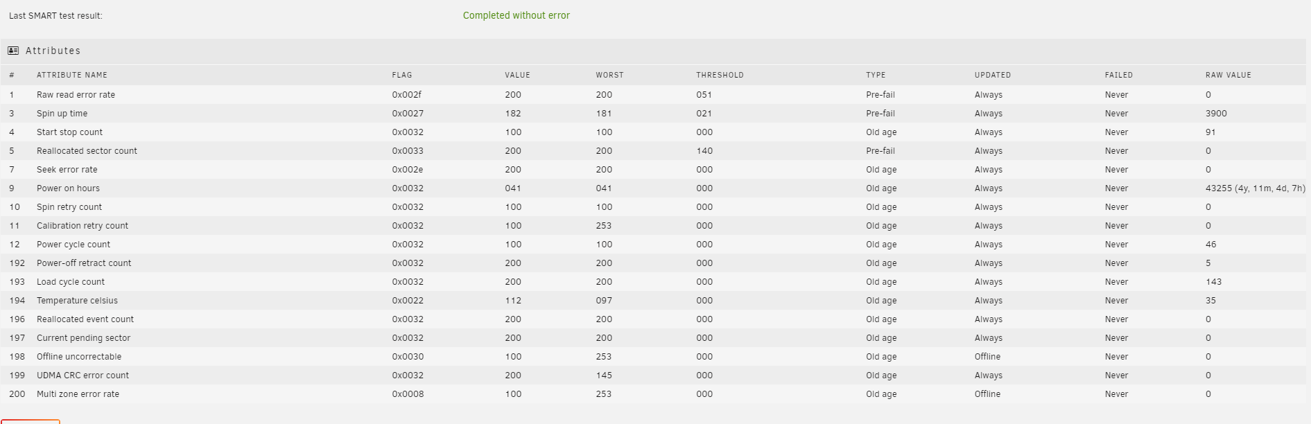

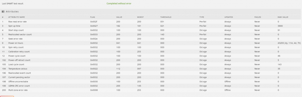

thanks - i havent been able to force the issue - this was a diagnostic from the last occurance
I did check the SMART report in the web but it said the disk passed all issues (and still does - see cache disk below)
Why is the UI not showing there to be an error? cache2 has similar values
im a little surprised i havent had any docker issues as that lives on those drives too
thanks - can see that now, i was just basing it off the web interface and didnt realise i could download a text report.
The web is still saying no errors even though there are some in the report
