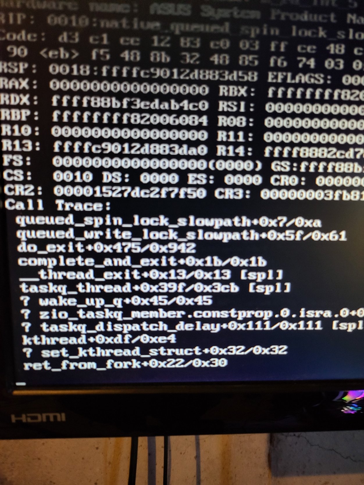

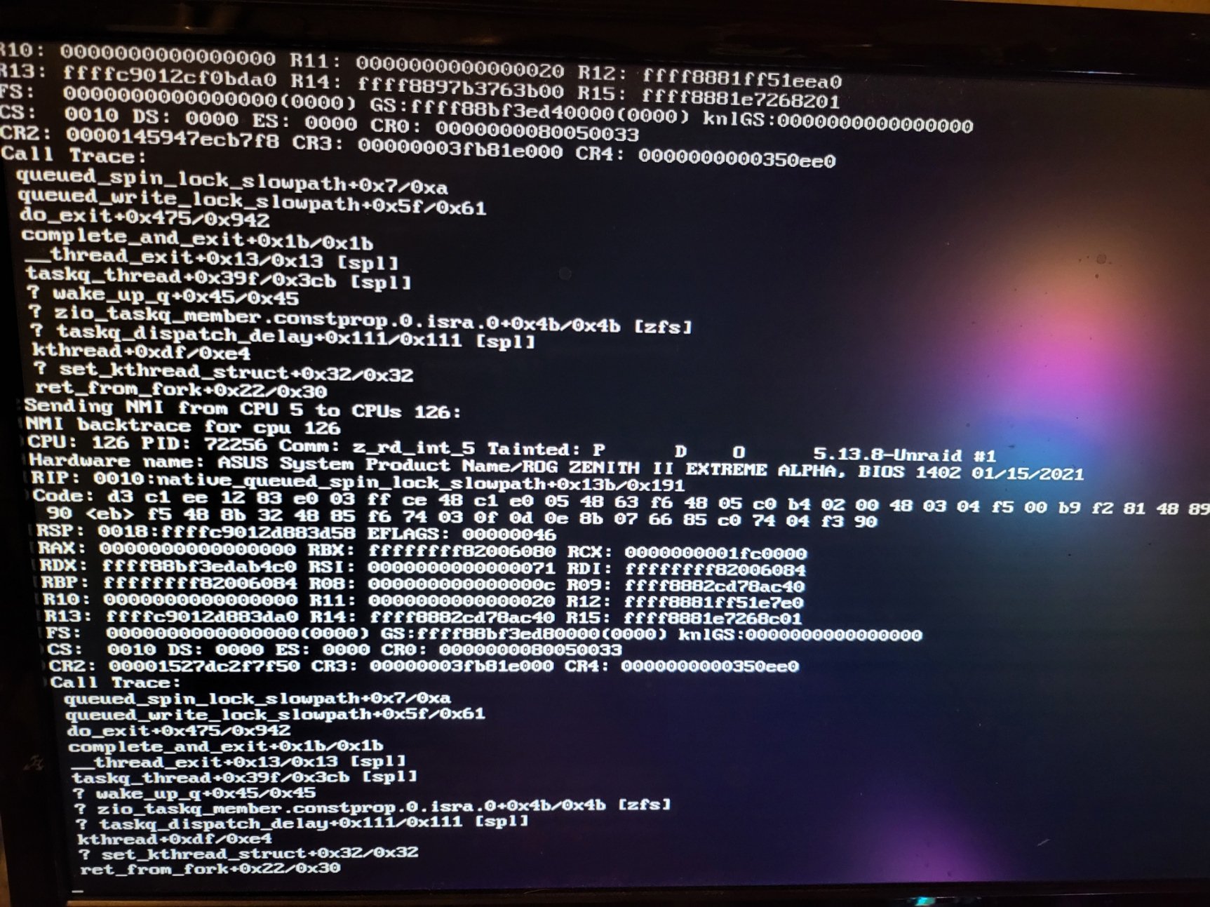

I cant get get the server to stay running. it boots completely, then after about 5 minutes or so, kernel panics:
20210929_131619.thumb.jpg.70f18d545650a612cf567e57dabccd84.jpg20210929_131605.thumb.jpg.5d12d9963c3451f94fc0e817354ef0f4.jpg
I just finally got to the point that I can add vms and docker images. after adding them, this started happening.... is it zfs? something I can do about it?

You should try to boot in safe mode to see if it is stable that way.
booting in safe mode fails. I get an error about mounting a bad fs. I didnt record its exact error.
Try booting after disconnecting the zfs pool.
did that. I moved my important info off of the pools and destroyed them all. currenly there are 0 zfs pools and was still getting kernel panics.
I have now installed a clean version of 6.9.2 with a couple plugins installed. docker and vms are disabled. system froze again, but no kernel panic. will do a couple more things and report back
