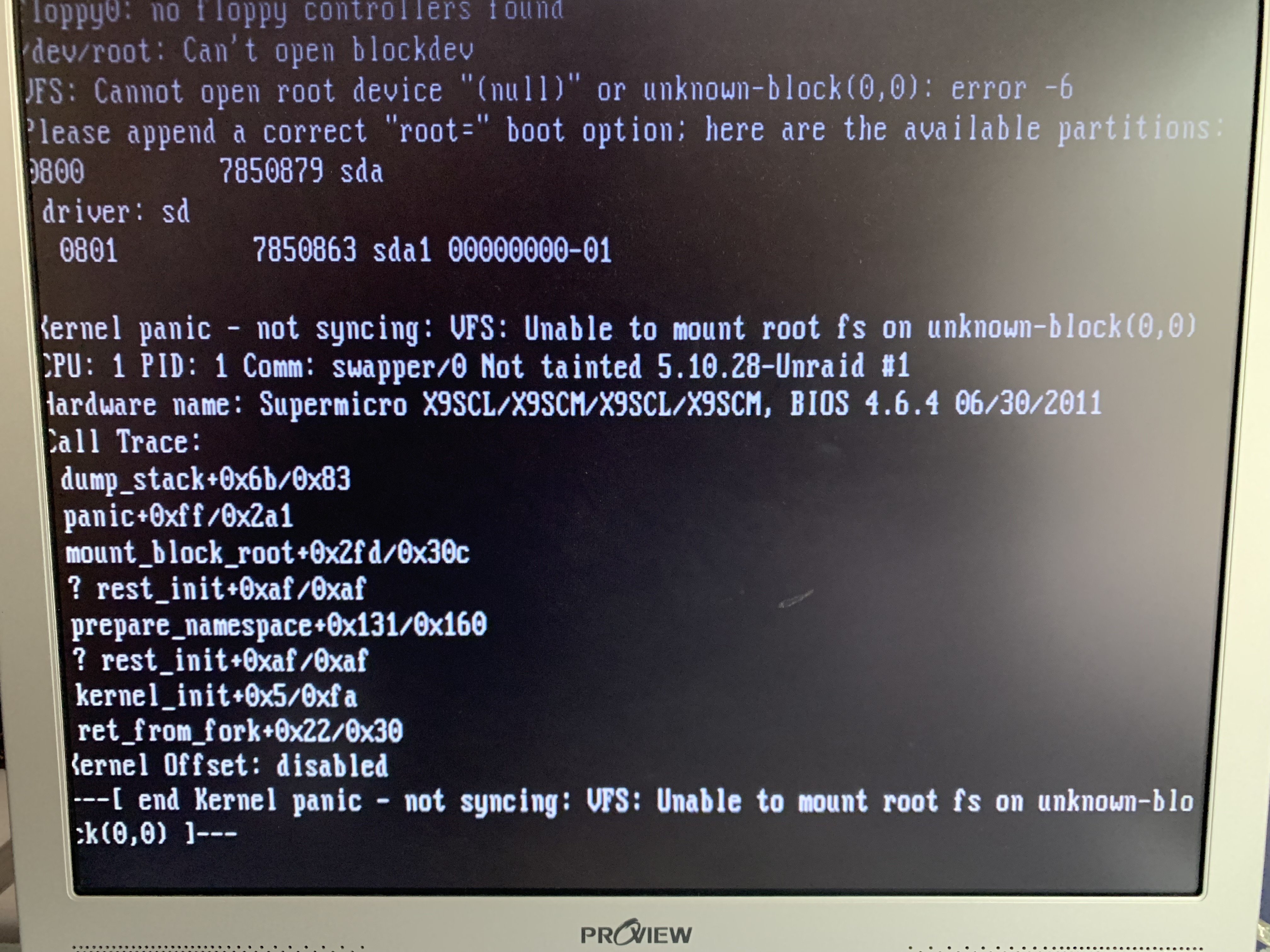

I have no monitor attached, I also can't log-in
You'll need to attach one to see where it's stopping.
It stops @
end kernel panic - not syncing : VFS : Unable to mount root fs on unknown-block(0,0)
This is usually a flash drive problem, backup config folder and recreate.
end-of life usb stick? Do I need to change the usb boot drive?
Do I just need to create a new flash drive with the Unraid flash creator and replace the config folder?
First try with the same USB drive, just recreate it.
Seems to work again, shut down and restarted several times now with no issues so far.
