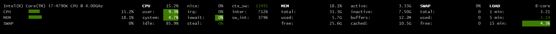

I checkt with glances no io wait.
im not sure why its so slow.
