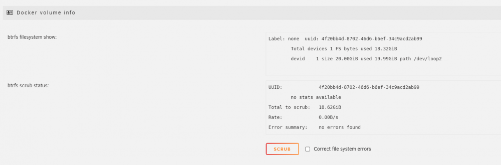

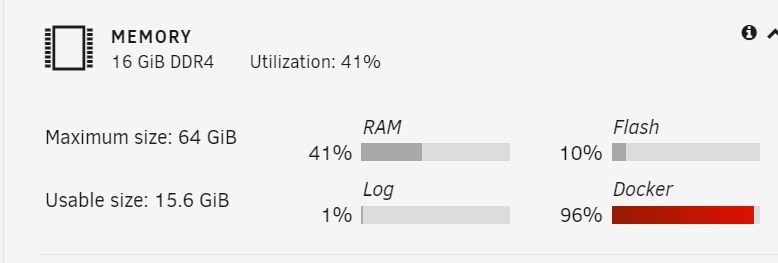

I was having a problem with Tdarr where i had an path incorrect and i believe it was writing data where it shouldn't be.  I THINK i have solved that problem, but my docker size still shows almost full
I've tried restarting tdarr and tdarr node.  I tried restarting the docker engine.  I left the docker engine off and restarted unraid.  I was hoping that that would flush out what had been written in the wrong place, but no go.

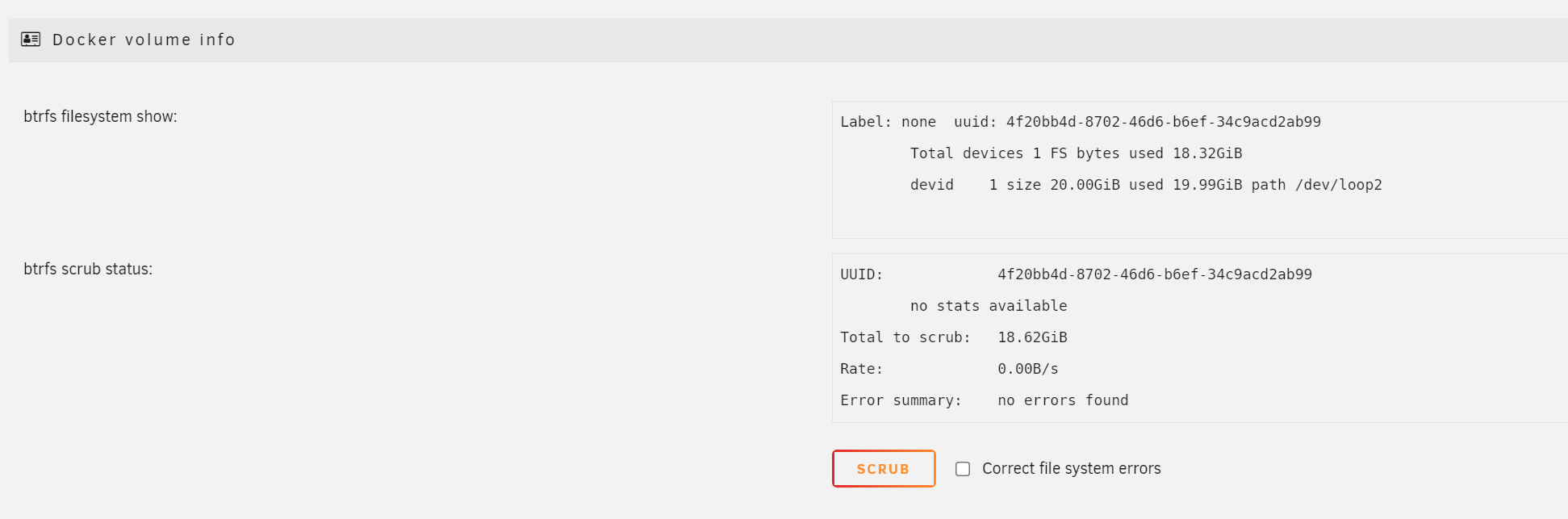

I see there's a "scrub" under the docker advanced settings, but i dont want to go being all click-happy and mess something up
