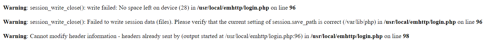

First of all, it was so wired when I wanted to download some files via transmission torrent docker. No doubt I still have some TB spaces on my disks, but transmission says I have no space on my device.
So I check my btrfs file system, It said that there were no error, and I found out that my rootfs was full.
Now, I reboot the system and I can't even open my web UI.
