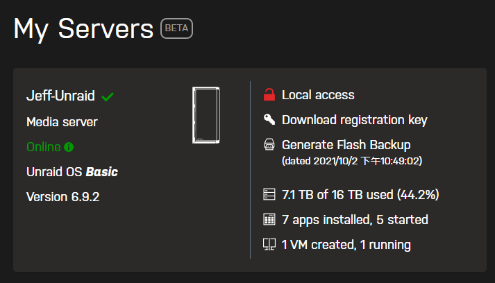

After I update my router today, my local access have a red lock icon instead a green lock icon for local access. Anyone know if that is an issue and how to fix it?

After I have my router upgrade, I can't access my tower with https://8fd0a398a4c0bxxxxxxxxxxxxxxx.unraid.net/ anymore locally. However, if I am outside my home, I am still able to access my server with the above link (I set up a port forward on my new router)
When I want to access my server locally, i find out I can do it by https://192.168.68.101 (which is my server LAN address). But if you try to access by 192.168.68.101 (without HTTPS in front), it will jump to https://8fd0a398a4c0bxxxxxxxxxxxxxxx.unraid.net/, and I am not able to access my tower.
