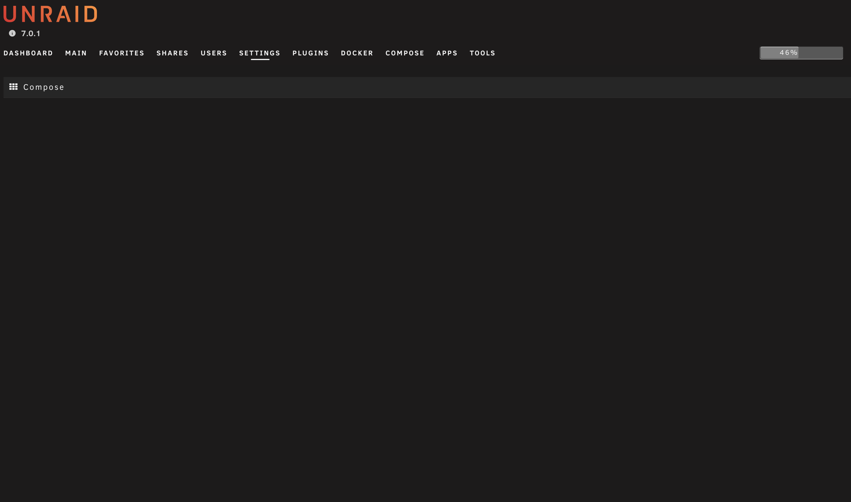

I have the same issue.
After installing, i click on it within the plugin tab, and it takes me to settings, but the settings page is just blank.  Ive tried reinstalling 5-6 times to no avail.
Docker enabled?

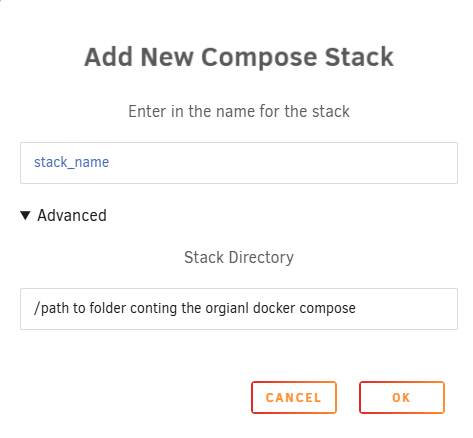

On 2/28/2025 at 9:33 AM, unraid_fk34 said:
so since updating to 7.0 I've had the issue that the compose plugin just doesn't show any stacks at all. My containers are all started but I see no stacks to edit at all. I checked if the docker-compose.yml are in their respective folders in the plugin folder and they are. Reinstalling the plugin or rebooting didn't do the trick. What could be the issue?
data should still be in the stack directory if you added the stack and click advance and set the location on disk.
under the docker tab do you see the compose add a new stack?
if yes, re-added the stack and point it to the folder, and the compose plugin will reload and reread any previous data.
This is the first i'm hearing of a upgrade or reboot where compose breaks and the docker web UI is missing.
double-check the plugins page and systemlog to make sure compose got installed and didn't error at boot.
If you didn't advance and set to a location, the compose files are saved to the flash drive as a default locations and path:
/boot/config/plugins/compose.manager/projects

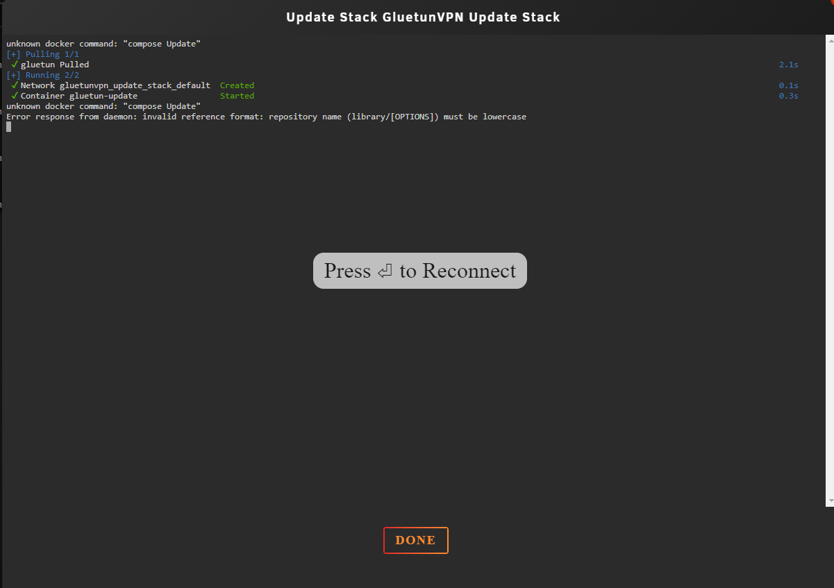

Anyone suddenly getting errors when trying to update any and all stacks? All stacks have been on my system for years and have updated fine in the past.
Here is the compose file for reference:
services:
  gluetun:
    image: qmcgaw/gluetun:latest
    container_name: gluetun-update
    cap_add:
      - NET_ADMIN
    volumes:
      - /mnt/cache/appdata/gluetun:/gluetun
    command: update -enduser -providers airvpn
Edited by Avsynthe

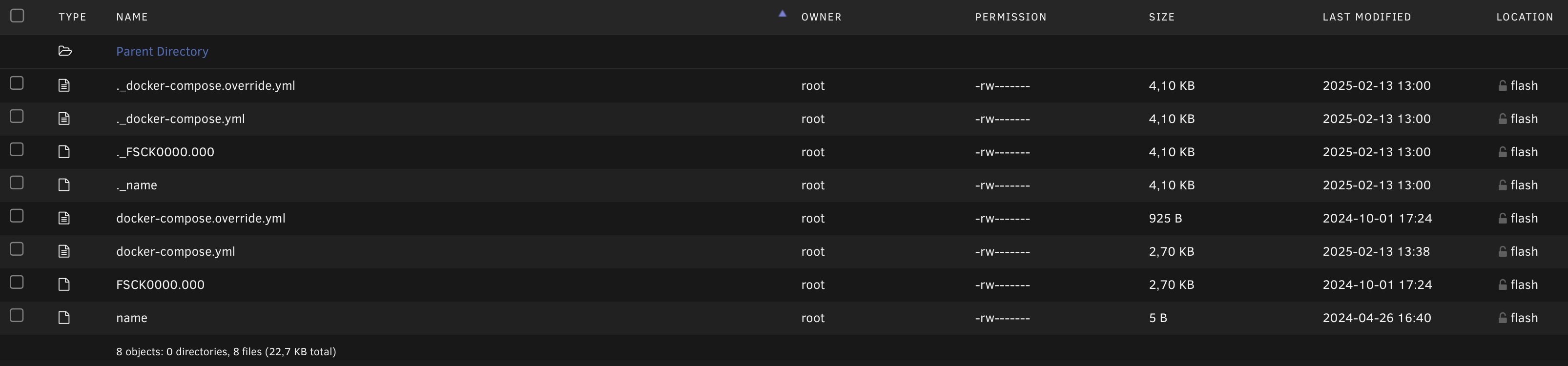

Thanks for getting back to me.
Checking if all the stacks are still in the mentioned path is the first thing I did when this started occurring. Everything is there.
But what I got in all of my stack folders are these other weird duplicates. I don't know exactly when they started popping up but they are not part of the daily backup.

hmmm.. Interesting. I've never experienced the stack button missing before... you can call it via termainl?
docker compose -d
docker composer -it
via the termianl targeting the docker compose file... that will atleast docker compose run the docker stack...
I believe you have may have flash drive corruption or cached browsed data that may not be fully loading the page.
Do a  "super refresh"
ctrl + r
shift + f5
otherwise, I would recommend uninstalling the docker compose and reinstalling the compose plugin from the CA....
I would recommend backing up the docker compose files that you do have and deleting the folder off the flash drive and do a plugin reinstall to regain webui controls back.
