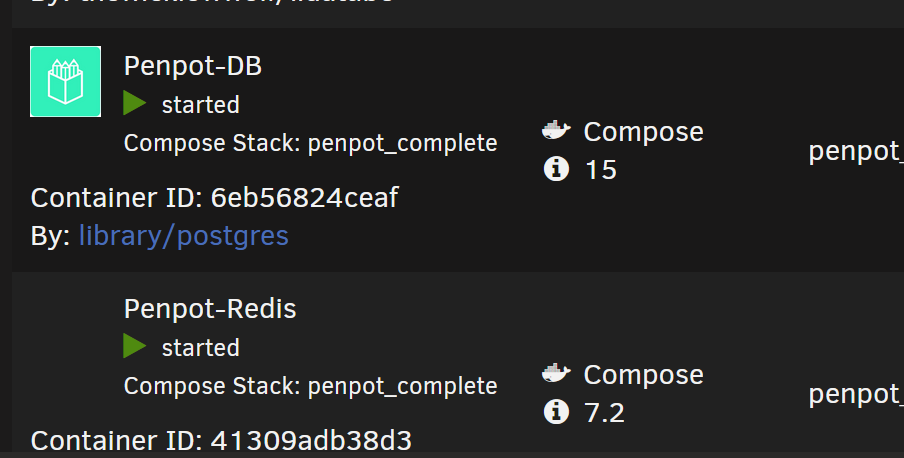

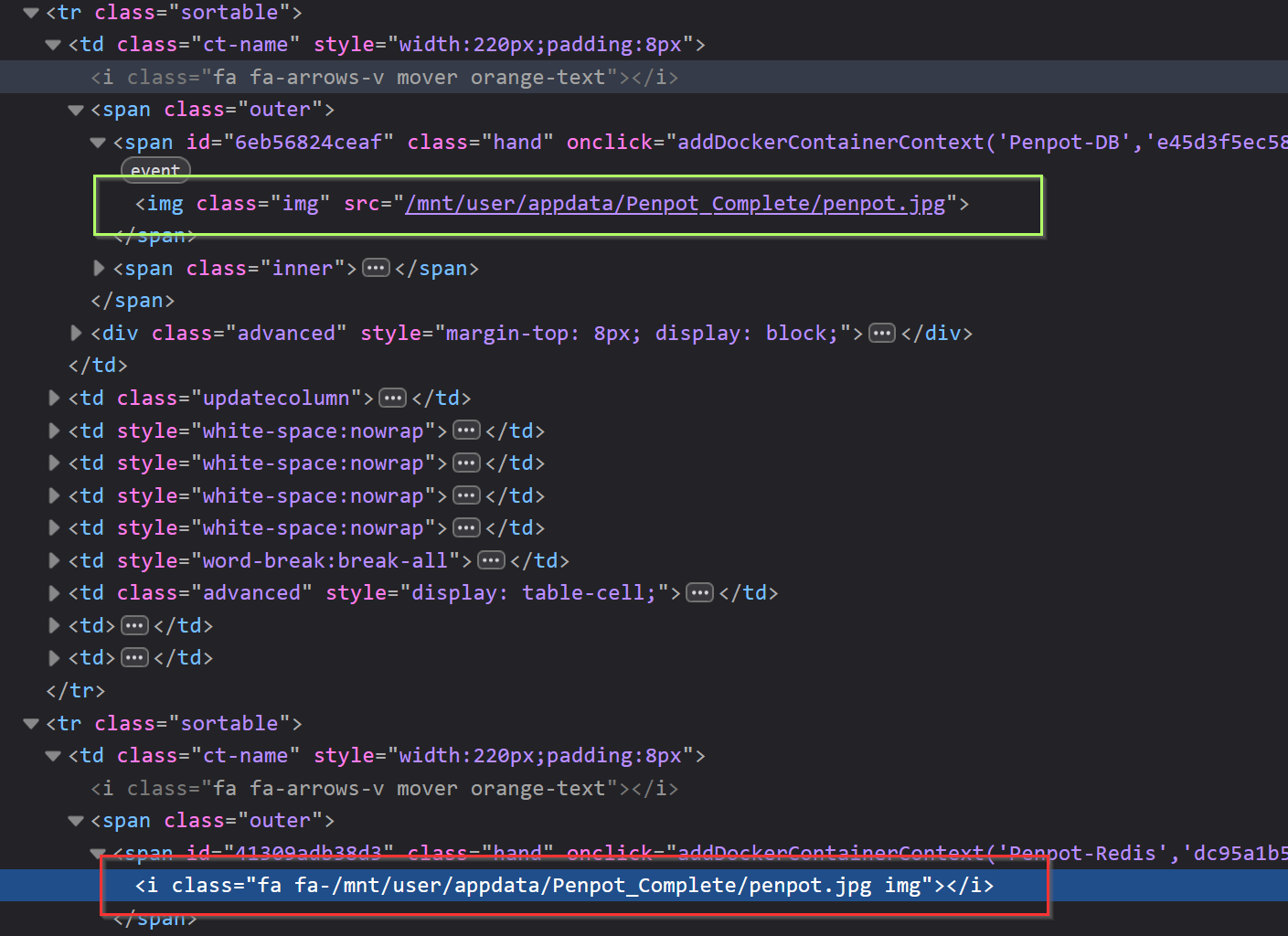

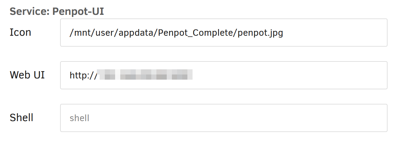

Container icons not showing due to HTML coding issue
There appears to be some coding issue somewhere, either in the Compose plugin or Unraid itself when it comes to showing icons defined in the compose plugin UI.
I have the icon, in jpg, stored in the appdata folder of the container, and I have set all the defined containers in the compose file set to use the same icon file.
No icons show in the UR docker container list.
but digging in the code shows that it's trying to.
The green highlighted span above shows the corrected code based on the working icons in the UR docker container list. The red highlighted span shows the code generated by either UR or the compose plugin. For some reason, it treats the <img> tag as a <i> tag (used for displaying fonts in italics) and applies a 'fa' class along with trying to apply another class using the icon file path and filename as the descriptor.
This problem is not a cache issue but a programmatic problem with how Compose passes the icon data to UR for rendering or how UR processes the data it is passed.
PS. On another note, some people put icons on the boot thumb drive, but I would avoid doing so as it adds more content to the thumb drive, requiring further activity on the disk.
Edited by aglyons

19 minutes ago, aglyons said:
I have the icon, in png, stored in the appdata folder of the container, and I have set all the defined containers in the compose file set to use the same icon file.
a png does not end in .jpg.
But yes, jpgs dont work as you expect. Use a real png and then it will work.
typo in the post. It is and always was a jpg file. It's saved as a jpg and entered in the icon field as a jpg.
The problem remains.
EDIT: The icons HAVE to be png? Why is that? The icons were showing up correctly in the appdata backup plugin list, just not the UR docker containers list.
Edited by aglyons
because its coded like that
$image = substr($icon,-4)=='.png' ? "<img src='$icon?".filemtime("$docroot{$info['icon']}")."' class='img' onerror=this.src='/plugins/dynamix.docker.manager/images/question.png';>" : (substr($icon,0,5)=='icon-' ? "<i class='$icon img'></i>" : "<i class='fa fa-$icon img'></i>");
https://github.com/unraid/webgui/blob/master/emhttp/plugins/dynamix.docker.manager/include/DockerContainers.php
Edited by Mainfrezzer
