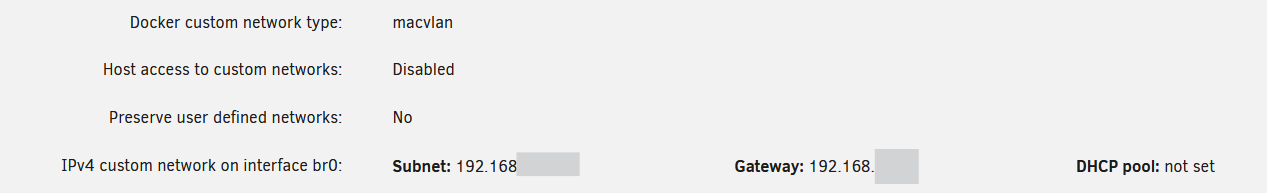

whats your docekr settings, unraid network settings... and what does a docker tempate say your network is?
network settings:
Docker settings:
Docker template settings:
as you may be using bond not br0 or, you may be using eth0

Note the name br0 that is the name of the docker network I need to call in the compose file... not enouth info to assist...
1 hour ago, kleiner-onliner said:
The error still occurs. Only when I activate/deactivate the DNS entry in the config, for example, is the container started.
On each boot Unraid creates a new br0 so it'll have a different ID. The existing container still references the old one so won't start without doing a compose down/compose up to associate the new network with the same name.
There's a trick to create your own macvlan/ipvlan network instead of using the system-provided one and to set Docker to preserve custom networks, should be somewhere in this thread.
ids don't matter I reboot all the time and don't have a issue you need to call it by the docker name...
The problem actually only occurs after restarting the Docker service. I am currently using Unraid 7.1.0-beta.2.
I have already tested it with eth0 instead of br0. I get the same error message here too. I have also tested various network and docker settings. Here is the latest version:
I don't use Docker templates because I only use my own compose files.
Creating my own macvlan seems to be the only solution, unfortunately.
But the compse file does not contain any information about an ID. It only contains the name of the network... Where is the information stored?
Within the Docker system, when the container is created Docker looks up the name you gave to find the network ID and that's what it stores as the container network. But when the service is stopped/restarted the default br0 is recreated as a new network so the ID changes.
Try turning on "Preserve user-defined networks" for a start but IIRC that's not enough.
Edited by Kilrah
Found it:
Thanks Kilrah, it works perfectly now. Thanks for the quick help and the search in the thread.

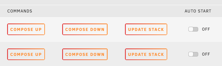

I have a woodpecker stack consisting of two containers. autostart=false, yet one of the containers - the agent - is started on unraid startup.
# cat woodpecker/autostart
false

docker confirms there was no attempt to start the server:
# docker ps --all | grep woodp
5f943419146d   .../woodpecker-agent:v3  ...  30 hours ago    Up 7 seconds (health: starting)
bf936cadc804   .../woodpecker-server:v3  ... 30 hours ago    Exited (0) 4 hours ago
Why does the plugin try to start the agent?

?Do you have the autostart toggles?
its starting as you have a policy restart always
restart: always

On 4/4/2025 at 12:23 PM, tuxbass said:
My understanding was that property is only used by docker and wouldn't be in effect unless the plugin calls `compose up -d / compose start`, which is enabled by the toggle (which I have on the compose tab like on your screenshot). Is there plugin source available to see what it's doing?
You are correct the restart:always option is for compose while the compose plugin only acts based on the value in the "autostart" file. The autostart file is updated based on the state of the autostart toggle for the stack on the compose page.
To determine if the compose plugin is responsible for starting this stack you should enable the "Debug Logging" option in the compose plugin settings. Then next time you reboot you can look in your system log for messages from the compose plugin. It should log a message for each stack it tries to start.
I run a script to down then up each of my stacks in the order I want at array start. It works great:

find /boot/config/plugins/compose.manager/projects -type f -name autostart -exec grep -l "true" {} + | while read -r autostart; do
    docker compose --project-directory "$(dirname "${autostart}")" --project-name "$(sed -E 's/[\.\s\-]/_/g' "$(basename "${autostart}")/name" || true)" up --pull always --wait
    echo "Successfully started $(sed -E 's/[\.\s\-]/_/g' "$(basename "${autostart}")/name" || true)"
done
Could run on a schedule or when array starts. Could be modified to do other things pretty easily.
