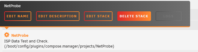

On 4/23/2025 at 6:16 PM, austin said:
you should also have the stack stopped it looks like your were trying to delete a running stack...
note the green or red icon to the right of the stack...
Click compose down and wait for the terminal screen to finish...
Then hit the gear and the delete option should pop up... note this doesn't delete the data in the folders....

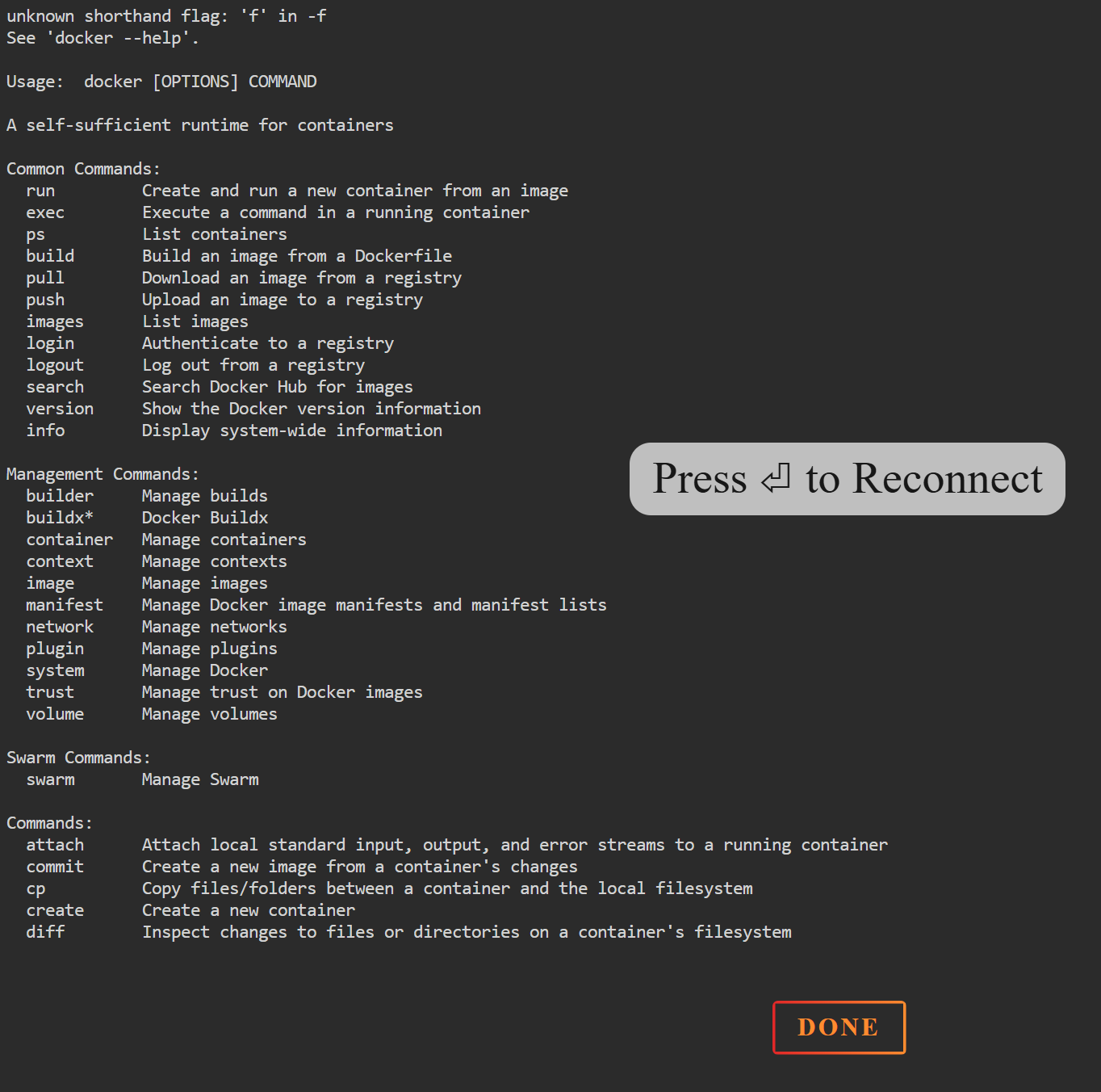

Hello! i have installed the docker compose plugin and tried to use it but as soon as i click update stack. keep getting this long message starting with unknown shorthand flag: 'f' in -f
Is there a way to fix this?
Could maybe help you if you actually posted that error message...
Probably something wrong in your stack.
On the compose manager settings page there should be an option to enable debug logging. If you enable that option then you should see the compose commands that are being run output to the log. That might provide more information for tracking down the issue.
root: ttyd -R -o -i '/var/tmp/compose_manager_action.sock' '/usr/local/emhttp/plugins/compose.manager/scripts/compose.sh' '-cupdate' '-pgrafana_monitoring' '-f/boot/config/plugins/compose.manager/projects/grafana_monitoring/docker-compose.yml' '-f/boot/config/plugins/compose.manager/projects/grafana_monitoring/docker-compose.override.yml' '--debug' > /dev/null &
root: '/usr/local/emhttp/plugins/compose.manager/scripts/compose.sh' '-cupdate' '-pgrafana_monitoring' '-f/boot/config/plugins/compose.manager/projects/grafana_monitoring/docker-compose.yml' '-f/boot/config/plugins/compose.manager/projects/grafana_monitoring/docker-compose.override.yml' '--debug'
root: /plugins/compose.manager/php/show_ttyd.php
root: docker compose   -f '/boot/config/plugins/compose.manager/projects/grafana_monitoring/docker-compose.yml' -f '/boot/config/plugins/compose.manager/projects/grafana_monitoring/docker-compose.override.yml'  -p grafana_monitoring images -q
root: docker compose   -f '/boot/config/plugins/compose.manager/projects/grafana_monitoring/docker-compose.yml' -f '/boot/config/plugins/compose.manager/projects/grafana_monitoring/docker-compose.override.yml'   -p grafana_monitoring pull
root: docker compose   -f '/boot/config/plugins/compose.manager/projects/grafana_monitoring/docker-compose.yml' -f '/boot/config/plugins/compose.manager/projects/grafana_monitoring/docker-compose.override.yml'  -p grafana_monitoring up -d --build
I am so sorry if this is not the logs you are mentioning
Edited by Gorden
I've tried it with portainer it works perfectly fine. But I really want docker compose to work I love the UI
Those commands look correct.
What version of unRAID are you running?
7.1.0-rc3
14 minutes ago, Gorden said:
7.1.0-rc3
What does the command "docker compose version" return?
I cant find it anywhere in the terminal log but when I check the project folder I see a file called version and when I check what's inside it says 1
