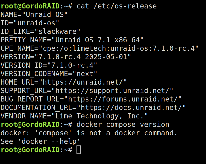

I cant find it anywhere in the terminal log but when I check the project folder I see a file called version and when I check what's inside it says 1
Ah no i meant, if you run the command "docker compose version" in terminal what does it output.

root@:~# docker compose version
docker: 'compose' is not a docker command.
See 'docker --help'
root@:~# docker-compose version
See 'docker --help'
root@:~# docker.compose version
bash: docker.compose: command not found
root@:~# plugin
Process plugin files.
image.thumb.png.bf2f1dfb7407960791fe77652a5a2921.pngI am trying to figure out what's the right command for it but not sure if the picture will say what you requested

No you got it, the first was the correct command. It looks like compose (as in the docker compose package not the compose manager plugin) is not being found. I suspect this may be an issue with this plugins compatibility with unRAID 7.1.0-rc3 (which has not been tested yet). I will try and look into this further tonight. Thanks for your help.

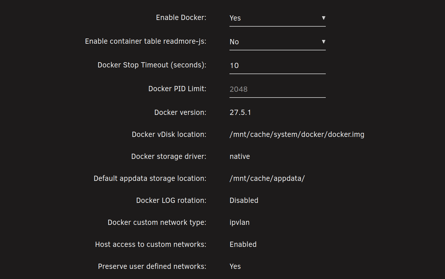

Thank you so much for your hard work. Unfortunately the issue is still there. Tried update stack, compose up... nothing. I even typed in docker compose version and still wont recognize it. docker: 'compose' is not a docker command.
Not sure if docker settings is related but does these settings seems ok?image.thumb.png.6b26a4836d73a11887b7750b8eb9f3eb.png

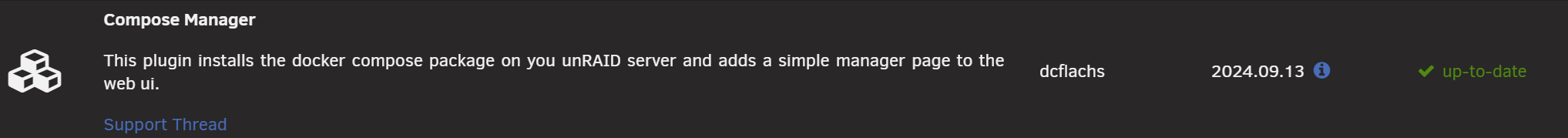

I have just updated my unraid to rc4. Still the facing the same issue! I think I am going to do a full reset on my usb because there has to be something that is messing up with my interfaceimage.png.926f5ee10ea5dd537535ab82d3ec01be.png
Did you try uninstalling/reinstalling the plugin yet?
