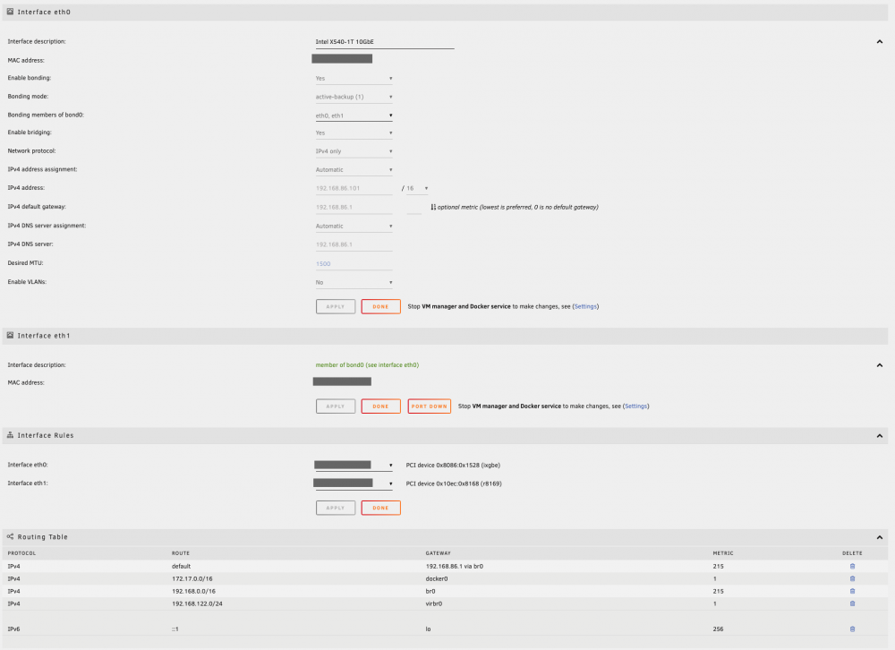

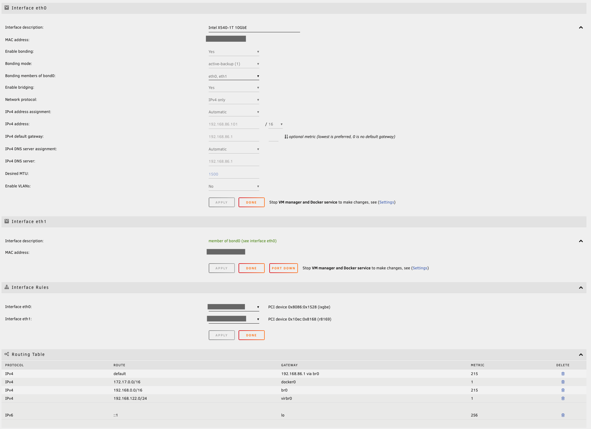

Right - good point ;)
So this diagnostics file is from the setup with 2 NICs (currently running parity building)
Intel is ETH0 - plugged in
Onboard is ETH1 - unplugged
Here is the GUI config options, nothing special as far as I can tell

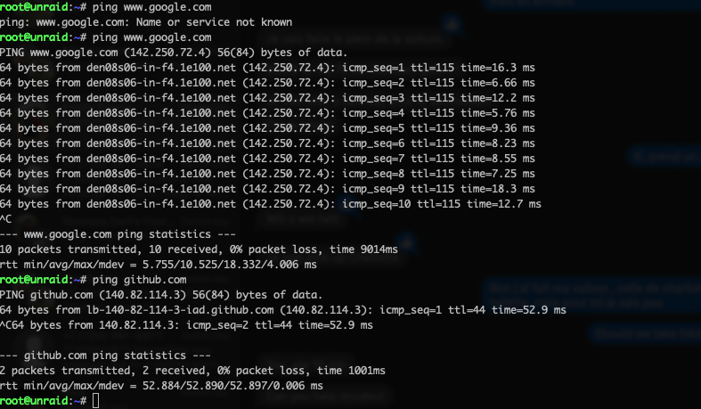

Ok the weirdest thing happened this morning...
I have changed 0 configuration settings, changed nothing on the router side either... and somehow magically, the unraid system can now ping google...
You can see below, I was sshed into unraid, I pinged www.google.com last night - nothing, and tried the command again this morning and now it works !?!

According to your diagnostics file (and the network config screenshot) you have NIC bonding enabled.  It is probably a good idea to get a single unbonded NIC working as a first step.  NIC bonding with certain NICs has been known to cause connectivity issues in the past.  No guarantee this is the problem but it won't hurt to disable bonding.
Right I can disable it, no pb.
But as I mentioned before, I tried the setup with a single NIC (in the case) and no bonding, and I had the same connectivity issues.
Ok, I have disabled bonding and bridging between ETH0 and ETH1. Here is the new diagnostic file. But so far no luck, still no connection from unraid.unraid-diagnostics-20211006-1059.zip
