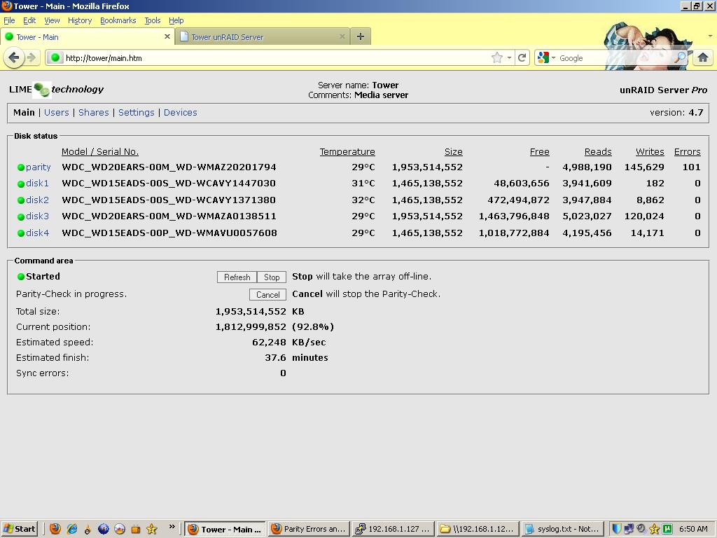

Currently I'm finishing up a monthly Parity Check and it shows 101 errors and currently 0 sync errors which I've never had before. 60minutes to go it appears

MMMmmmmmm looks like sda is having issues unless I'm misreading that syslog which happens to be my Parity drive
Still waiting for parity check to complete

1 - The smart report (assuming sda is the parity drive) shows no signs of errors on the drive.  No reallocated sectors, pending reallocations, just 1 offline uncorrectable (never caused problems before) and 5 multi-zone error rate (multi-zone error rate has been suspected of various types of drive problems, so this may be involved in this problem, but likely not IMO).
2 - It is unusual to get the error column increasing.  I don't understand why that is, becuase your log entries are not that unusual.  Maybe when it happens on parity vs a data drive the count is incremented.
3 - If unRAID is unable to read a block off any disk, its normal procedure is to read the corresponding blocks from all other disks, compute what the block should have been, and then write that block back to the original disk.  Such an event, I would think, would cause a relocated sector on the disk.  So if this happened, I do not know why we're not seeing reallocated sectors.  From a parity check perspective, though, if parity can't be read and it is computed from the other disks, it will always match the value computed from the other disks.  Hence no sync errors.

I would recommend a shutdown / poweroff (not just a reboot), and try another read-only parity check.  I might also recommend ruling out some of the common things - like bad memory, cables good, power good, etc.
