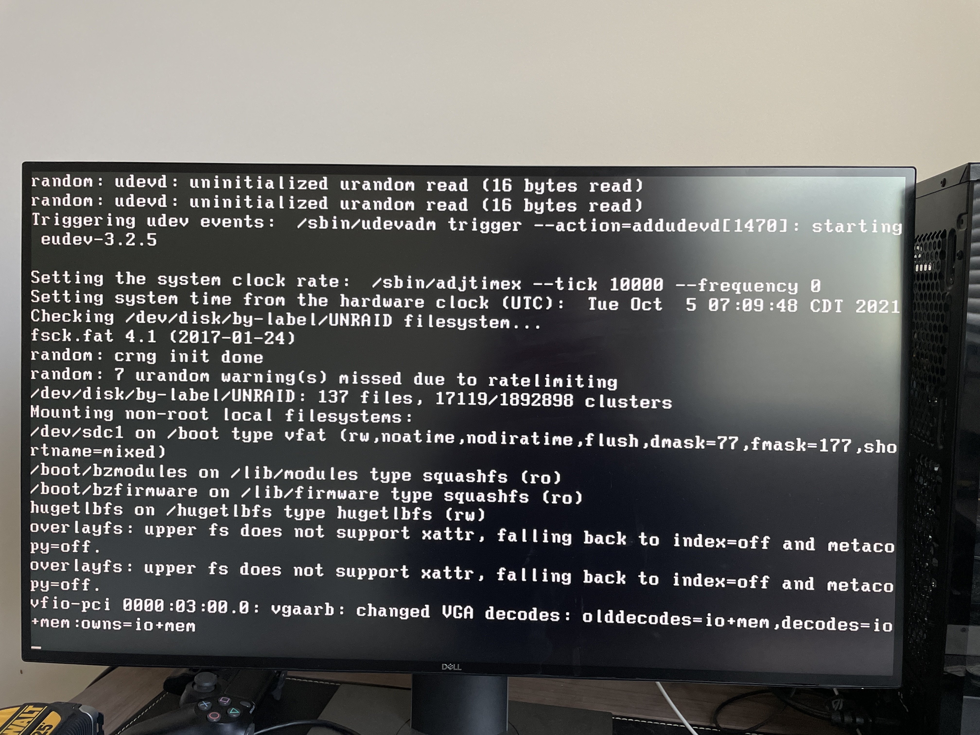

I think my main issue is that for some reason Unraid still uses my gpu when I boot it up and I don’t know why… it runs a bunch of the startup commands and then hangs with a blinking cursor at this line:
’vfio-pci 0000:03:00.0 vgaarb: changed VGA decodes: olddecodes=io+mem,decodes=io+mem:owns=io+mem, but I know the rest of the code finishes because I can remotely access the server after a few seconds. But my display is completely unresponsive once it hits that line.
if I start the windows vm it starts successfully but my screen is still frozen on the unraid boot command above and doesn’t show to vm.
