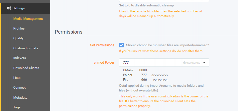

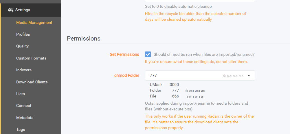

I though the sample movie I downloaded to test worked properly, until I went to delete it and couldn't. How do you fix a permissions issue like this? I know I could use the docker safe permissions tool on a case-by-case basis, but how to fix it for new files going forward?
Thank you! I hadn't seen that section.
I am confused by the golden text: "This only works if the user running Radarr is the owner of the file. It's better to ensure the download client sets the permissions properly." Isn't this making the download client set permissions properly? What does the first sentence mean?
