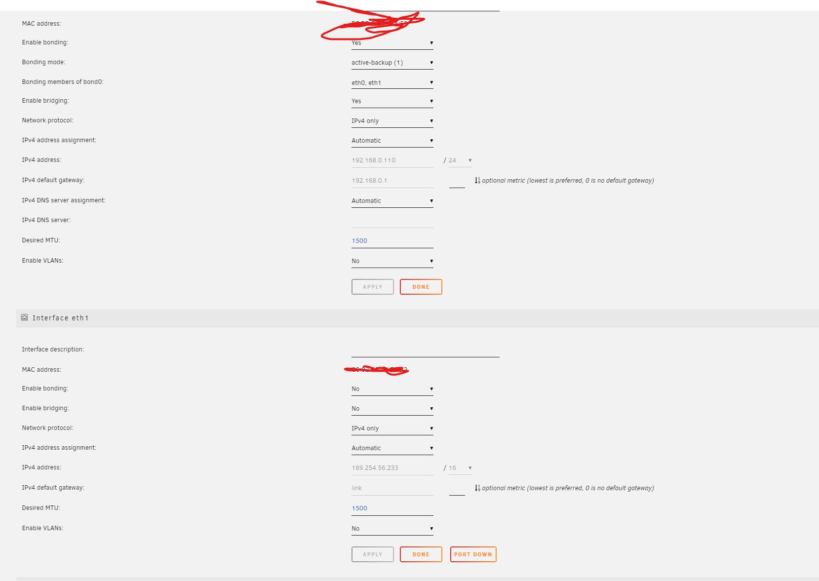

Hey Guys,
I have a 1 GB & a dual port 10GB Mellanox 2 Card.
It appears correctly in Unraid.
However when I try and get it it assign an IP it does not work. I think the Bonding and bridging is causing issues. It should be in the 192.168.0.* range but it appears as 169.254.56.233
The 1GB card works fine.
My router is a UDP Pro and the device does not appear under clients.
Here is how I have it set but its not working.

There are something abnormal in provide capture, if eth0 and eth1 were bond, eth1 shouldn't allow for setting.
Pls try delete network.cfg in config folder to reset network config and reboot.
And you said 10G NIC were dual port, does eth2 also exist.
