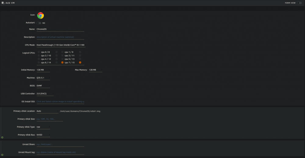

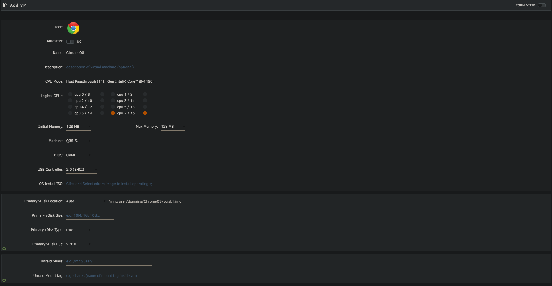

If I understood correctly, you meant to create a VM and make the VM use bluetooth, as to avoid getting the logs on unraid but keeping it contained in the VM, correct?

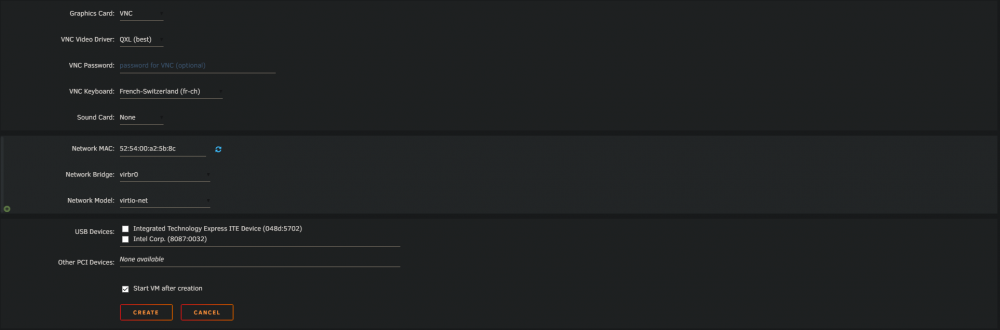

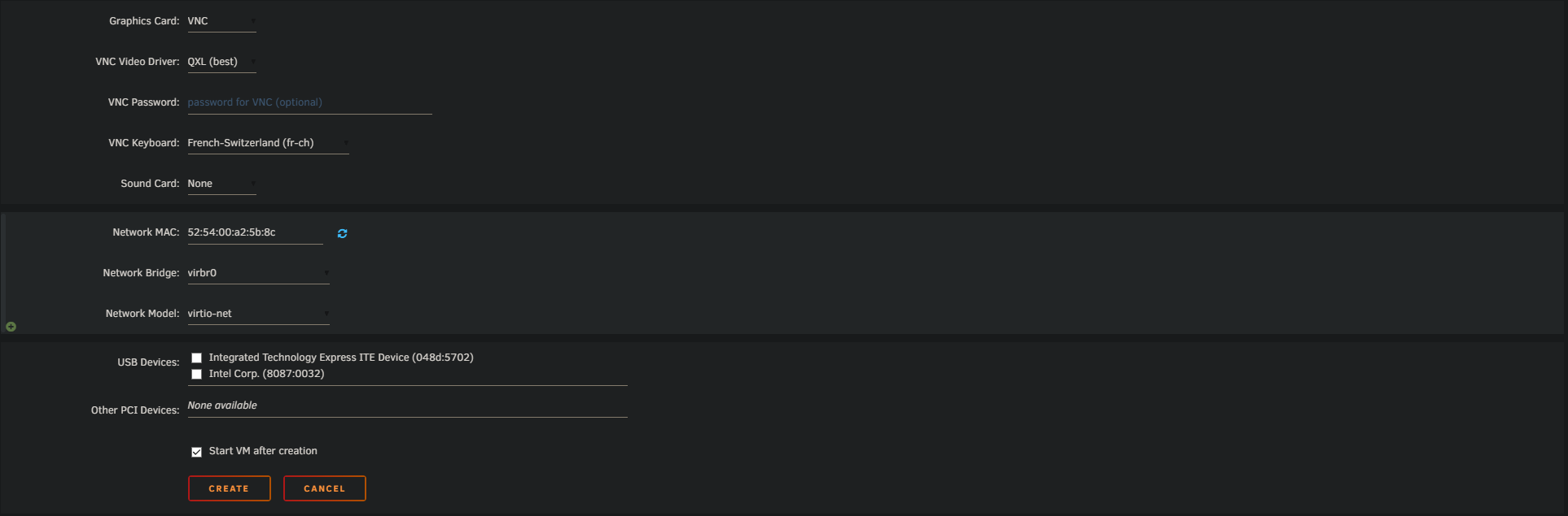

If that's the case I tried to create one, but when choosing the USB devices there is nothing mentioning bluetooth (neither anywhere else for that matter).
I send you a few print screens and also a new diagnostics to make sure that the problem persists in the same way.

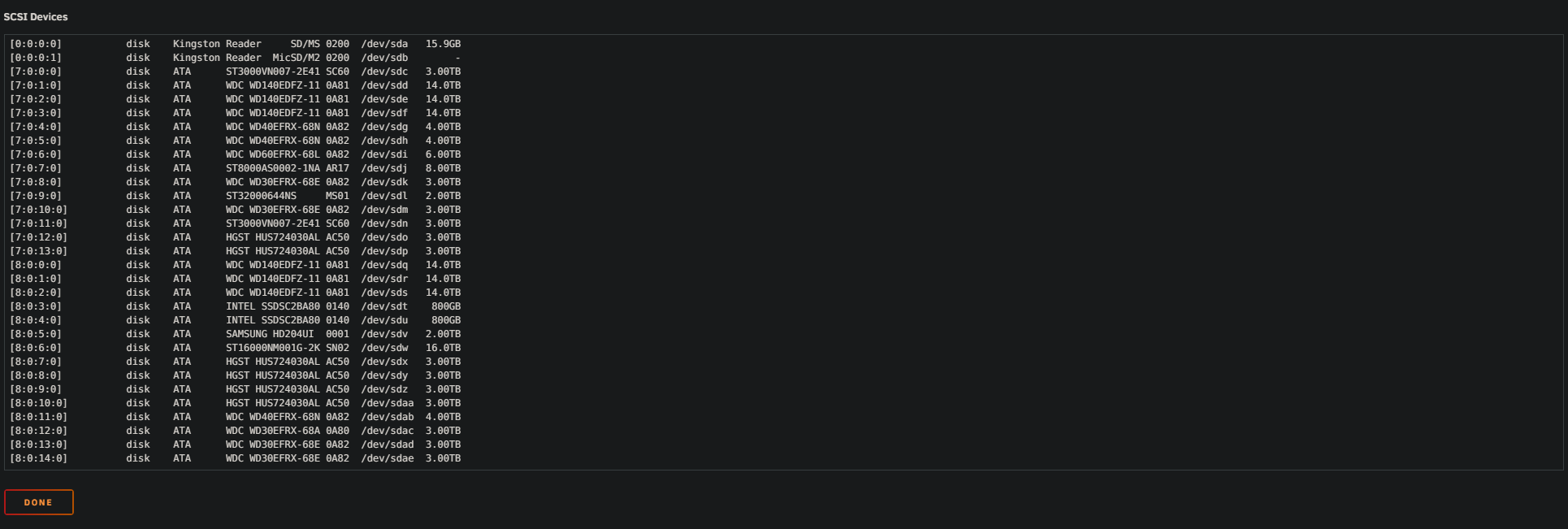

You should be able to go to Tools / System Devices and select the Bluetooth device there.

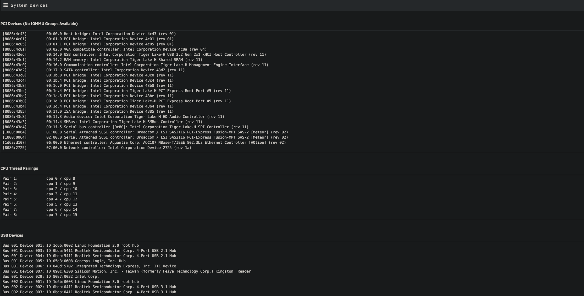

This is what I see in Tools -> System Devices:
I can seem to edit or change anything. Only to press "Done", but nothing happens.
What am I doing wrong?
Thanks.

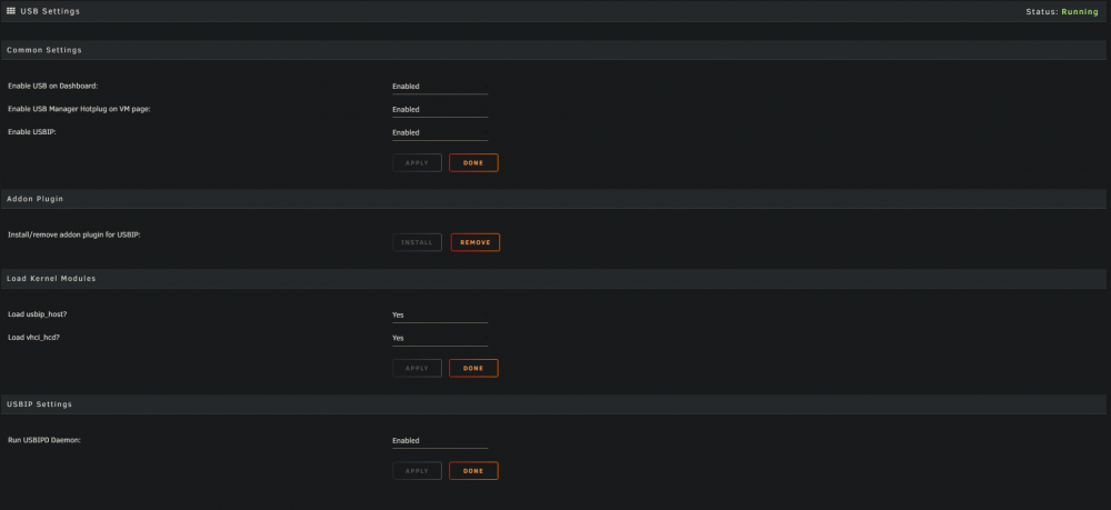

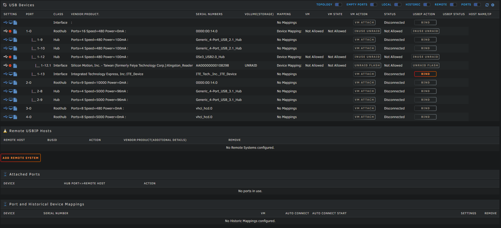

You should be able to bind the device (hide it from Unraid) with the USB manager plugin, device you need to bind is this one:

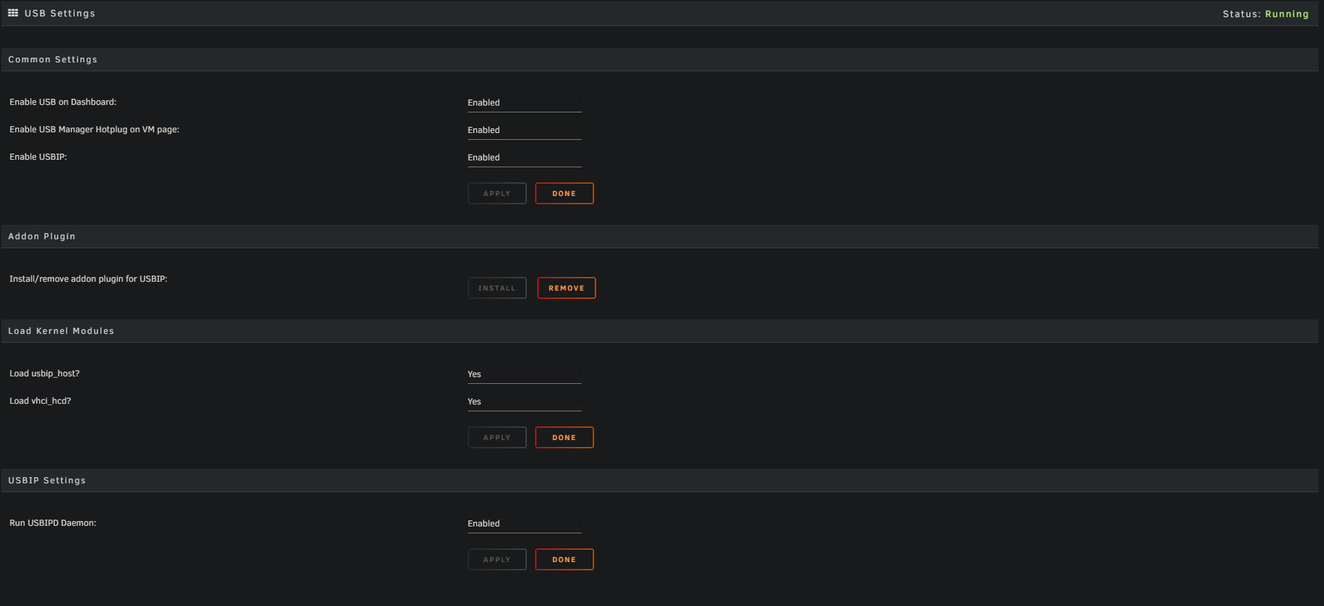

This is what my USB manager plugin config looks like:

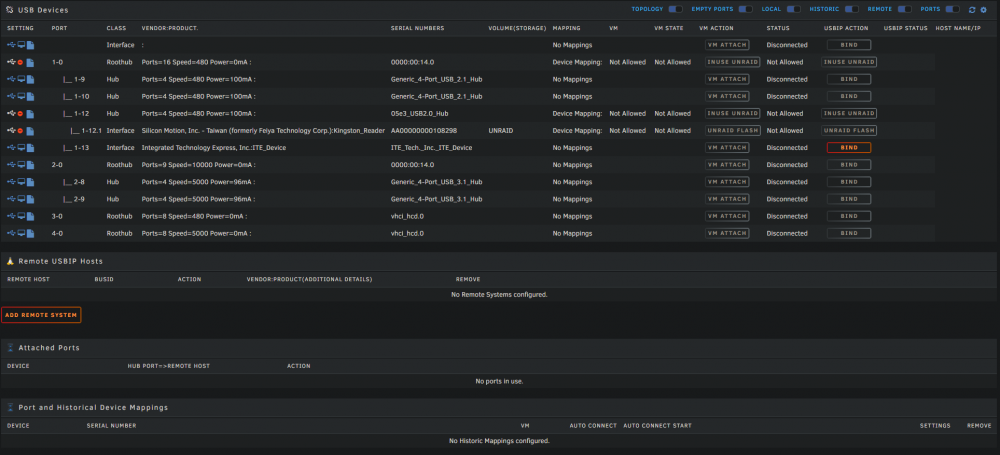

This is what I get when going to the newly created "USB" tab:

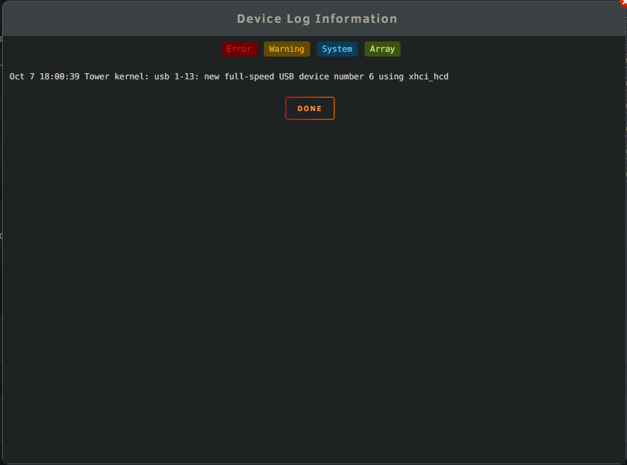

The only device that I can press "BIND" on, has the following device log information:
Is it the correct one to bind, or am I missing something?
Thank you very much for your help 🙂
