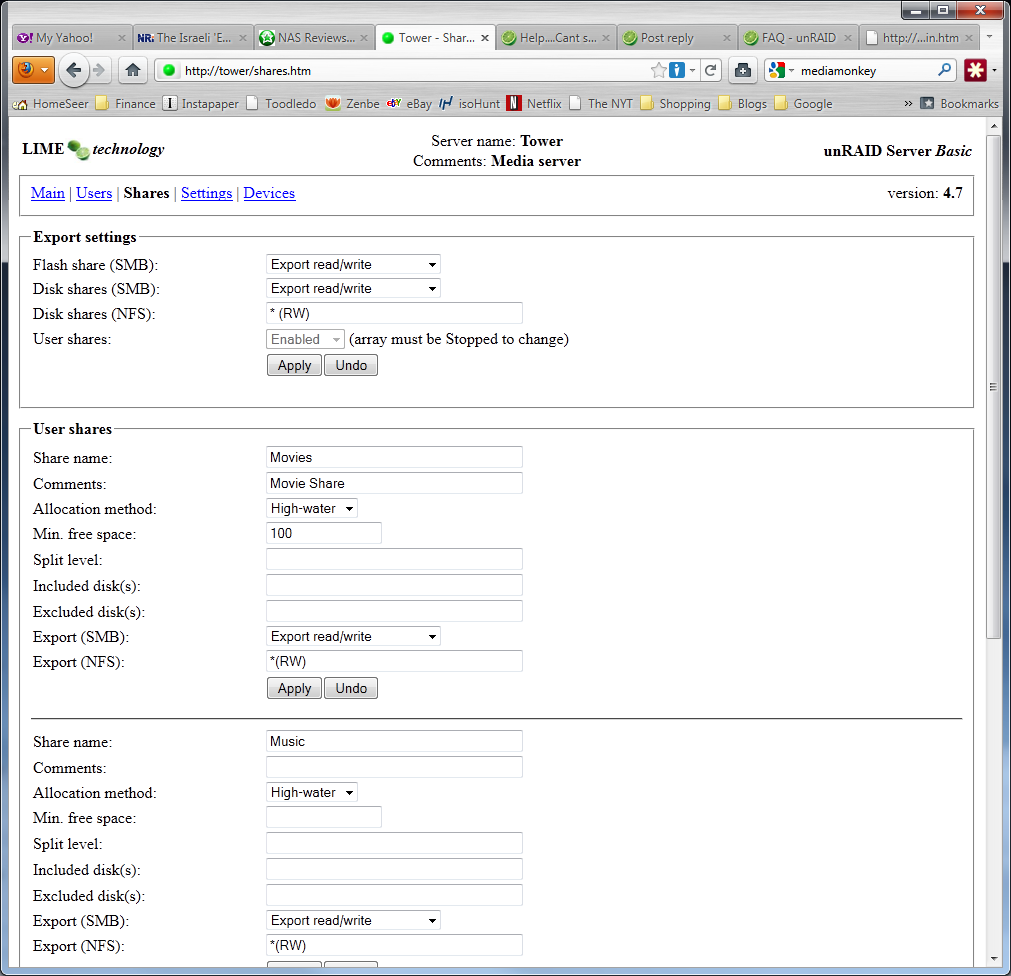

Here is the screen shot of my Shares tab.  I am assuming this is what you wanted.

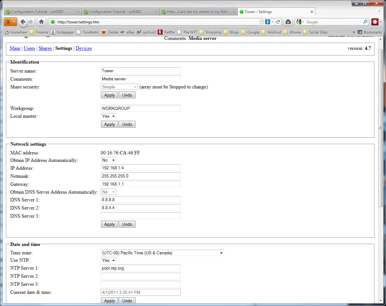

Here is settings tab

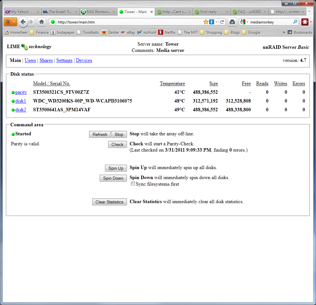

Here is the main tab

Your shares are capitalized on the share settings. Enter \\192.168.1.4/Movies not movies.
I meant \\192.168.1.4\Movies
EDIT: This \\ not this //

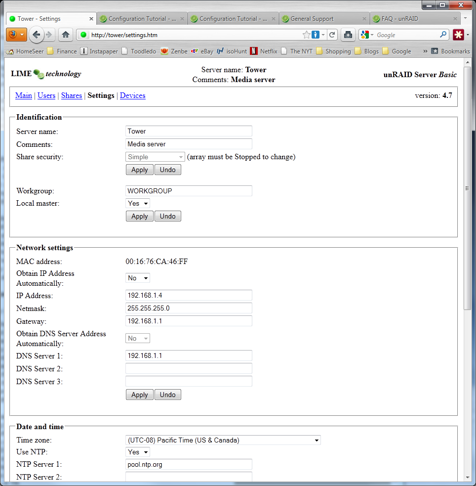

Ok I changed the DNS to my Gateway address and rebooted.  No change.
I am gathering from this discussion that normally the shares should just show up.  So again I wonder should I wipe my flash drive and start over?
Attached is the updated Settings screen after the DNS change.

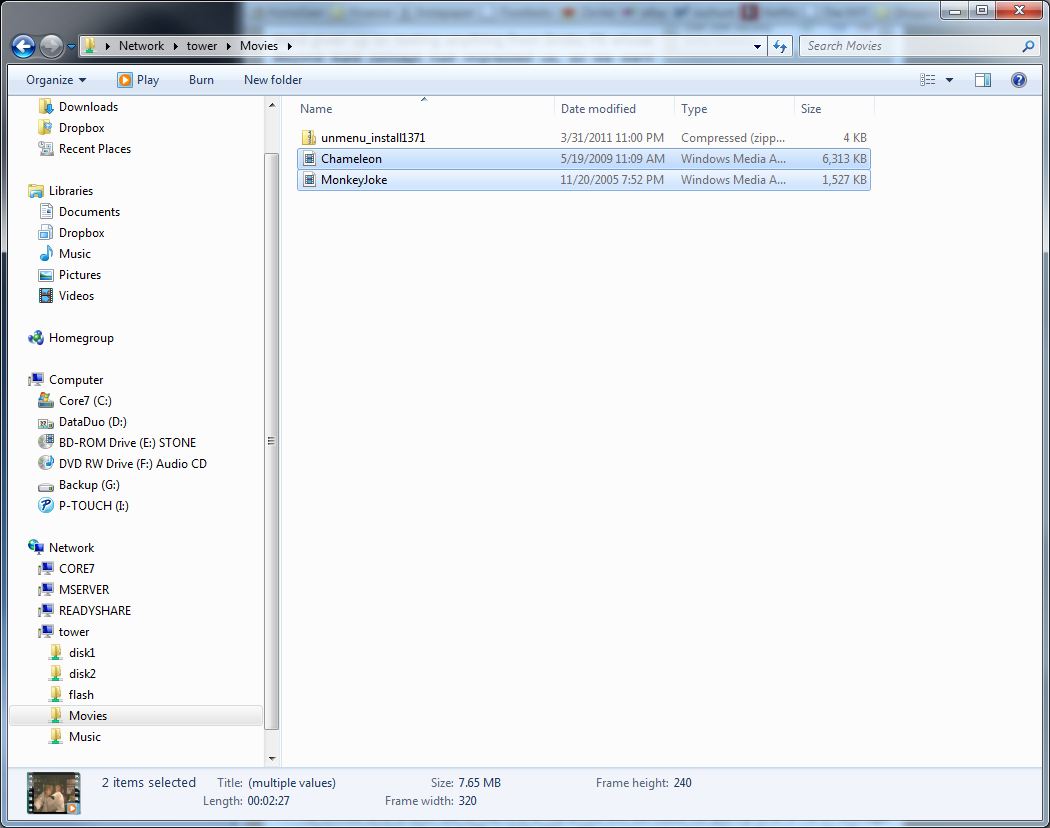

OK  I now can access a share through Win Explorer.  I copied a couple files to it to be sure.  So that is working.  As you can see I used \\tower\Movies so the name resolution appears to be fine.  So how do I get it to show up in my Network page?
