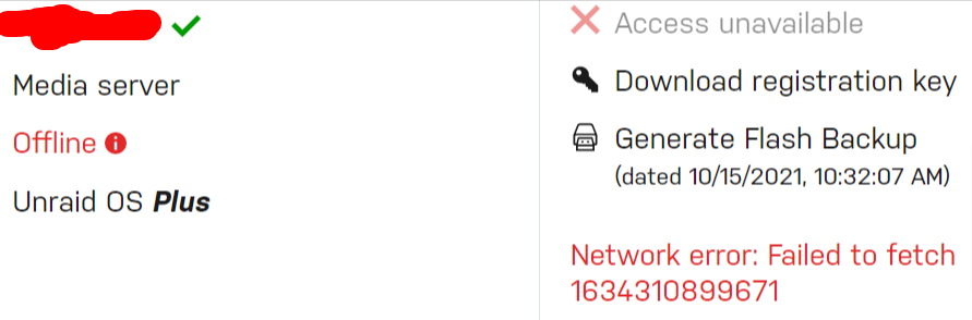

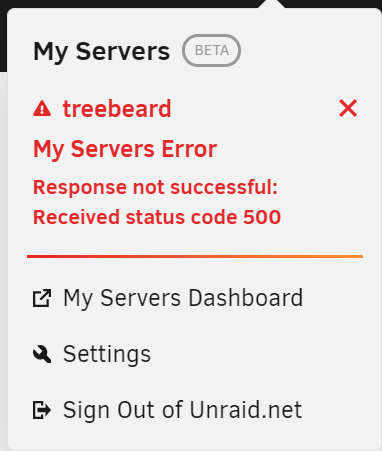

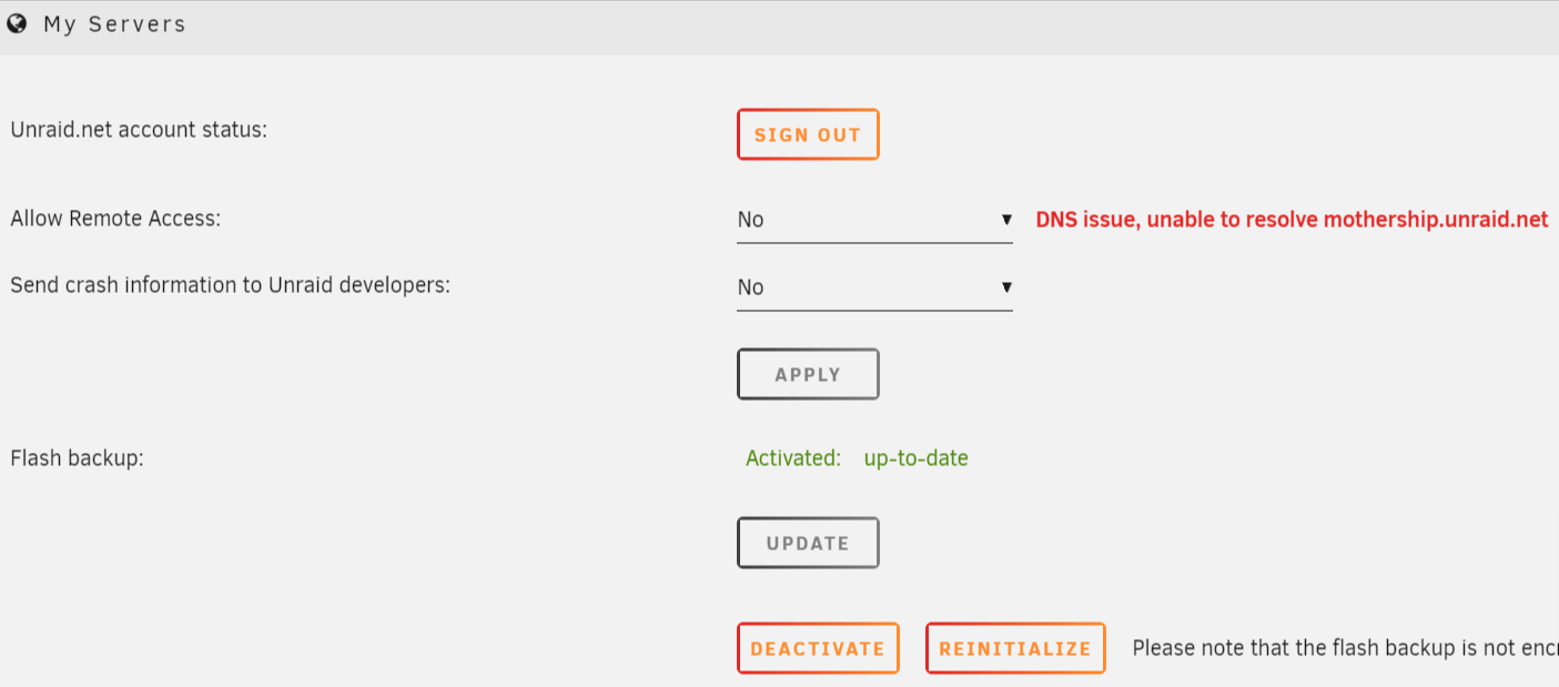

My /var/log is showing the same line described by @Patric and is repeated every minute. I do not know when it started. My log was full and I deleted the rotated files before a reboot :-$
Oct 13 07:54:30 server flash_backup: adding task: /usr/local/emhttp/plugins/dynamix.my.servers/scripts/UpdateFlashBackup.php update
Oct 13 07:55:31 server flash_backup: adding task: /usr/local/emhttp/plugins/dynamix.my.servers/scripts/UpdateFlashBackup.php update
Oct 13 07:56:31 server flash_backup: adding task: /usr/local/emhttp/plugins/dynamix.my.servers/scripts/UpdateFlashBackup.php update
Oct 13 07:57:31 server flash_backup: adding task: /usr/local/emhttp/plugins/dynamix.my.servers/scripts/UpdateFlashBackup.php update
Oct 13 07:58:31 server flash_backup: adding task: /usr/local/emhttp/plugins/dynamix.my.servers/scripts/UpdateFlashBackup.php update
As my knowledge is on par with Patric's toothpick I am also struggle to find out what to do. I see @Squid's asking to check with git. Git is used to track changes on a filesystem so when a change is made where the backup is concerned a backup is triggered - right?

It's not me asking for it.  I'm just getting the information that @ljm42 is going to want to see to help you guys out
So the issue is that something is updating a file on your flash drive continuously. Flash backup detects this and then backs up the updated file.
You need to figure out what file is being continuously updated, and ideally stop that from happening. If the continuous changes cannot be stopped, then we can tell flash backup not to backup that file.
You ran 'git log' and saw a list of recent commits. Now you need to look at those commits to see what changed. Here are commands to view some of the commits you provided from your 'git log', hopefully it is clear how to view other commits too:
  git show b986e2813ffcc6fab9ec55492ffa42df90b1bab4
  git show f19ff22f33252ec50ce13282027f3d6af351873a
  git show 51412599f8dd727162e891da42fe8e93ca8619fc
After looking at these (and potentially other) commits, can you identify the file that is being continuously updated?
I'm sorry if this was the wrong way to reference what you wrote. I did not imply anything with it. English is not my first language and I think I misunderstanding something if "asking for" is impolite somehow? Or did I totally missunderstand your comment? :-$
It was just a way of me getting ljm42 to pipe in.

It's not just all good just yet either. I see this in the My Servers tab:
And in the settings I can see this error:
mothership.unraid.net does resolve from the server. Or at least, from a VM on that server.

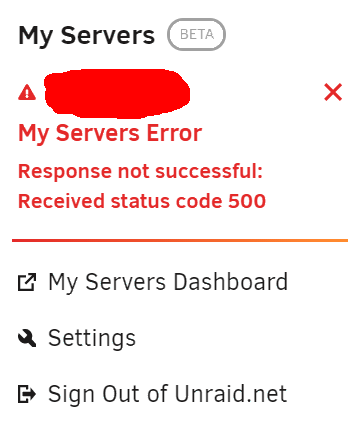

If I log in to unraid I see this status:

It did help for the MyServer page which now looks normal. I do however still have this:
On the settings page for remote access I do not longer have the red DNS warning. Instead I have a remark:
Remark: Unraid's WAN IPv4 88.91.x.x does not match your client's WAN IPv4 188.115.x.x. This may indicate a complex network that will not work with this Remote Access solution. Ignore this message if you are currently connected via Remote Access or VPN.
Both the WAN IPs listed match the WAN IP for where the server is situated and the WAN IP where I access it from and yes, I do access via WireGuard. Does that somehow explain the status code 500?
