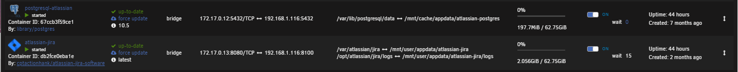

1 hour ago, corgan said:
I have to start them manually after a reboot or raid/docker service restart. Is there a solution for this?
If you just need the database up before other services, you can use the native unraid docker start ordering and start delay for this.
In advanced mode on Docker page, use the arrow hooks on far right to change ordering, just to the left you can change the wait time of that container before starting.
So in the example above, my jira database starts before jira application.
Once Jira database starts, the jira application waits 15 seconds, then starts.
Edited by tjb_altf4
Thanks, I use unraid now for years, but didn't know that there is something like the wait/delay option. :)

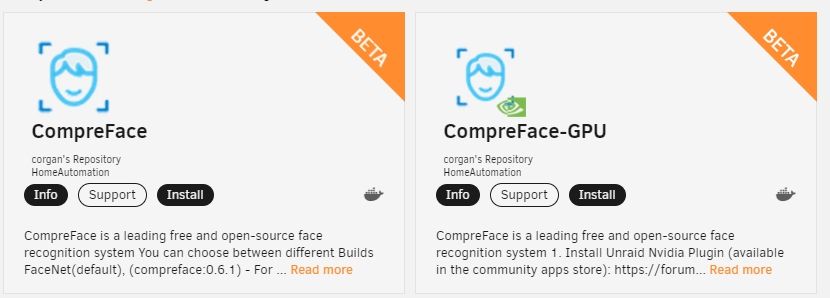

@corgan Is it crazy to add each one to the app store? As a novice user, I followed the install and it worked, but I'm scared. I don't see any appdata folder and I don't know how to manipulate ports. I don't even know what I downloaded to where when I ran the "wget" command. I'm scared.
I recently got Double-Take working with Frigate and the home-assistant.io forum thread strongly recommends CompreFace over Deepstack for facial detection.
I reached out to the developer of CompreFace and I was told that they're working on getting it to work properly with unraid. They noticed the demand for it.
Well done sir!
That's great news! I wrote an email to their support team about this some weeks ago, but never got feedback.
Did you write them on GitHub where I could track this topic?
CompreFace definitely produced the best results. Yes, for port changes and data folder, we need a proper template.
https://github.com/exadel-inc/CompreFace/issues/651
This was the link I was given that he said he would post in when he finished the work. I didn't reach out through GitHub though. I emailed them.

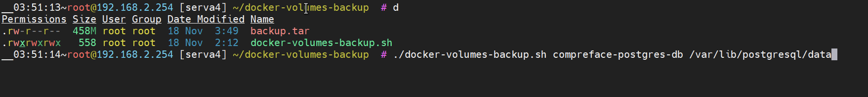

@bigbangus The DB-Data are stored on an Docker Volume. I have no idea how docker-compose on the unraid console work together with the UI Settings for folder.
But you can make a backup of the database folder and use this data later if we get a working "one-container" solution.
Login via ssh:
- create folder like backup-compreface
mkdir backup-compreface
cd backup-compreface
nano docker-volumes-backup.sh
- create backup script
#!/bin/bash
# This script allows you to backup a single volume from a container
# Data in given volume is saved in the current directory in a tar archive.
CONTAINER_NAME=$1
VOLUME_NAME=$2
usage() {
  echo "Usage: $0 [container name] [volume name]"
  exit 1
if [ -z $CONTAINER_NAME ]
then
  echo "Error: missing container name parameter."
  usage
fi
if [ -z $VOLUME_NAME ]
then
  echo "Error: missing volume name parameter."
  usage
fi
sudo docker run --rm --volumes-from $CONTAINER_NAME -v $(pwd):/backup busybox tar cvf /backup/backup.tar $VOLUME_NAME__
- backup db
chmod +x docker-volumes-backup.sh
./docker-volumes-backup.sh compreface-postgres-db /var/lib/postgresql/data
Before seeing your reply I modified the docker compose yml like below and it did the trick. Good to know your method which is probably more robust.
All I did was hash out the volumes: at the top then add "/mnt/user/appdata/<xxxx> in the volumes: in the postgres-db.
version: '3.4'
#volumes:
#  postgres-data:
services:
  compreface-postgres-db:
    image: postgres:11.5
    restart: always
    container_name: "compreface-postgres-db"
    environment:
      - POSTGRES_USER=${postgres_username}
      - POSTGRES_PASSWORD=${postgres_password}
      - POSTGRES_DB=${postgres_db}
    volumes:
      - /mnt/user/appdata/compreface/postgres:/var/lib/postgresql/data
So tempting....
But...
Any luck? Need any help beta testing this?
