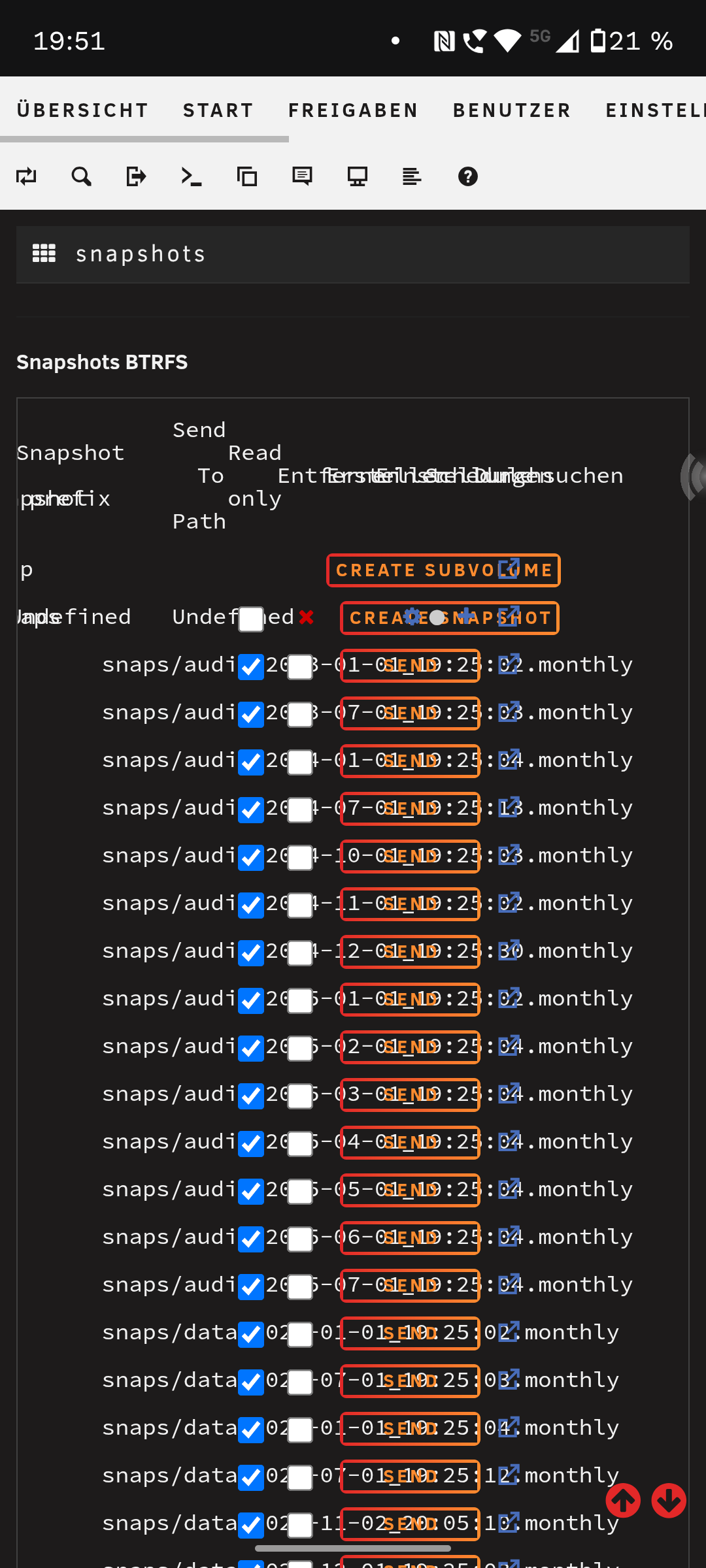

I've also noticed, that the checkboxes to show/hide docker or root volumes is gone in recent Unraid versions (because of breaking UI changes?):
image.png.4bbe319e178f7d4cfcc8391bcf07a4
Maybe the UI gets confused because of this. Anyways, I cannot maintain schedules or settings for root subvolumes anymore, it somehow tries to manage "/" instead of "/mnt/cache/" and cannot find or manipulate any configuration because of that.
E.g. if I hit settings here it wants to edit SubVolume "/" but it should be "/mnt/cache".
Besides that the scripting part that triggers snapshot creation for already existing schedules is working fine, but configuration in the UI is impossible as of now.
Hi @SimonF ,
I've created a Pull Request for the issues mentioned above on GitHub. Would be nice if you find some time to have a look at it.
8 hours ago, chli01 said:
Hi @SimonF ,
Thanks for the PR I will try and review over the weekend.

Which version of 7.2 did you test on?
I was testing on 7.2.5. Could you reproduce?
I was testing 6.12, 7.1 and 7.2 for backwards compatibilty but 7.2 did not show for me. I will try again today.
It is working on 7.3 must be the package I created was not ok. I wil test for backwards compatibilty then look to release.
Hopefully you get it working. I was just testing by replacing the installed files on the fly...
I didn't remove the existing bindings, so older Unraid version should still be fine.
Otherwise, sounds great!
I have release the update today, thanks for the PR.
Works like a charm, thanks for releasing the fix!
